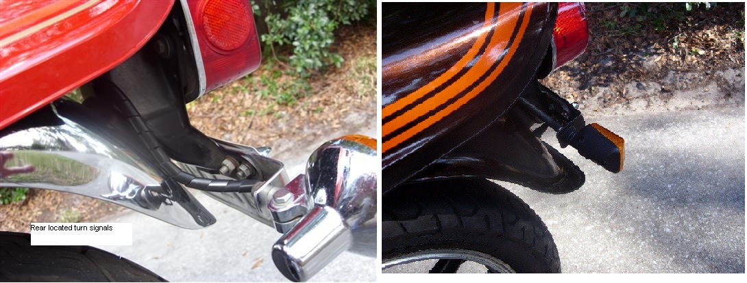

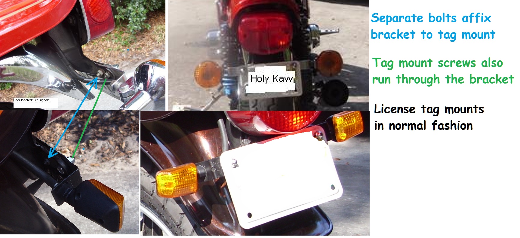

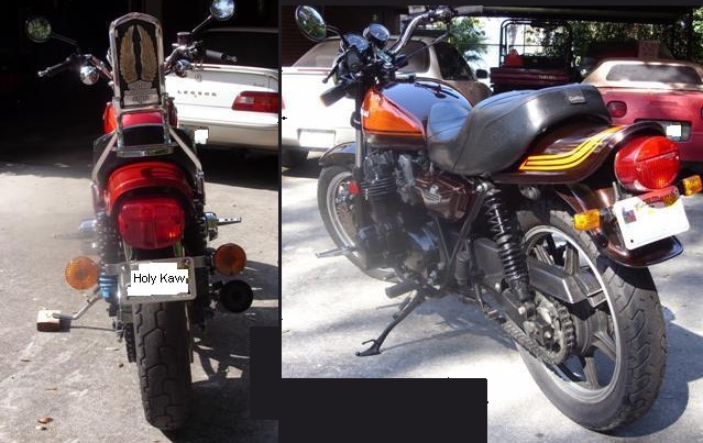

01 Apr 2011 20:58
Repositioned LTD and Z1 to a fabbed bracket under tag.
Gets signals out of the way of soft saddle bags.
And adds a bungee hook spot.
A large variety of aftermarket styles are available.

Re: turn signals
01 Apr 2011 21:29
Memory fails, but they're usually available off the wall at bike shops
Also at ebay -- search "mini turn signals" under motorcycle parts.
Some appear better quality than others, maybe even real metal.
These are relatively inexpensive (cheapo black plastic) and look similar to mine:
gengomerpyle wrote: yeah that is what i was thinking of doing. where did you buy the mini lights from?

- Posts: 18568
- Thanks: 2101
Re: turn signals
01 Apr 2011 21:551" wide stock should be okay, provided it's thick enough.gengomerpyle wrote: ...i was thinking about getting a 12 inch long piece of aluminum. the plate its 7 inches wide. i was thinking of making 2 inch bends on each end so that it leaves 8 inches to bolt to the back of the plate bracket. im just not sure how wide i should go. do you think 1 inch wide will be fine or should i go wider?
The plastic mini's are very light weight.

Re: turn signals
19 Sep 2011 23:14
Ahhh... gotta love search.
I was just thinking about this and voila here's the answer. Patton, those brackets are beautiful simplicity!
