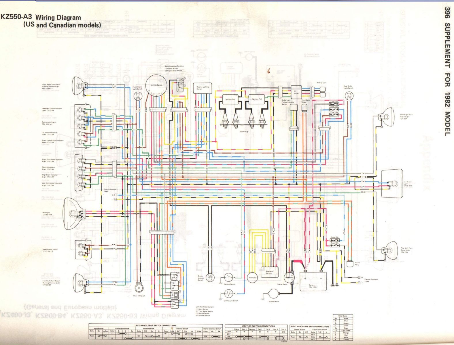

According to this crappy wiring diagram... You have a Starter Lock-out switch... Not sure on your model but some had a switch off the side kick stand that required to be in the up position as well...
