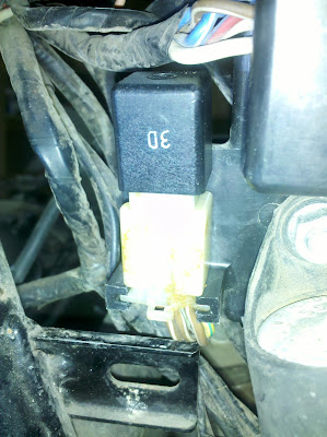

What is the little thing next to the flashers its rectangle shaped with a six pin connection and is black at the top and has what looks like a number 30 on it. Is it a fuseable link or something and what does it do or protect.

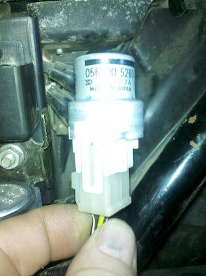

To the right of the flashers there is a black sleeve with what seems to be a realy inside, what is it for.

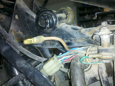

I have one brown wire unconnected right next to the coil what is this for? where should it go?.
