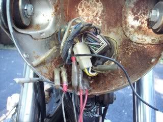

i took the headlight apart to see if everything was connected up there, and here's what it looks like inside:

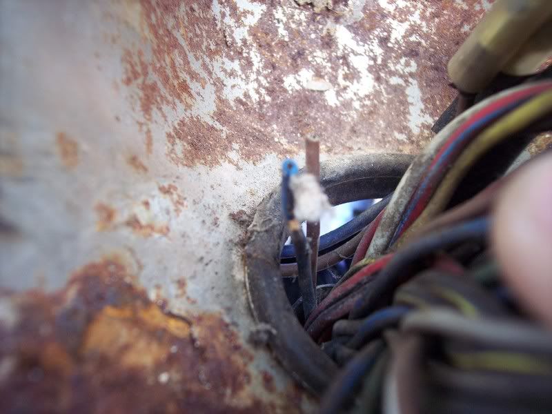

(the white and blue wire here seems to have been cut? . . .)

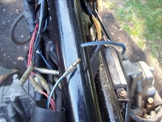

whats this guy? it looks like it says "amp"

I think you are going to need to start at the battery and work forward from there, checking voltage at all the connections and switches, it could be as simple as a bad ground, to several issues,
Its going to be a slow process.
That looks like a capacitor of some type, not sure what is for either

I had this happen to my bike once, turn the key on and nothing. It turned out to be a loose fuse in the box under the seat. It looks like you may have some other issues with the cut wires though.

A new harness (or a good used one) will be the best way to figure this out. Try the motorcycle salvage yards and another place to try is at these websites:
