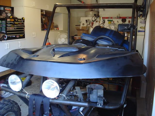

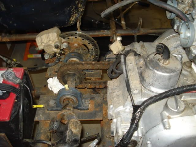

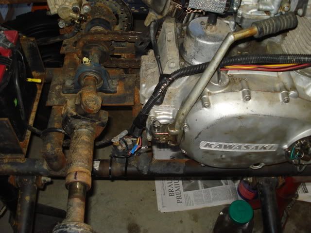

thanks...
i'll get some pics up, but all i have of the bike is the motor. the motor is actually in an off road kart/buggy.
by IE, would you mean Electronic Ignition? if so, what, exactly do i need? new coil, advancer, pick ups? cdi box? confused, as my motorcycle knowledge is of 2 stroke dirt bikes, just getting into thumpers...

Well put up a pic of the buggyB)thanks...
