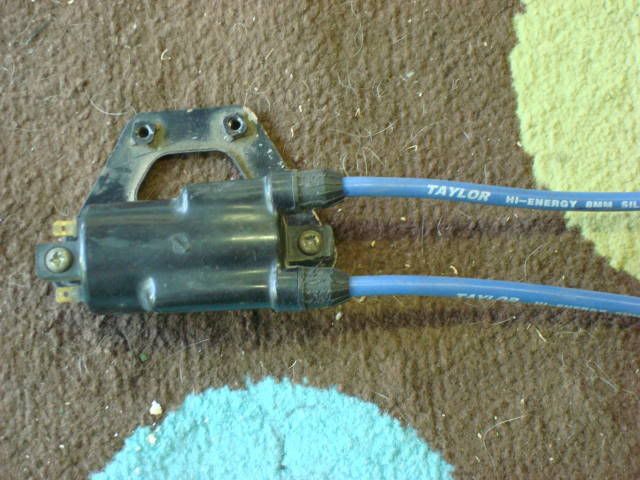

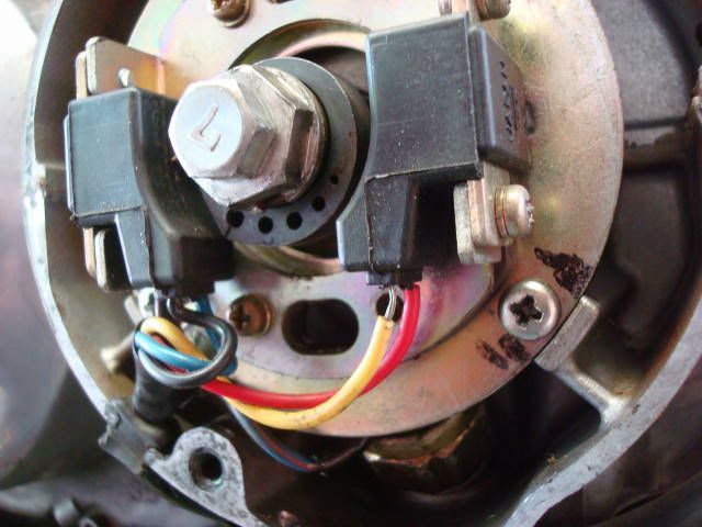

Ok so here are a few pics of what I have! The coil with the upgraded wires, and the ign. Note the yellow wire leading to the 2-3 pickup and how it is exposed. I did put a know to be good coil, good wires and good heads on the wires setup on and the bike still has the same problem. HELP

Voltage at the coil seems okay.
Am thinking no problem due only to yellow wire
exposure, because no obvious short appears.
Because the same problem continues on #2/3 after
testing with another known good coil, good wires
and good leads, am thinking any ignition fault
lies elsewhere besides in the #2/3 coil and
elsewhere besides within the #2/3 secondary
(high tension) loop.
The sporatic timing light test on #2/3 casts
suspicion toward the righthand side pick-up,
or possibly an intermittent short or frayed
internal wire somewhere between the
pick-up > igniter > coil.
Would double-check integrity of wiring
and connections in areas between
Am thinking both the righthand side pick-up
and igniter are probably okay, because there're
both working fine over 3000 rpm. Could re-test
after installing another known good igniter.
But would first check the connectors
in wiring to and from the existing igniter,
making sure they are clean and tight.
But for the sporatic timing light test on #2/3,
would usually think "clogged carb pilot circuit"
where performance comes on strong after bogging
below 3000 rpm.
Do #2/3 plugs have a good quality spark when
viewed outside the cylinderhead?
What about compared to spark on #1/4 plugs?
Btw, did the problem present itself suddenly
or more gradually develop?
Good Luck!
