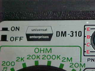

Um... yes, I have a 3 of the Tyco ones, and a digital multimeter... but I don't know how to do what you're asking...
:blush:
If you can tell me what to do, I'll do it...
:blush:

Set the meter to resistance, and put the leads on the coil terminals of the relay while it is unconnected. That's pins 85 and 86. It doesn't matter which lead goes to which terminal. Then read the ohms on the meter. I expect between 100 and 200, but just want to be sure.

Okay, *if* I understand, I set my multimeter to "200" in the OHM section, and on the three relays I have next to me (not on the bike), they say 84.1, 84.5, 84.8.
