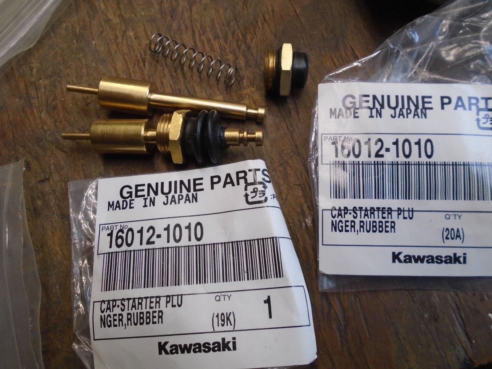

As Zed mentioned, not significant on those Choke bellow seals but the hole in venturi is going to vacuum from the easiest source. So if that skinny brass protruding tube is plugged then it's going to just pull air from around the clearance of choke plunger and it's bore. Make sure the "jets" in each bowl are clear! Bowl IS part of the choke system. Was farting around looking for a source for these and ended up on Z-Powers site and somehow they had gotten this photo I added from a previous discussion of similar a while back. They have 4 photos posted and one is
mine haha.
