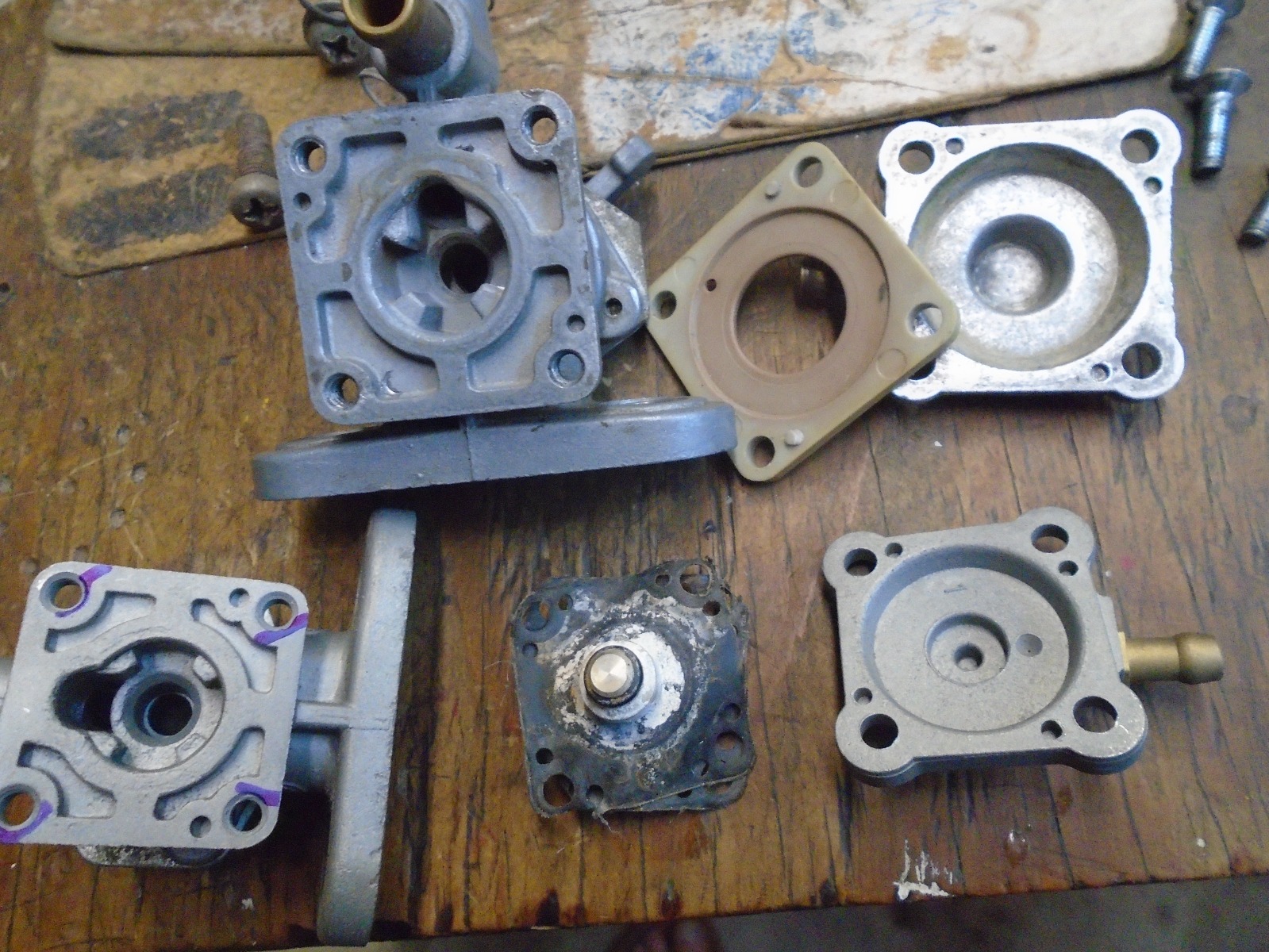

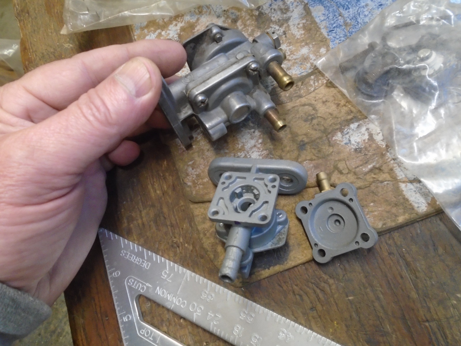

More relevant stuff. Gotta ask, why the rebuild initially? Beyond that did you install the "wafer" correctly? One side is dished, other flat. Also, those wafers that separate petrol from vacuum diaphragms, have locating tits. Diaphragms are often oriented where only 1 of the 4 positions are correct. Are you sure it's weeping from the casting halves or just drizzling down from tank connection? Something noteworthy too, those petcock casting can warp. See last photo where blue pointer against a flat surface is, this one shown is bowed/warped. This will allow vacuum and petrol loss. Also verify the diaphragm aluminum protrusion cannot be turned within the two rubbers. Sometimes they are not crimped correctly, i do a lot of chainsaws, same principal. I'd quit rebuilding these petcocks unless absolutely necessary because of rarity. Often, which you've not gotten there yet but those aftermarket kits' protrusion with oring don't sit perpendicular to the beveled oring seat TexasKZ was talking about. Maybe this crap will help??

Watched the Video You Utube star!! You have a couple issues. One is the obvious weeping and spitting. This is because the main body is warped or the plastic plate is too, or cracked. That little cut-out states it all, no correct sealing. The other is "why" would it sporadically be spitting to begin with? That is because the "check pad or ball" isn't sealing under pressure when your cylinder spits back. those check valves or reducing jets are built into All these Vacuum petcocks, just have to know where to look.
Don't waste anymore time and just purchase a New one. Or machine flat the main casting and double check the plastic wafer. Pick your battles wisely..

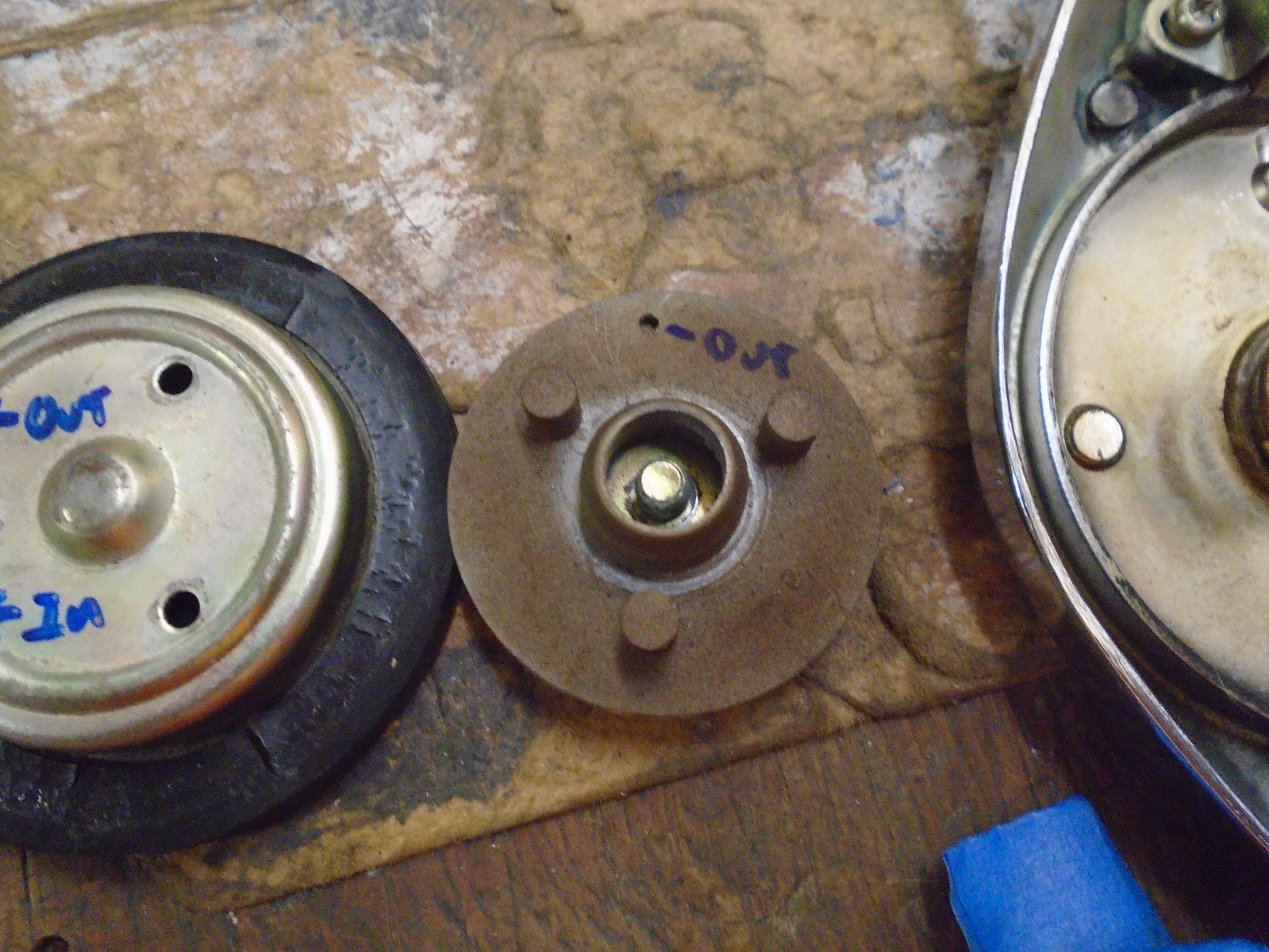

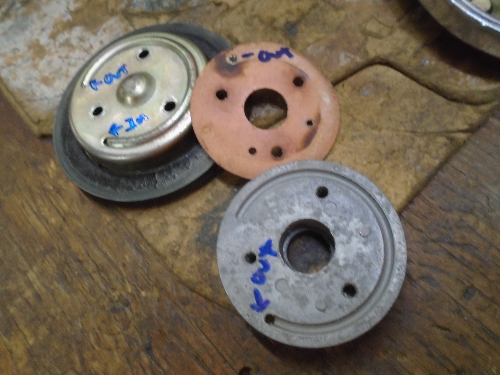

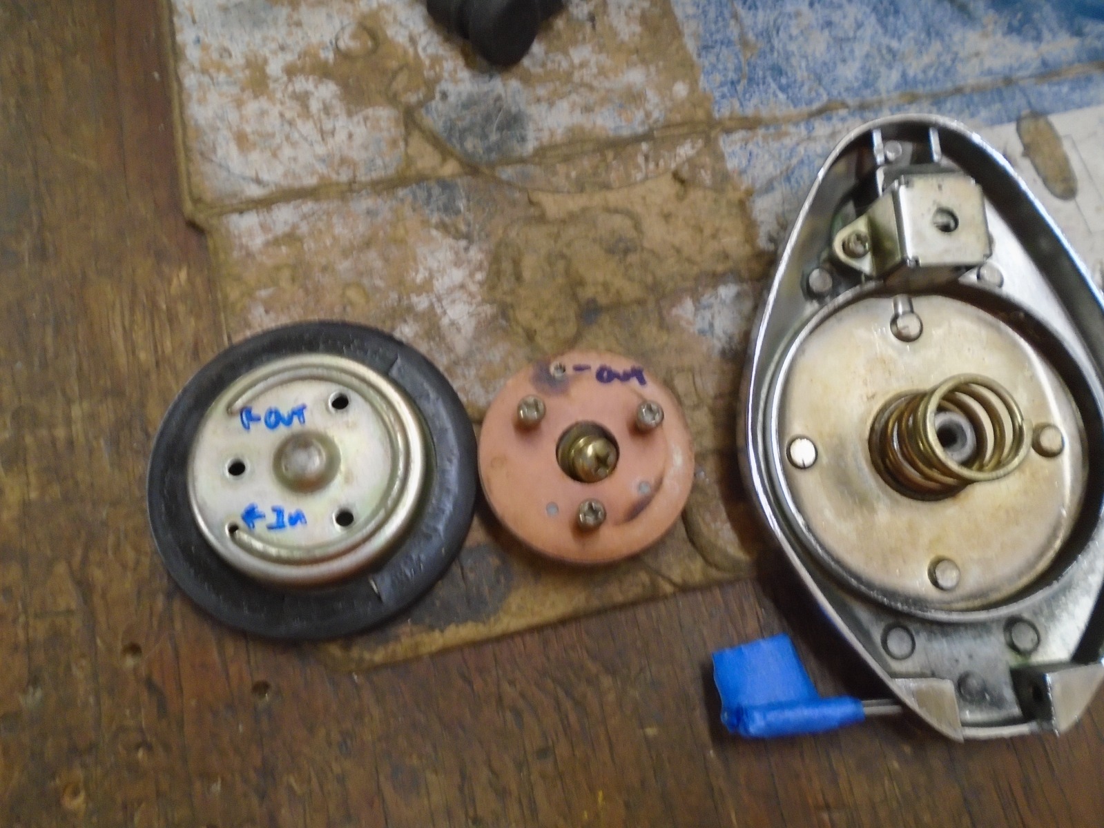

20 Nov 2025 18:06Well I believe it is capable of both positive and negative pressures. I understand why it could be negative, as the fuel draws out of the tank the void needs to be filled with air. However in this instance, the fuel filler cap started hissing before I even got the tank on the bike. I had just bolted the fuel tap to the tank and as I was moving the tank around to get it over to the bike, the gas was sloshing around inside and the cap started hissing. I'm assuming the fuel somehow made a reaction that created pressure.Just an FYI - vent issues will cause a "vacuum" in the tank not "pressure" the hissing you are hearing is suction. Therefore there is no pressure being applied at the petcock (the opposite in fact)Hello all,
I just rebuilt my petcock with a K+L brand rebuild kit and it’s leaking fuel from the diaphragm area pretty bad. Took it back off and double checked my work using the service manual and it’s still doing it.
the fuel filler cap is hissing too, so it would seem the vent may be slightly obstructed and causing pressure in the tank. Is it possible the vent issue is causing the petcock leak by pressurizing the diaphragm? 1982 Spectre 1100. Thank you!
Also when it's hissing and I open the fuel filler cap it pops the cap open and spits a little gas out. I don't know how it's happening but it seems to be positive pressure.
It really is a letdown that they don't sell individual parts for the fuel filler cap other than the main gasket. I found the layered piece with slightly swollen fiber gaskets inside the cap. I believe the swelling could be slightly encroaching into the vent channel, it's the only theory I've got. But I can spray carb cleaner through the holes and it passes right through. I would have liked to try another part in there but it looks like the entire cap getting replaced is the only option. Looking at it, there isn't really anything wrong with the fuel filler cap. Is it possible it's working as designed and it just vents slowly? Does it somehow work in tandem with the fuel tap?
Has anyone had any luck with the eBay stuff?

You are experiencing a common issue with noted complications you're encountering. An easy fix for the CAP. There are NO check valving, just a super simple labyrinth of galleys to provide IN and OUT pressure equalization. Your galleys are "somewhere" plugged. A few pictures to make all the woes go away. That one singular gasket is easily made and i believe offered if you don't/can't make it. It does have a couple holes punched into it for a specific location orientation though. Simple shite..
