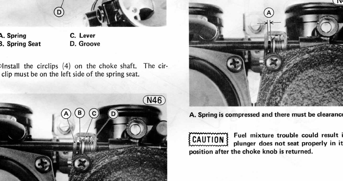

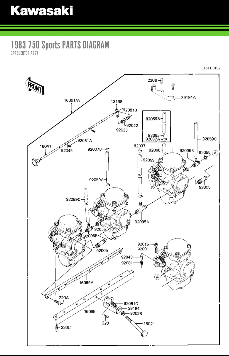

Re-assembling my 1983 KZ750 L3 carbs and could reallly use a photo or diagram of how the choke rod and choke assemblies go together ... does one exist? The PDF of the manual I have does not, and Partzila's "fiche" is not helpful.

Did you manage to save the small balls and springs for the choke rod? They are often lost by people that don't realize they are in there.

Ditto Ed's comment! They are in #2 and #3 carbs where rod passes thru. Without them all the Choke Plungers will always "sorta" be ON. Don't know if Your 750 plungers have a spring per assy?

We lost one but upon reassembly it works fine. They stay closed.

Speaking of rotting ethanol fuel, did you replace all the various O-rings?
Honestly, the CV carbs of the era, both the Keihin CV34 and Mikuni BS34, run really nicely. Biggest problem, and it's fairly rare, is torn diaphragms. Everything else is relatively easy to fix.
Regarding missing one of the choke spring detent assemblies, I'd be concern it will open due to vibration. A ball should be easy to match up at a good auto parts store. The spring would be more challenging, but should be doable.
