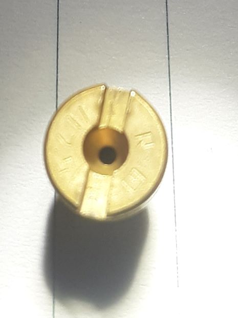

Looks to me like the jet is not the same size all the way through...
Guess I should have used the term "internal geometry" , not the general terms contour or shape!

The video clearly mentions drilling the pilot jets to enlarge them, and eliminate lean running from stock.
To me, instead of drilling, just install the next size jet. Simple and fast. Not needed, mind you, but to each their own.
Regarding poor cold starting, that could be many things. I always like to start out with surgically clean carbs, with fresh O-rings when ever starting a bike rehab project. Could well be the choke passages are plugged in one or more of the carbs. If jets are needed, buy Mikuni brand, as first choice.

Yeh I haven’t did anything yet. I haven’t even taken them off yet because I just put them back on 2 weeks ago after cleaning them thoroughly. I even drilled the caps off the mixture screw to get to them. Bike ran great for two weeks and then went down hill. I should have probably cleaned the tank out @ the same time so I think that the problem lies there but while I’m going back in I was contemplating measuring the pilot jet because I can barely see through the hole with looking into direct sunlight from the garage door being opened and compressed air does go through and ALL passages are open even the passages by the bowl and going into bowl. I compress every passages and all were free and clear.
I am going to order a choke plunger kit and seal that Zed1035 mentioned waiting on cam plugs from Norway coming in on 7/7/25 have complete gasket set going to use the valve cover gasket out of it. Thanks everyone
