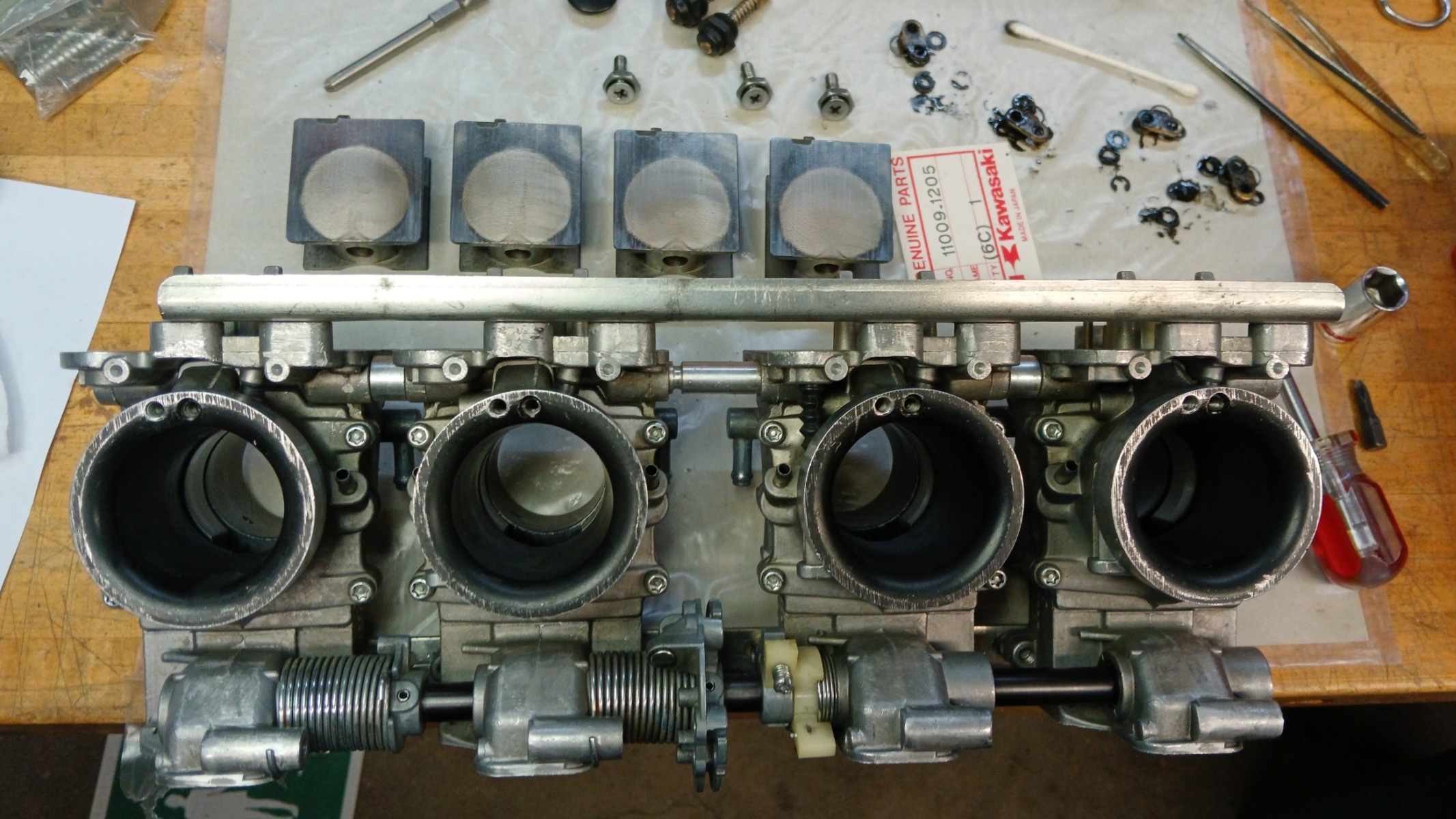

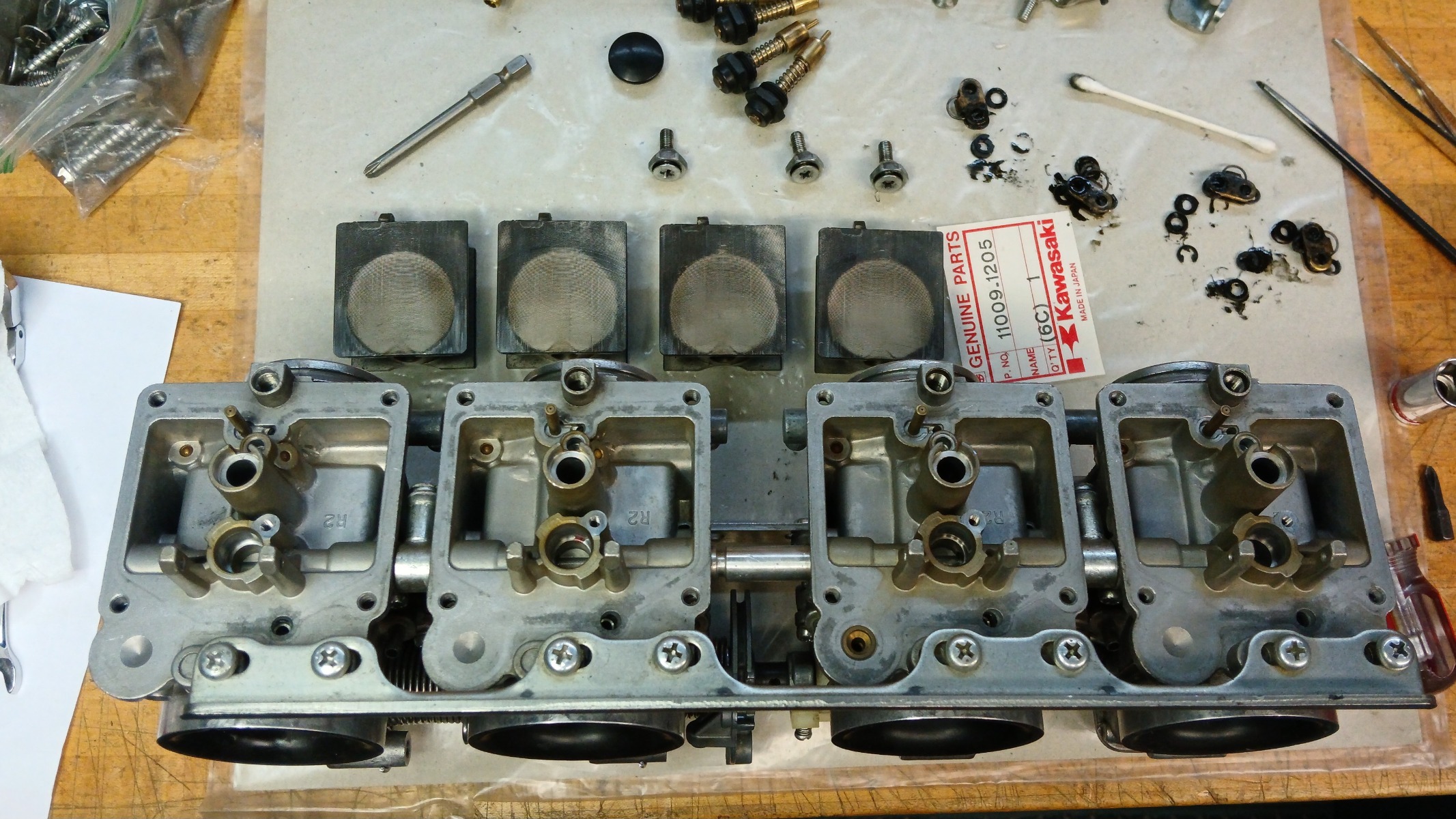

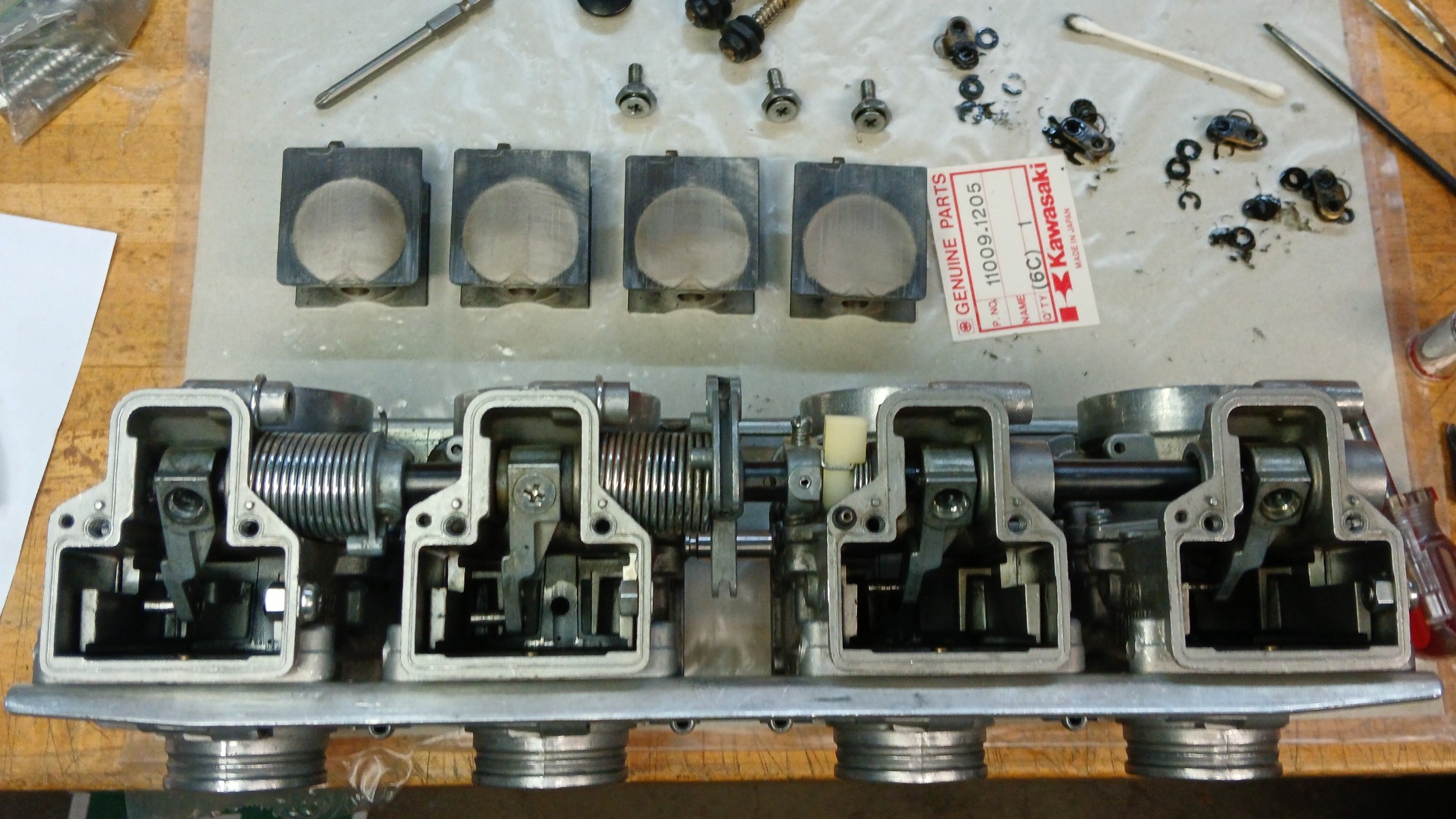

Had this RS34 rack assembly (and bowls) done professionally after the jets, slides, etc. were removed. The misc. loose parts I cleaned by hand.
Before Images:

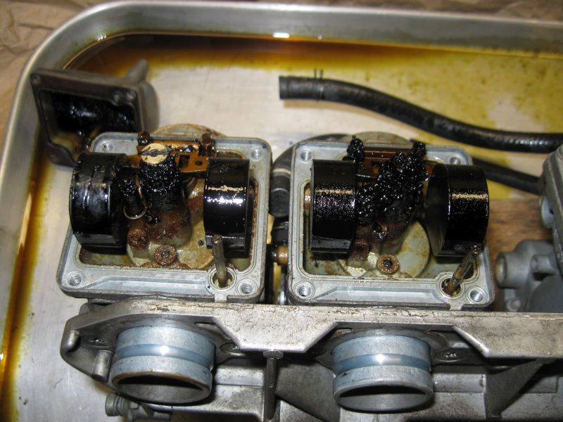

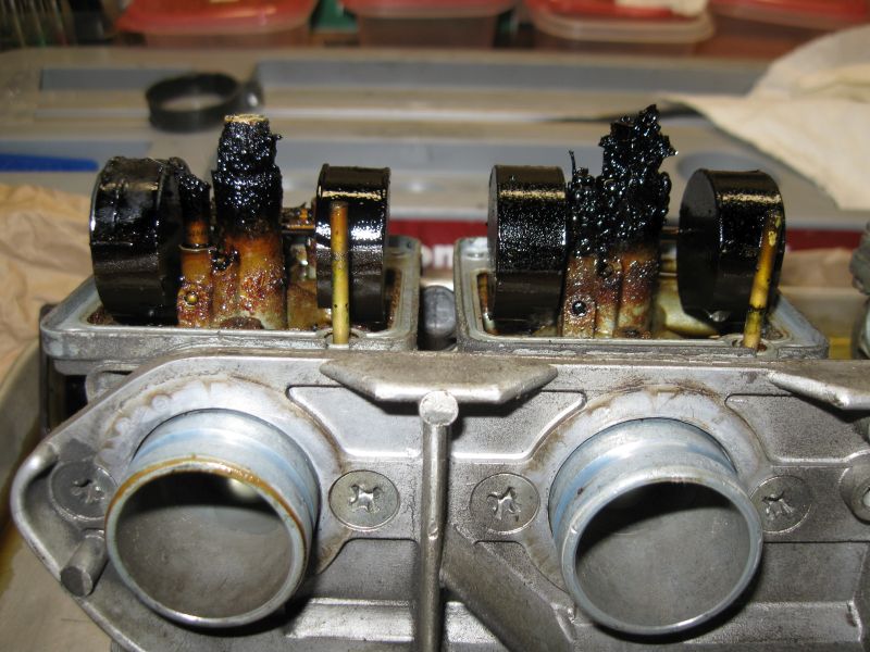

Careful, active ultrasonic cleaning in (NLA) Yamaha Carb Dip Cleaner enabled us to make this:
Into this:
No other passive cleaning process came close, regardless of chemistry used.
