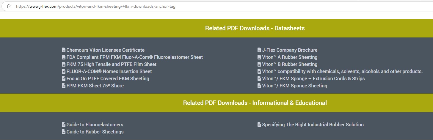

31 May 2025 07:42Hey Guy, you English blokes must love Viton, because the sheet I'm using came from there! Just waiting for someone on ebay to offer some 2mm grade B sheet. Ordering from an industrial supply store, half a planet away, sounds expensive!Don't know how bad you want this stuff Ed, below is details of a UK supplier that lists itÂNessism post=913089 userid=14026What about the diameter of the plunger? Are these "raised lip" plungers the same diameter as the regular BS34 plungers? Â
