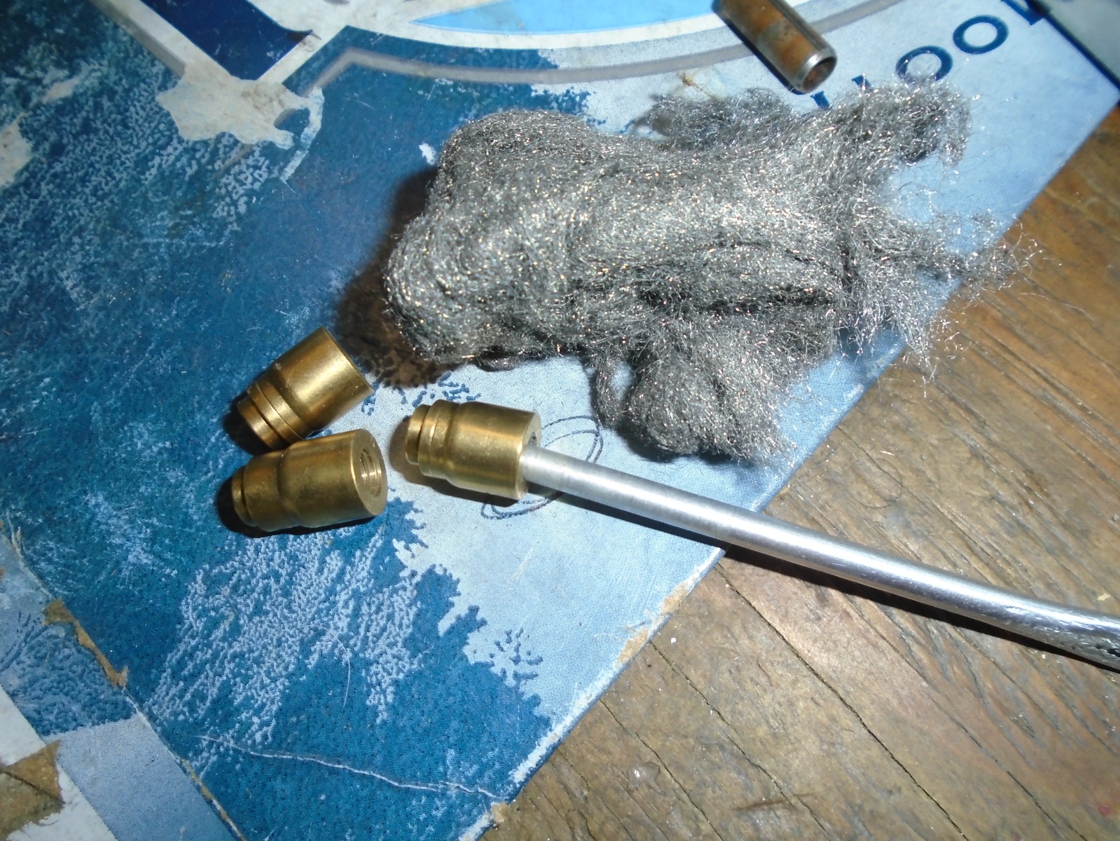

I'd check the float needle and seat in #3. Make sure the spring loaded pin, that contacts the float tang, is free and moving smoothly. Also, look at the rubber tip, and make sure it's not deformed. Lastly, inspect the float seat. I use a heavy duty industrial Q-tip, dipped in brass polish, and spun in a drill motor, to make sure the float seats are in good condition.

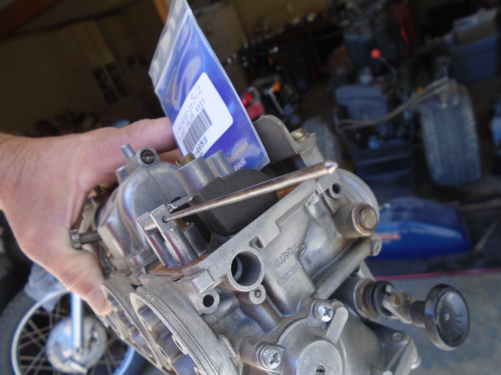

Like ED said, no extra's required, just a nice fitting tygon-clear or some hardware variant tube at the base of the overflow and open the Phillips screw. You'll easily find fuel level. Hopefully the Phillips drain screw has a decent oring but that's a different conversation. Also hopefully it's not stuck, have seen many that were. As far as the float needle and seat, have a glance at this info. If it's flooding out the intake, rest assured it's also going straight down the intake of affected cylinder. Here's an additional addendum of what Ness (ED) had mentioned and a bit more. He's a smart cat but i never waste my time with pedestrian toothpaste or any swivel mechanisms, just shuck and replace. Know that the Kawaski had a "thinking" 2.4 float seat whereas Suzuki used a 2.0 something. At least i can tell from a Keyster labeled replacement. But 2.0 would work just fine with a stock engine. Anyhoot, one can interchange these BS34 parts around between models noting there is a difference in the needle and seat. But ya can't easily effectually put one kawasaki needle into a suzuki seat and vice-versa, they operate within perimeters of each other. Heres a pic of a suzuki Keyster set set into an early J carb set, works just fine, A might expansive but more info is better then just someone blurting crap out. Pictures are cool. Also make sure you didn't just jam that 1.5x7mm float seat oring home, needs a little fingertip of oil to get it seated. You can buy those at any hardware store if you messed-up

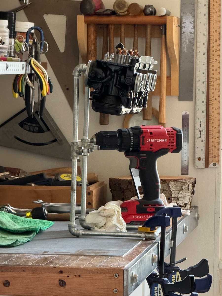

Second, I've rigged up a quick bench stand using some small pipe and fittings. It does make things easier.

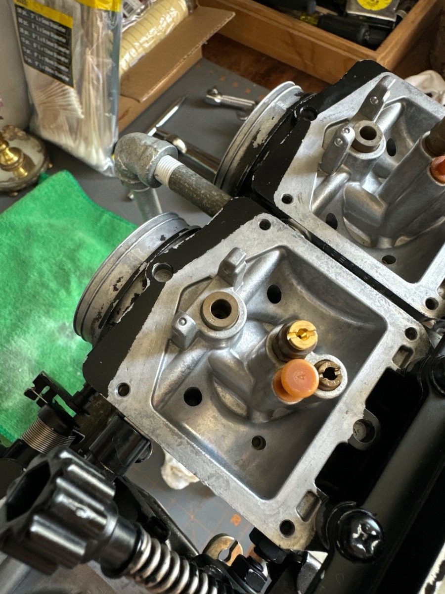

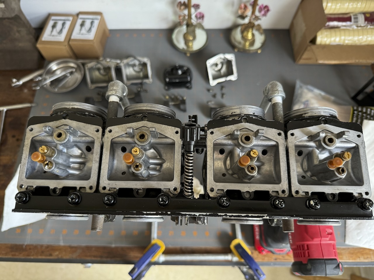

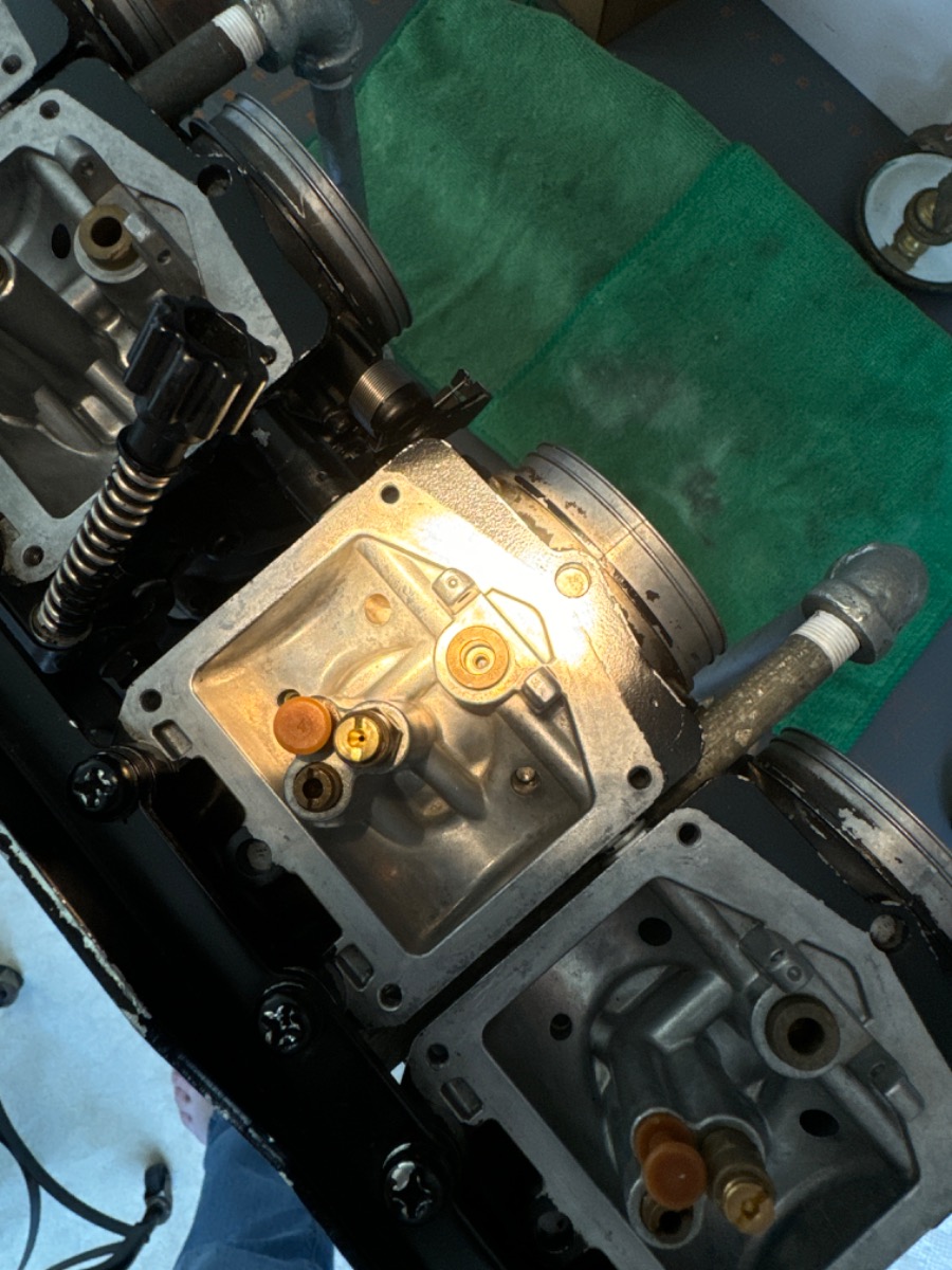

Pictures below...

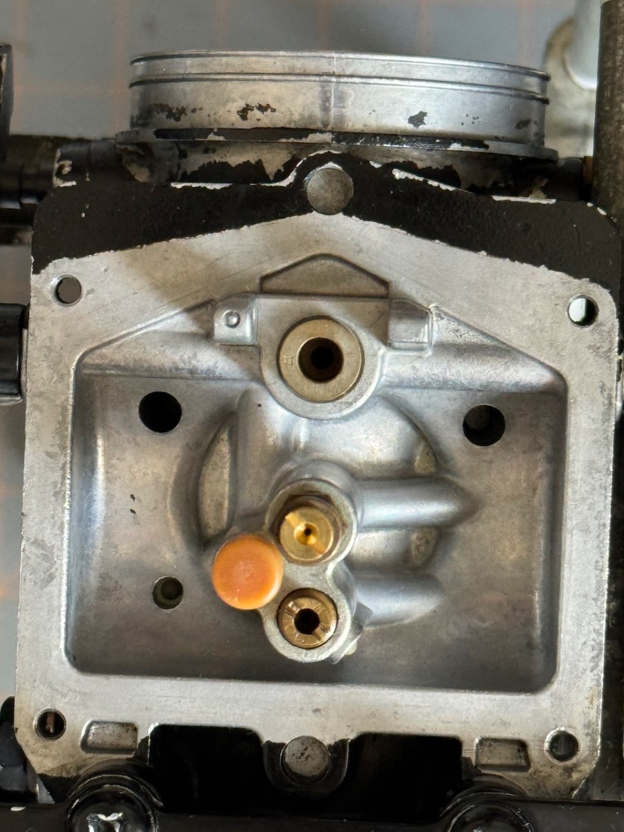

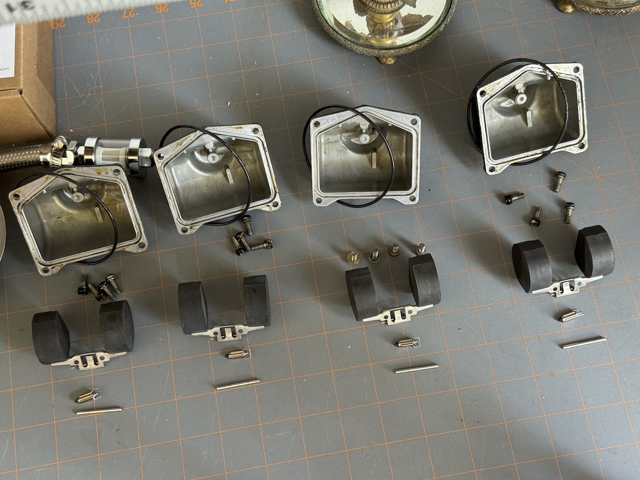

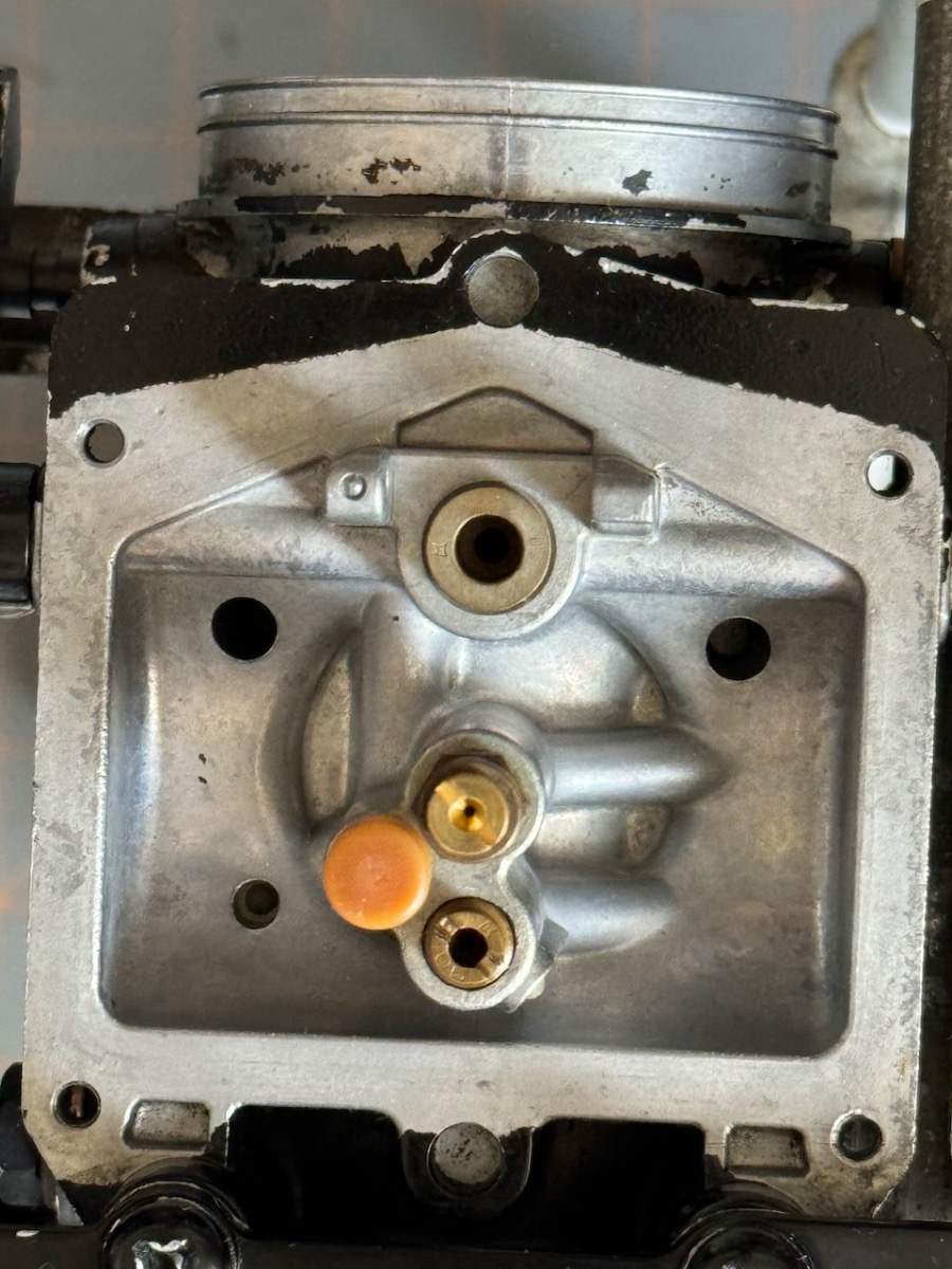

Here's the full rack, 1 to 4, left to right

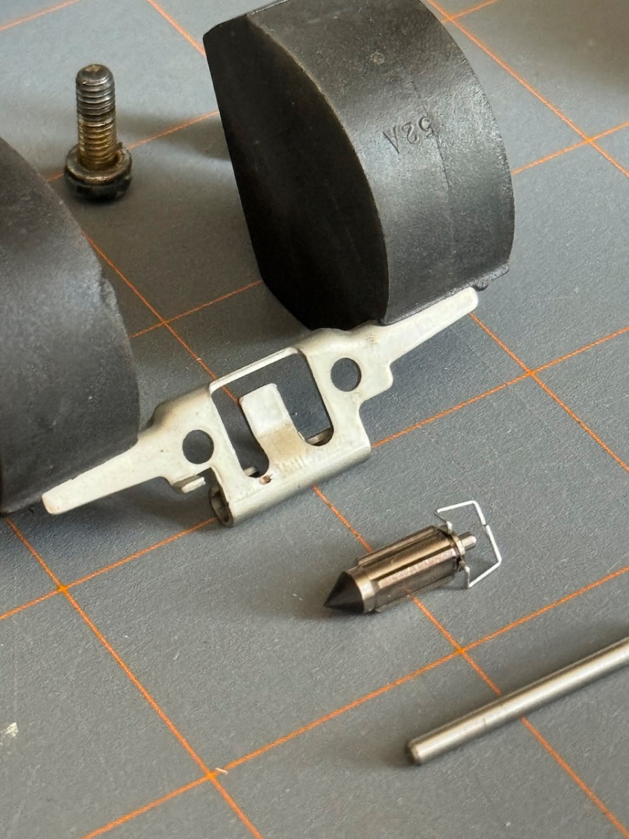

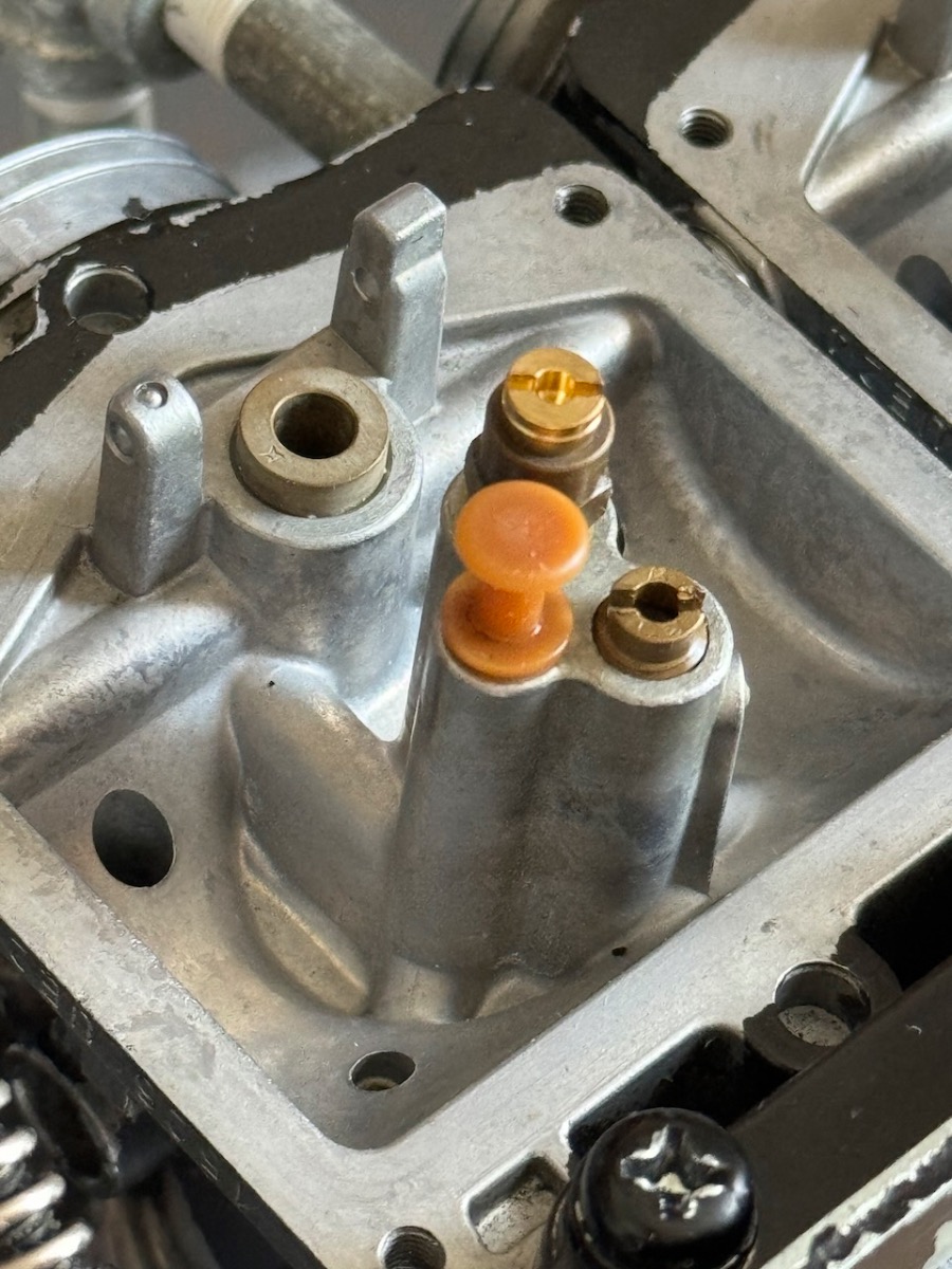

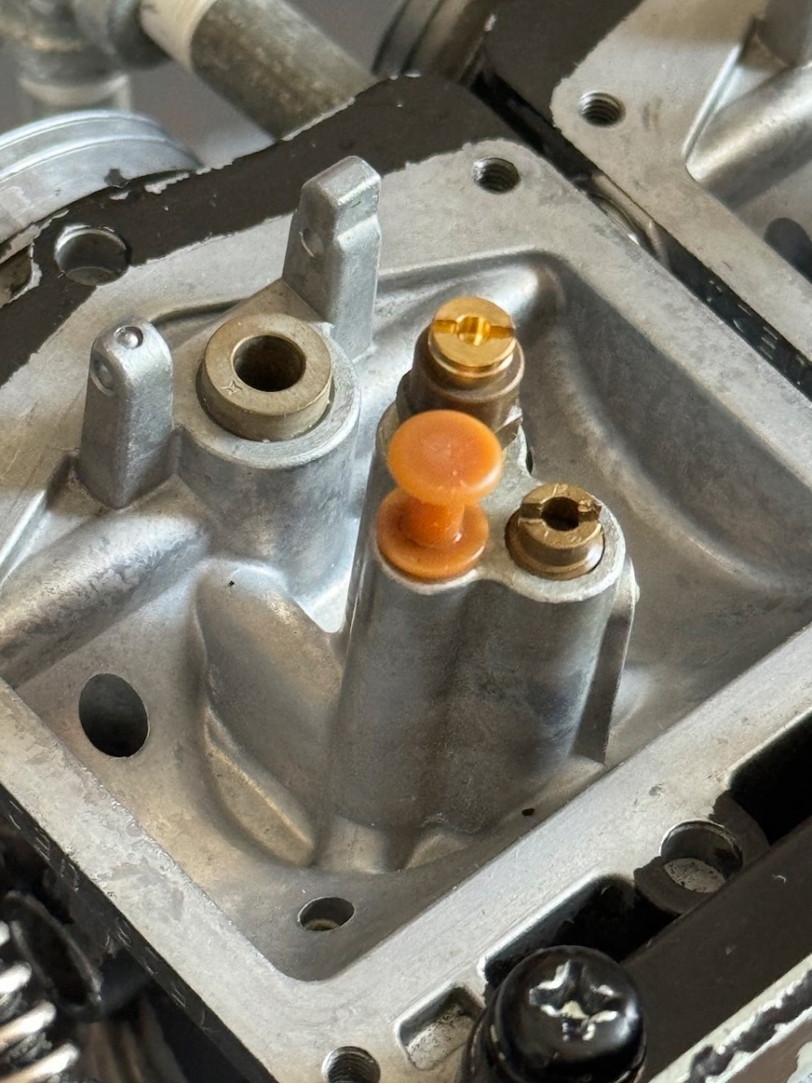

Here are details of carb 3 and its parts.
First off, yeah, as per both the clymer and the factory manuals, I did just use some clear tube to check the fuel levels. That said, I was using one of those gravity fed auxiliary fuel tanks from Motion Pro with the petcock wide open. No vacuum. Could this be an issue though?
So far, I've popped off all the bowls and checked that everything looked and felt like it was moving feely; no obvious issues. I have pulled the float pins, floats, and float valves (which are also new but from one of those rebuild kits on "the bay of E".
All the rubber is already new. Ness sold me a full set of fresh o-rings, and I think I've gone through and replaced everything.
Next step is to run out to grab a little brass polish.
Pictures below...

10 Jun 2024 15:29Like ED said, no extra's required, just a nice fitting tygon-clear or some hardware variant tube at the base of the overflow and open the Phillips screw. You'll easily find fuel level. Hopefully the Phillips drain screw has a decent oring but that's a different conversation. Also hopefully it's not stuck, have seen many that were. As far as the float needle and seat, have a glance at this info. If it's flooding out the intake, rest assured it's also going straight down the intake of affected cylinder. Here's an additional addendum of what Ness (ED) had mentioned and a bit more. He's a smart cat but i never waste my time with pedestrian toothpaste or any swivel mechanisms, just shuck and replace. Know that the Kawaski had a "thinking" 2.4 float seat whereas Suzuki used a 2.0 something. At least i can tell from a Keyster labeled replacement. But 2.0 would work just fine with a stock engine. Anyhoot, one can interchange these BS34 parts around between models noting there is a difference in the needle and seat. But ya can't easily effectually put one kawasaki needle into a suzuki seat and vice-versa, they operate within perimeters of each other. Heres a pic of a suzuki Keyster set set into an early J carb set, works just fine, A might expansive but more info is better then just someone blurting crap out. Pictures are cool. Also make sure you didn't just jam that 1.5x7mm float seat oring home, needs a little fingertip of oil to get it seated. You can buy those at any hardware store if you messed-up

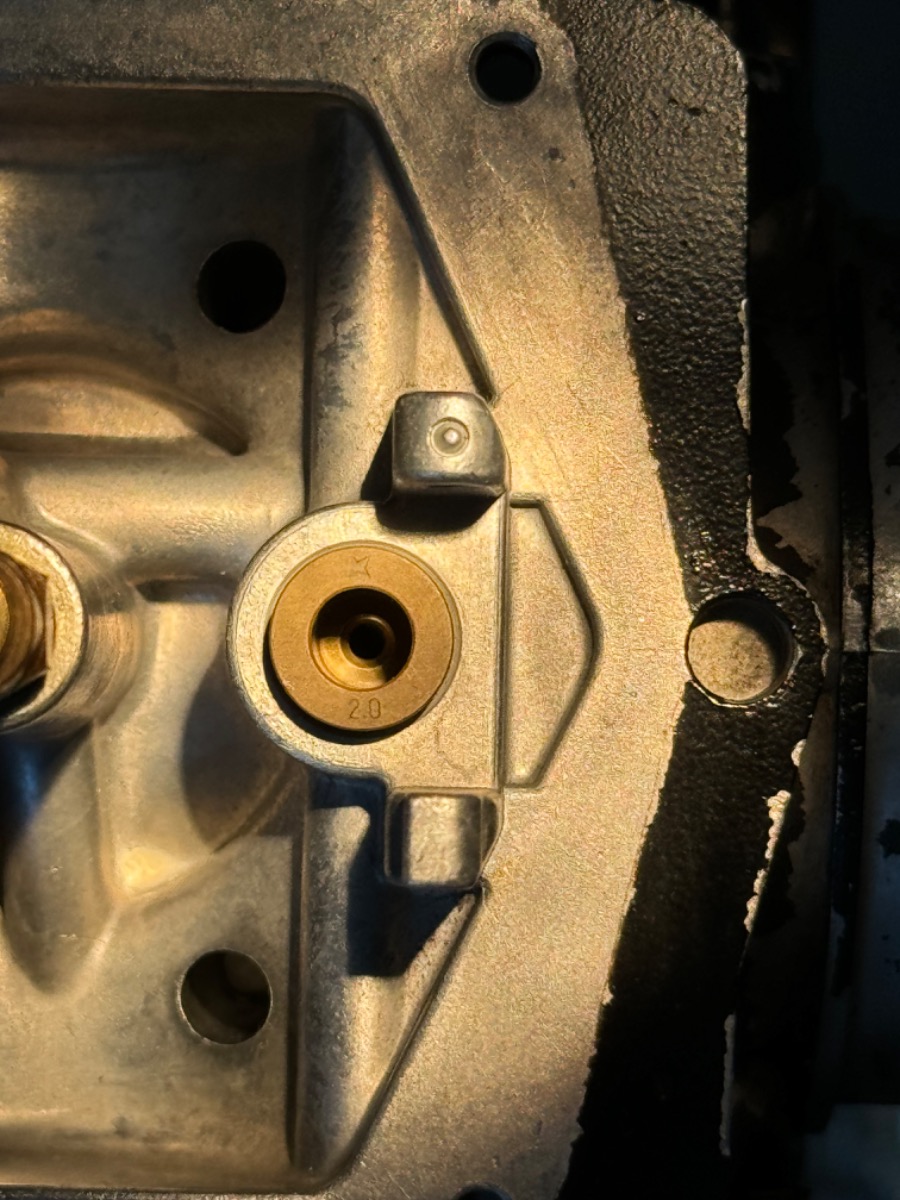

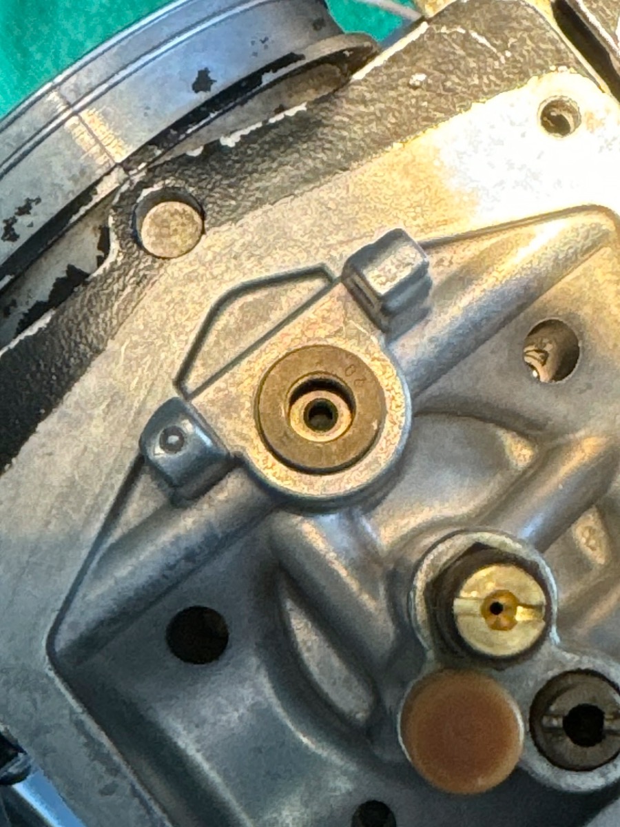

Hey Clay,
With BS34's, more times than not, I ditch the float valve assemblies. The carbs in question here are Keihin CV34's though, and as the photos show, the float seat doesn't come out.
And speaking of the float seat, that one photo shows a ring of black crud on the needle seating surface. I wonder if that black is rubber transfer from the float needle? Looks like you found the problem.
And speaking of needles, real deal Keihin and Keyster are the only brand needles that I've found that will hold up the weight of the float. They are worth the trouble to chase down...

Re: Fuel Leaking from #3 - airbox side
10 Jun 2024 15:50
ED You are 100% correct!! I have no clue why i was thinking the "other 34's". But i see the crap down the opening as you mentioned! I just use a tube and a wad of 0000 steel wool jammed in the tube, then twist it in the opening. But maybe relevant ramblings for the person that has the "other" removeable seats? Ironically though i do pull the seats out of the one's that aren't supposed to ever be removed, just silly like that i guess.

I hate to say it but that black ring is really just a trick of the light.
I’m going to polish the seat anyway.

10 Jun 2024 20:51 - 10 Jun 2024 20:59
Also, if you look close at the photo of the fulls set above, it seems like someone went after switching out the seats on carb 1 & 2 but didn’t get too far. I’m uncertain I wouldn’t f them up
