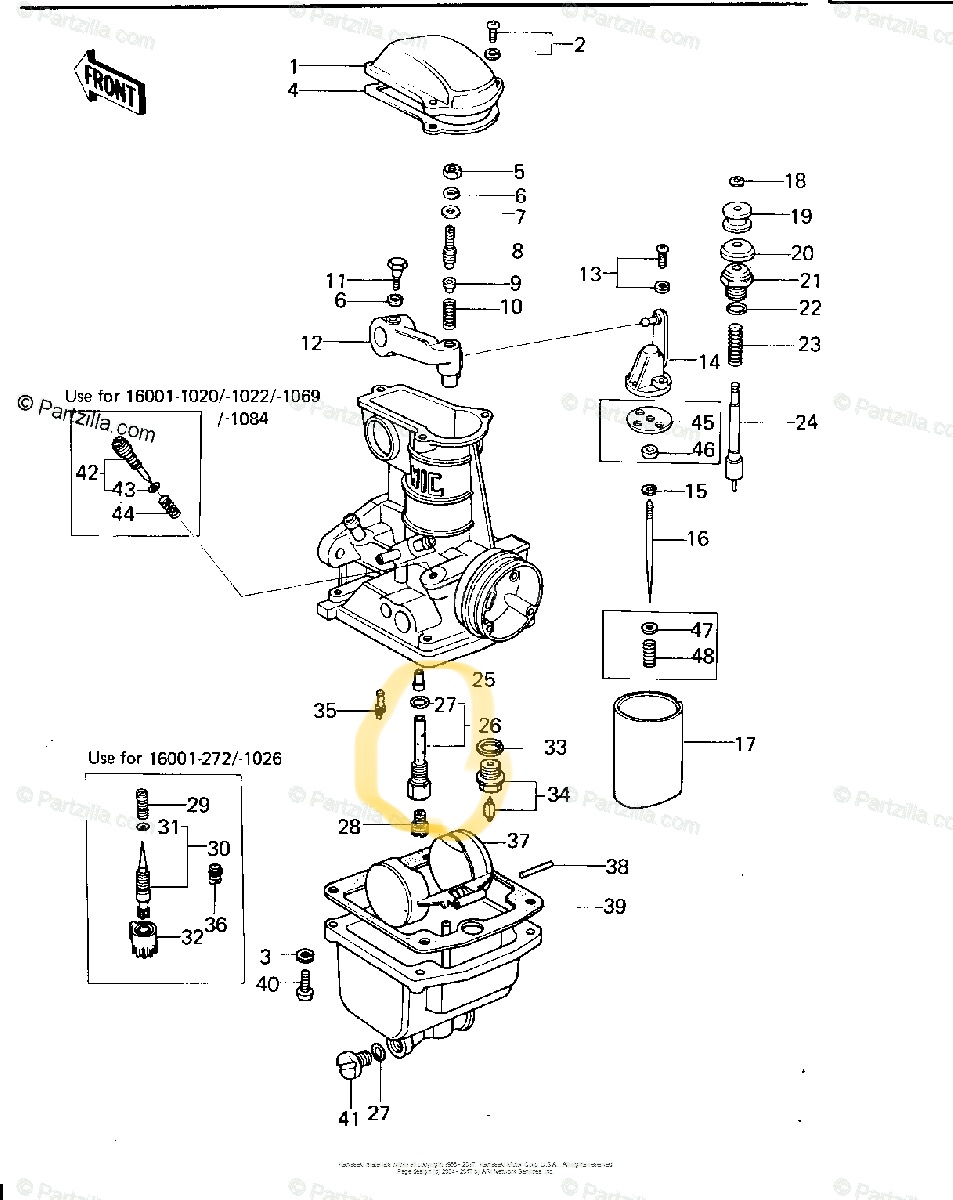

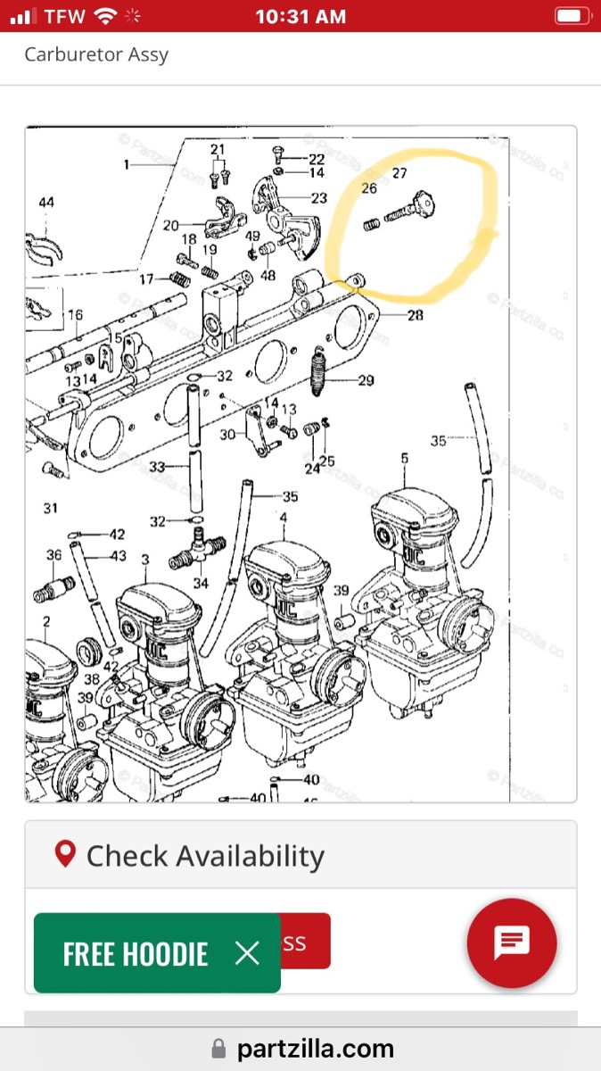

Is the bogging at opening throttle ,while your trying to ride or just trying to free rev with no load? If bogging trying to ride,, will it free rev? Does putting the choke on a little help? Do the idle screws on the side of carb work,, meaning do they change how it idles when turned in or backed out,, do you have to screw them all the way in or back them way out( more than 4tuurns)?Does it fire right up when it’s cold or do you have to crank a lot and fiddle with it?Careful here, but are all four pipes getting hot when it’s idling? After you have warmed it up and tried to get it to rev and it dies out and (careful)immediately pulled the plugs ,are they clean and looking lean or sooty or wet?Sooty /wet could mean to much fuel or not enough spark and or timing. Will it idle down (1000 rpm)? How are you setting the idle because I don’t see a idle speed adjustment screw in the throttle bell crank assembly?Does it pop and sputter at idle?Not sure what your talking about you have plugged on the second carb I don’t see a vacuum port. Not a expert on 650 carbs but I think some had a vacuum port on carb 2 for automatic fuel petcock and that should be plugged if not used. (Pic)? I would make sure all the vapor blasting media is cleaned out of the carbs! Side note, for not having a idle speed screw(that I can see) the slides look a long ways up. And it might be just the way the photo looking down the two center carbs throats is taken,, but your carb sync looks way off to me.
Last edit: 20 Feb 2024 08:39 by Bcot. Reason: Adding

Hi Thankyou all for your help. So First question was the plugs think i have both resistor plugs a caps. So will buy new plugs.
2. The carbs do have an idle speed screw just wasn’t in on photo. And works.
3. Can’t ride bike on load. Hasn’t been on the road yet also will only tick over.
4. Bike starts on second or third time. Reeves up with choke in till warm about 3revs then take choke of and will idle and not pop.will idle at 1000rpm
4.taken the plugs out straight away all 4 slight black a bit .on the look.
5 as soon as i opening the throttle with no load. It wants to die. This is running main jet at 105.. pilot jet 15 clips needle on 3. And half to one turn out on the screw.
6. Felt like lasted week when running 17.5 pilots jets and main at 112.5 would start on the button. And would rev to 4000rpm the die.
what are you thinking? New plugs without the resistor and what next?
