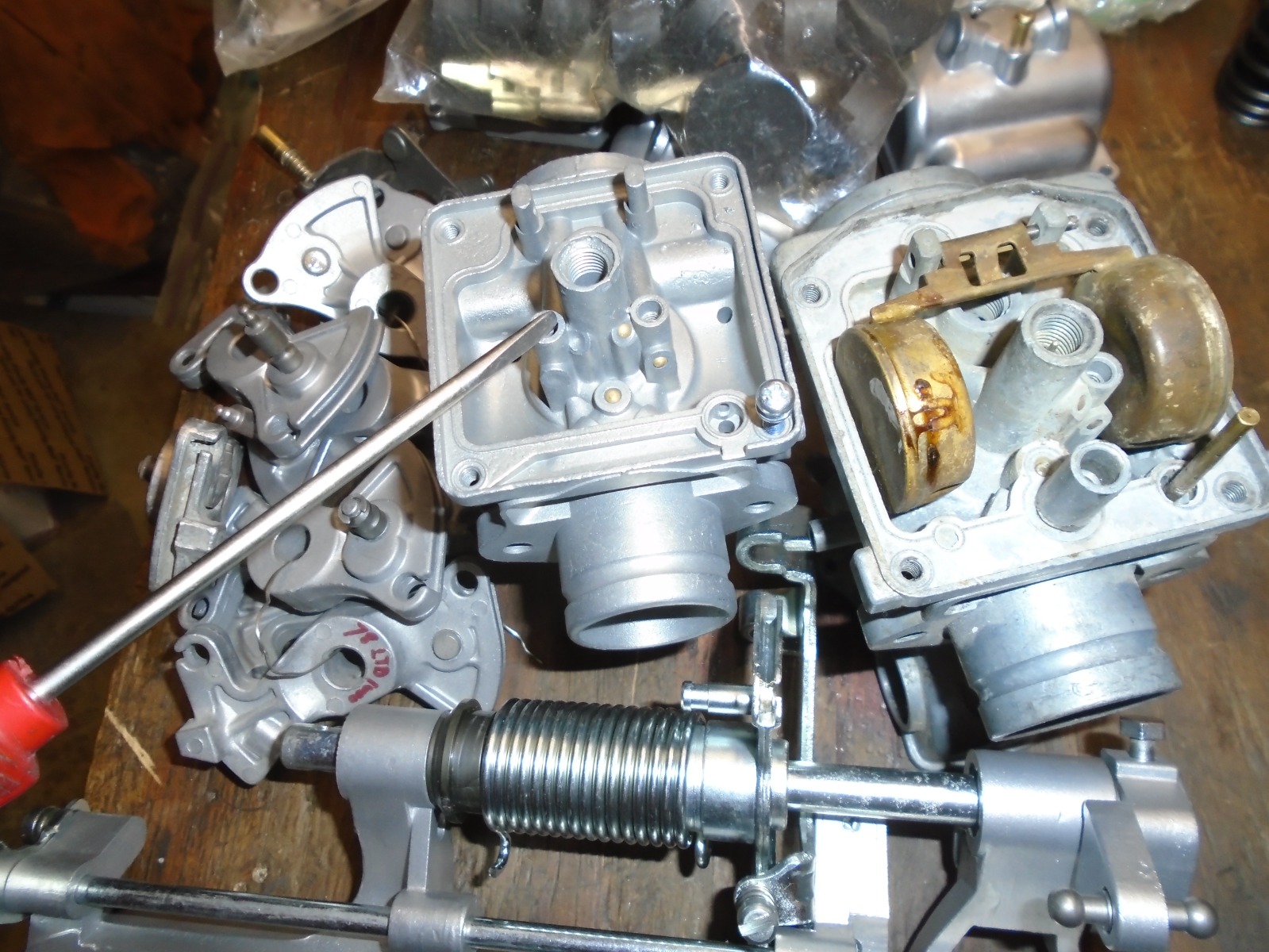

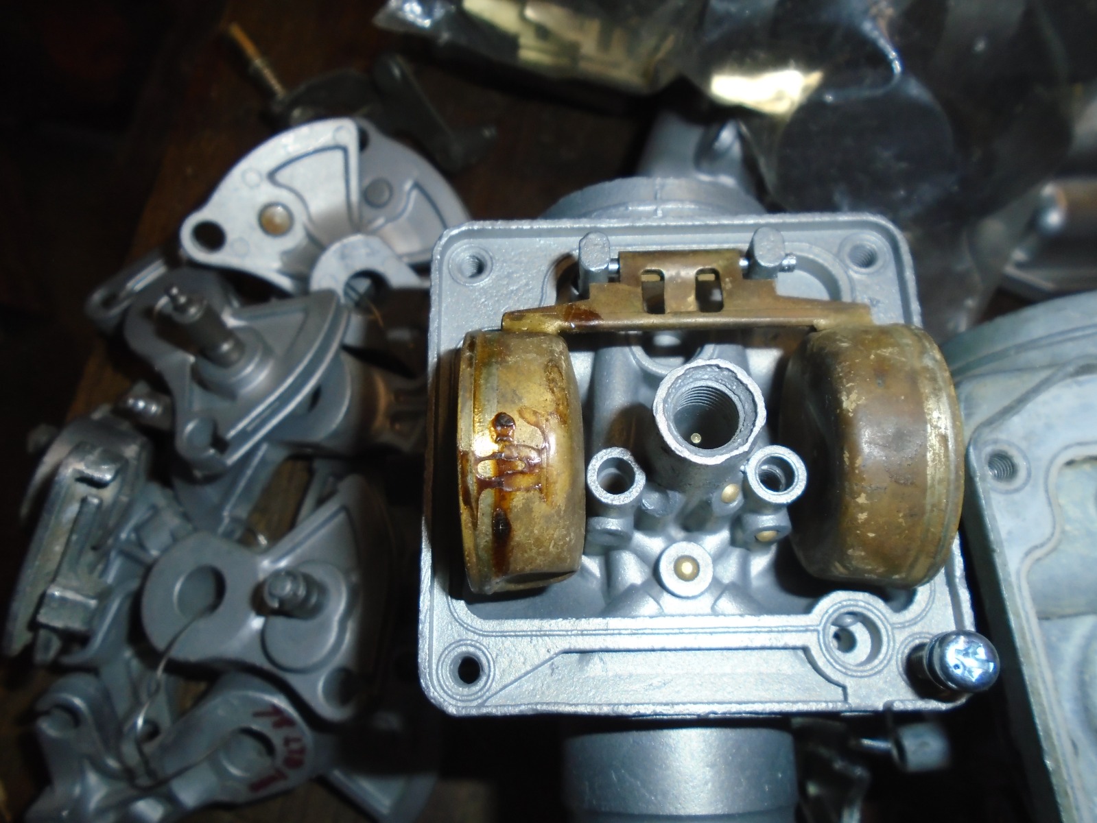

09 Jan 2024 10:56Mikuni 786-15005 Viton Tip float valves work well. I rebuilt a set of carbs a while back with them and they sealed well. They only come in 2.0 and 2.5 size, whereas KZ bikes use 2.3 size. I'm quite certain that 2.0 is plenty of flow.Here's some crazy for crazy thinking "outside the box" stuff if one would want to try it? I've been doing it for years with great results. I've not bought a paper bowl gasket for years either. I o-ring the bowls, no more brown staining down the sides. Use a Float set from a Honda VF750 82-83. Yes it's Keihin and one would think the diameter/pitch of thread would be different but interesting enough it's the same. This allows a bump to "newer" stuff, viton tipped needles compared to the brass/steel of the originals. Just a slight modification to the protrusion whereas Honda used a small screen, other than utilizing the "hook" that goes around the float tang to needle, you're set.
