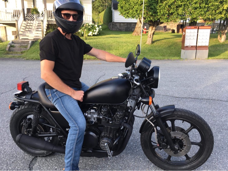

Hello everyone, my project is now done. Ready for this summer. I would like to know what jet I should put in my VM28ss from Z1r in my KZ750 . Now I have 107.5 main and 15 pilot(vm28ss carb). Carburetor are freshly rebuilt, adjusted on point!! My Motor has a 0.5mm oversize, small porting, milled 0.006’’, pod filters, exhaust 4-1 w/o baffle !! Im located to Canada, quebec. My altidude is 400 meter.. I see some of you start with 117.5 main and 17 pilot, but I don’t know the altitude for these set up… ?!!

Just to confirm the carbs in the included photo are not VM carbs. They are BS, vacuum slides. Completely different. Are you identifying your carb rack correctly?

Ok I will try to find these air corrector jet on ebay.. and what size of these one a need to put first ?! And Yes for the picture it was last year with The CV34mm !!
