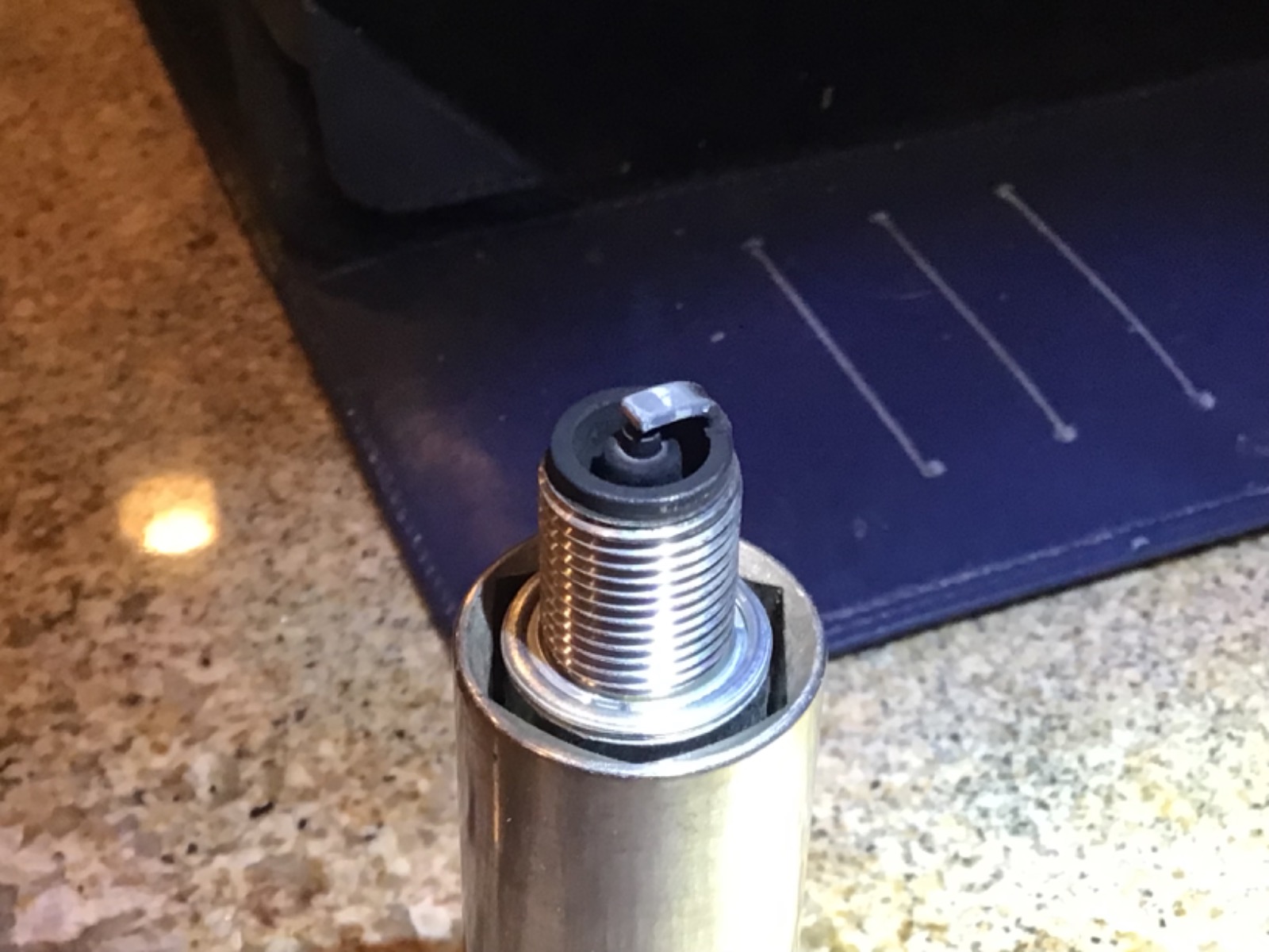

01 Nov 2023 09:34 - 01 Nov 2023 13:08Before pulling the carbs again swop plug leads 1 & 4 if the are long enough.Yeah, something is going on in that #1 carb. I’m pretty sure it’s anything in the ignition because #4 plug is fine. It’s looking like I’ll have to pull the carbs and go thru them again. I never thought to check the needles out of round. Thx
If the issue remains on the same cylinder then it's likely carbs or valve seals. If it moves with the lead it could be ht to coil connection or ht to cap connection or any of the single components. A weak spark will cause a sooty plug.
On the thread I copied the picture from it was only plug three that was breaking down. It turned out to be a dry contact between the coil 'pin' on number 3 and the ht lead. This was on a coil that had sealed in ht leads.

Sounds lean if it’s got a pop. Generally caused by hard/worn carb holder boots. Pull all plugs and look to see what each cylinder and piston looks like.
What plugs are you running?
Last edit: 01 Nov 2023 19:44 by Mikaw.

Carb holders all new. Very sure it’s not a vacuum leak. B8ES. Plugs 2, 3 and 4 are a little sootier than ideal but I’m running 117.5 mains and may have to go to go back to the stock 115’s.
On my ride today I got on it pretty hard and holy sheepshit, this bike is fast. It pulls strong and hard with no hesitation. Been a while since I rode this bike hard.
Im eliminating the top end as a problem. Something in the #1carb I’m hoping to find as a problem

Where are the pilot air screws? Angled into the carb Venturi? Or behind float bowls? Finding out that 2,3,&4 are sooty also changes the story some, could be loading up while idling. You can go one heat range hotter to a B7ES

Air screws are angled on the side and right around 1 turn out. Plugs 2, 3 and 4 are a little sooty, but not bad. Another thing, this motor cranks for a very long time before it fires. Once warm, instant start. I haven’t checked actual compression with my gauge, but I did the finger test before I first started it up. Once running, it runs solid. No smoke at all. Doesn’t seem to be running rich at all.
I got my 4 gauge kit so I’m going to work the syncing of the carbs, but I don’t think that’s my problem. At what rpm do you do the testing at?
