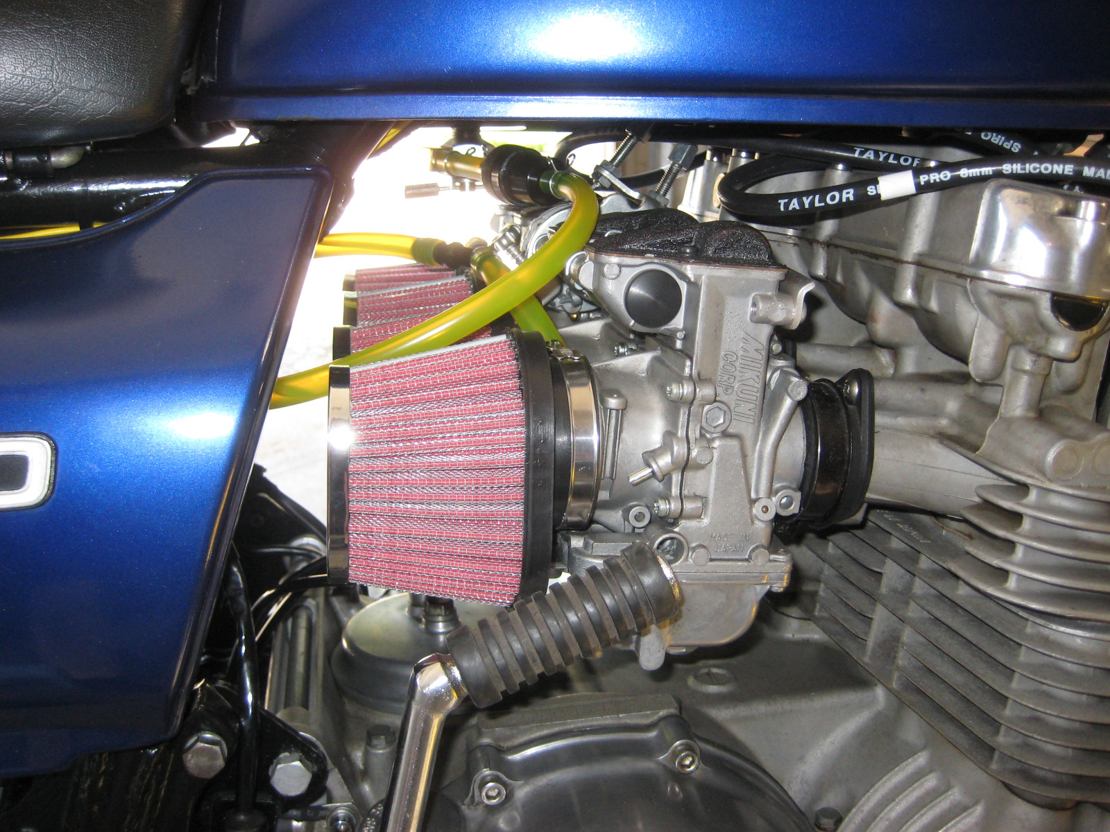

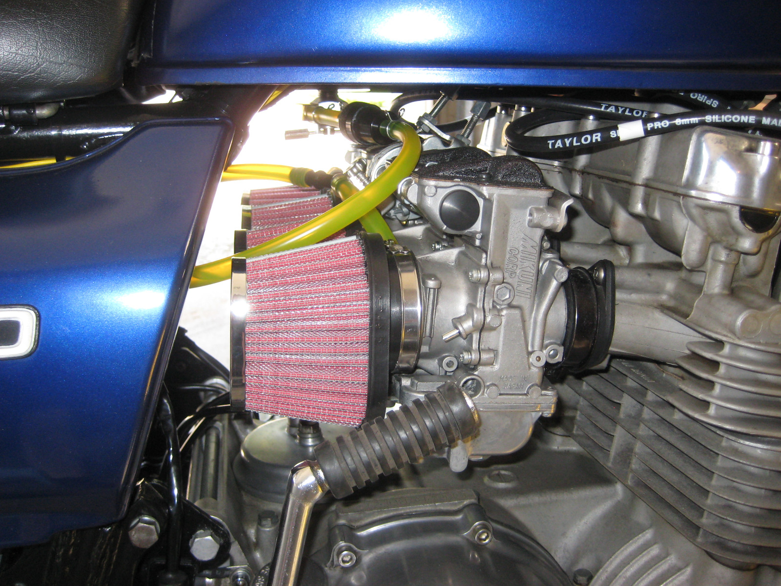

04 Aug 2023 09:06 - 04 Aug 2023 16:03Personally I don't like the look of the CR inlet spigots. I do like the way the Mikuni carbs are easy to adjust.To injected,
Okay, so you would go with the Mikuni RS34 flatslides?
That means it is nessercary to port the intrance of the inlets a bit?
what range is the standard GPZ cam in? and will it still be street rideable?
thanks!
RS34s on KZ650 with 831cc (my bike)
As for the port matching it is not needed if you don't want to do it. Just look at the ports with the rubbers on and the carbs off, if there is material to be removed it will make a slight flow improvement. If it can be done without removing the head that is good.
