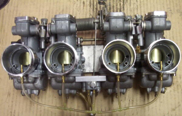

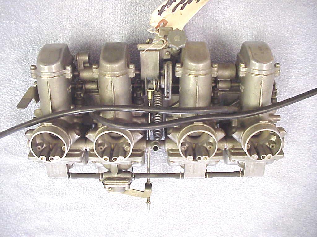

Like you Ed I too have never seen vm29ss carbs with accel pump. I would guess it was an aftermarket system but do not know this for a fact. Would love to see what it looks like. I do have a pic of some vm28sc carbs with a pump here it is.
The other thing I will say is the air screws on 29s don't behave the same way as on other VM series carbs because of the hole in the screw towards the tip. 1/8 turn out is about right for #17 pilot jets.

When ordering a set of smoothbores you could specify their spec and jetting.
The accelerator pump was one of the options from the factory but not too many sets about relatively speaking.

Thanks for the pic and the fact you could order them that way. I had no idea that was so.
