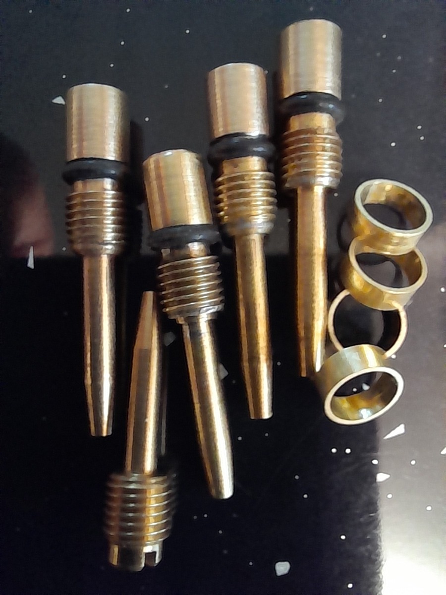

I was wondering what the performance gains and losses between 26 and 28mm pumper carbs? currently I am running 26's and am happy with the the performance, and the way they fuel is spot on, I also have a set of 28 pumpers which I have cleaned and refurbished, these are the anti tamper type which are completely stock except for the air screw, it is modified so it does not need the plug to seal it.. so what is the general pros and cons.

11 Apr 2023 10:25 - 11 Apr 2023 10:26I was wondering what the performance gains and losses between 26 and 28mm pumper carbs? currently I am running 26's and am happy with the the performance, and the way they fuel is spot on, I also have a set of 28 pumpers which I have cleaned and refurbished, these are the anti tamper type which are completely stock except for the air screw, it is modified so it does not need the plug to seal it.. so what is the general pros and cons.
I don't understand the bold/underlined parts. What are "anti tamper type"? And what "plug to seal it" are you referring to?

11 Apr 2023 11:07Lost me also 28 pumpers have air pilots that have no plug over them.I was wondering what the performance gains and losses between 26 and 28mm pumper carbs? currently I am running 26's and am happy with the the performance, and the way they fuel is spot on, I also have a set of 28 pumpers which I have cleaned and refurbished, these are the anti tamper type which are completely stock except for the air screw, it is modified so it does not need the plug to seal it.. so what is the general pros and cons.

11 Apr 2023 12:25 - 11 Apr 2023 12:30Some pumpers have short air screws and anti tamper caps (Welch plugs) pressed in the body so that the settings cannot be altered.Lost me also 28 pumpers have air pilots that have no plug over them.I was wondering what the performance gains and losses between 26 and 28mm pumper carbs? currently I am running 26's and am happy with the the performance, and the way they fuel is spot on, I also have a set of 28 pumpers which I have cleaned and refurbished, these are the anti tamper type which are completely stock except for the air screw, it is modified so it does not need the plug to seal it.. so what is the general pros and cons.
The caps need prising out to get at the air scrrews.

The air screws picture have 1 original type short air screw that was factory set and then plugged over, the other 4 are modified so they can be adjusted, as you can see instead of being threaded at the top they are threaded halfway down, the four rings are to sleeve the original plug hole so the o ring keeps it airtight, but enough about that, what of the pros and cons of 26's against 28's?
