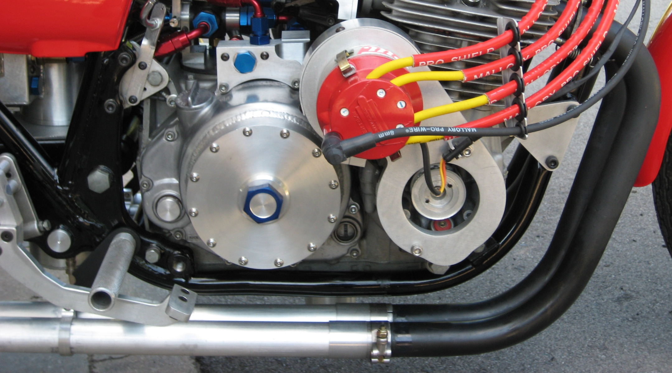

This is my 650 so I know all about straight pipes :
This runs methanol and some nitro
