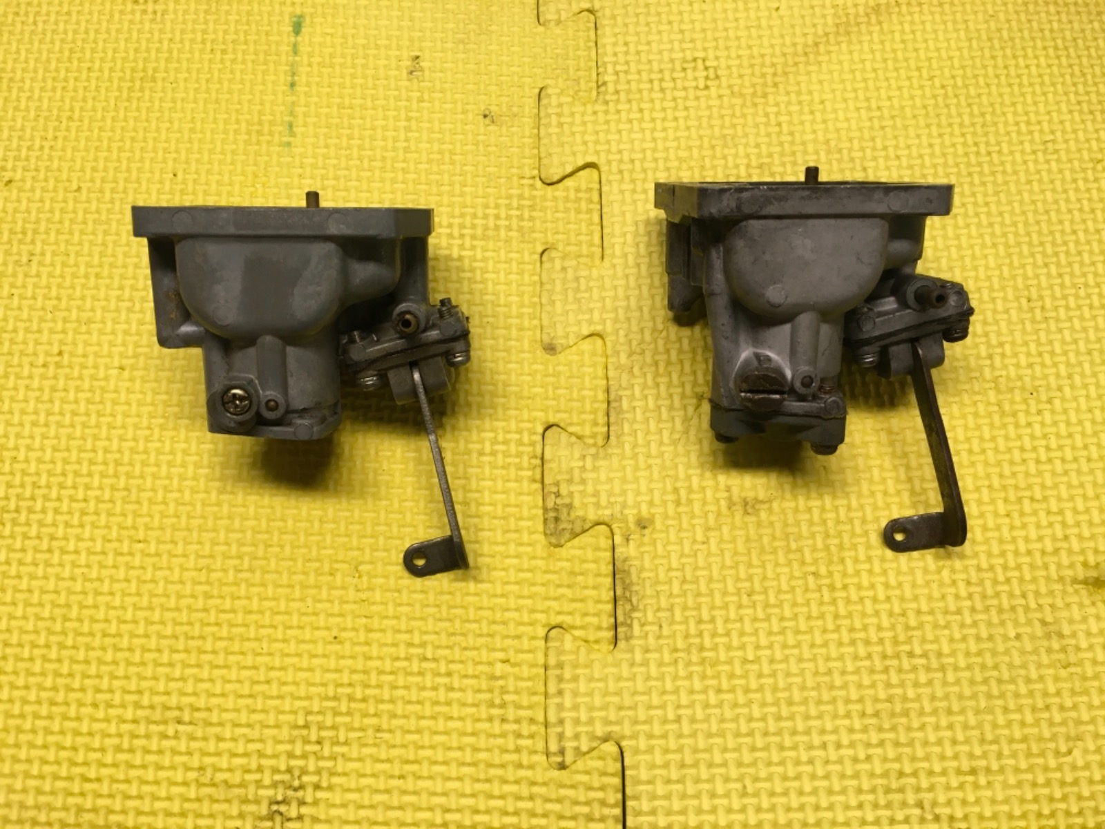

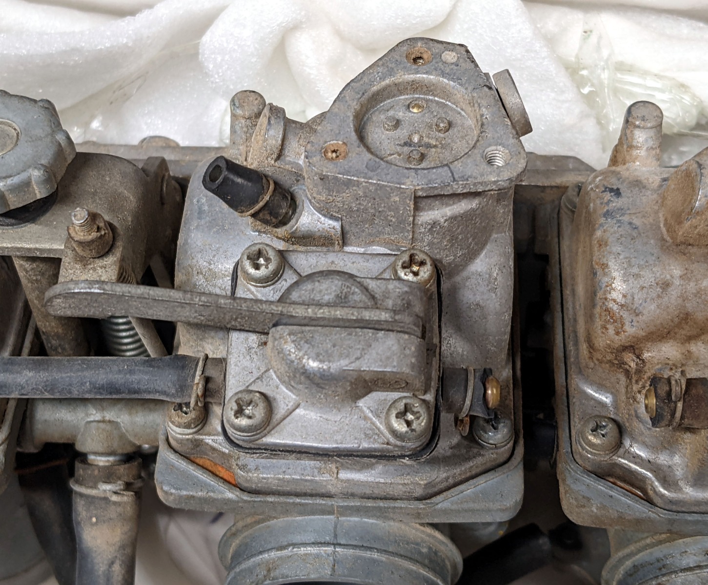

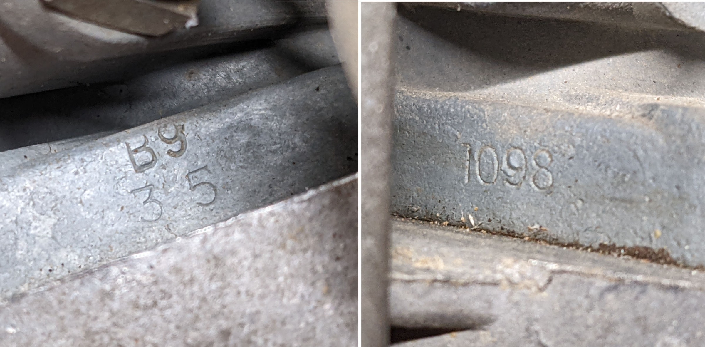

Based on this idea, the 78 Z1R VM28 would have 1040 on them (mine show 104 0A), and the 78/80 Shaft would show 1098 which matches with my previous picture.
What's stamped on your carbs?

Ill take a look see.This post has some info about stampings:
kzrider.com/forum/3-carburetor/573750-19...arbs?start=12#573843

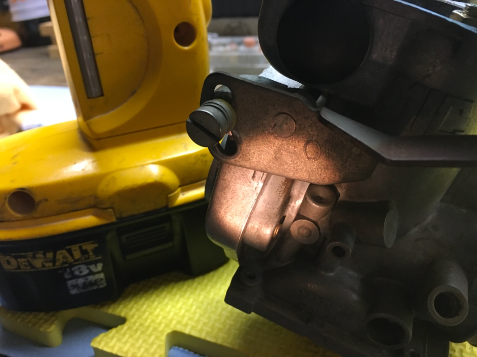

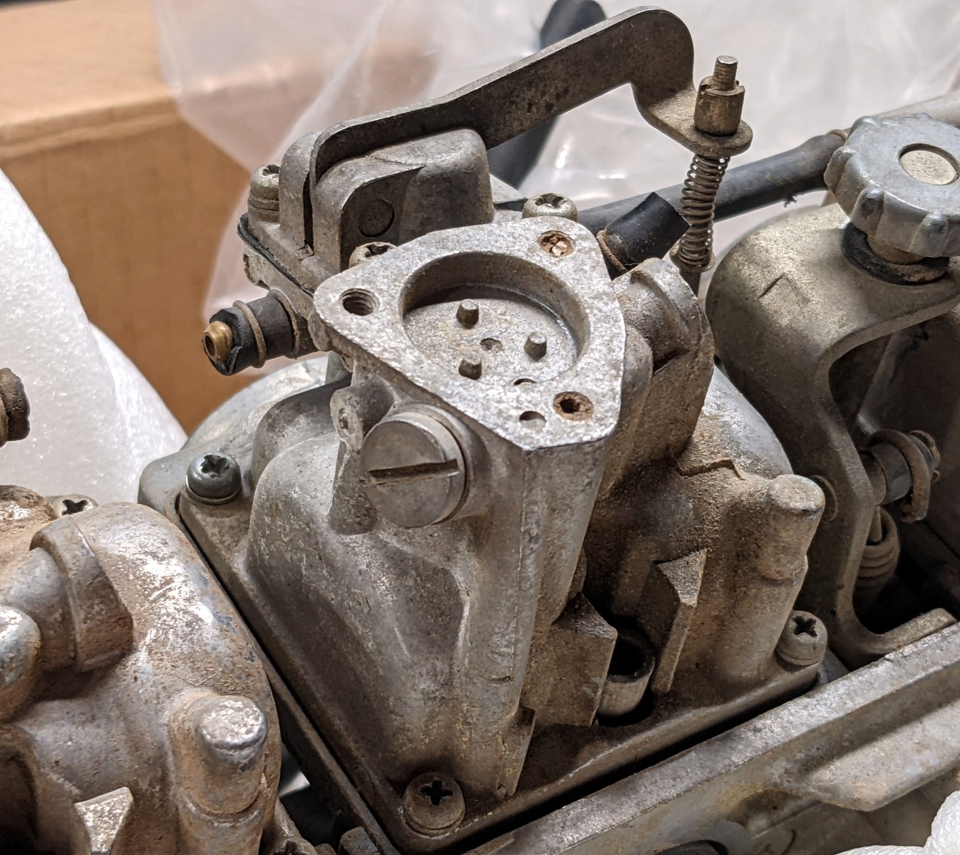

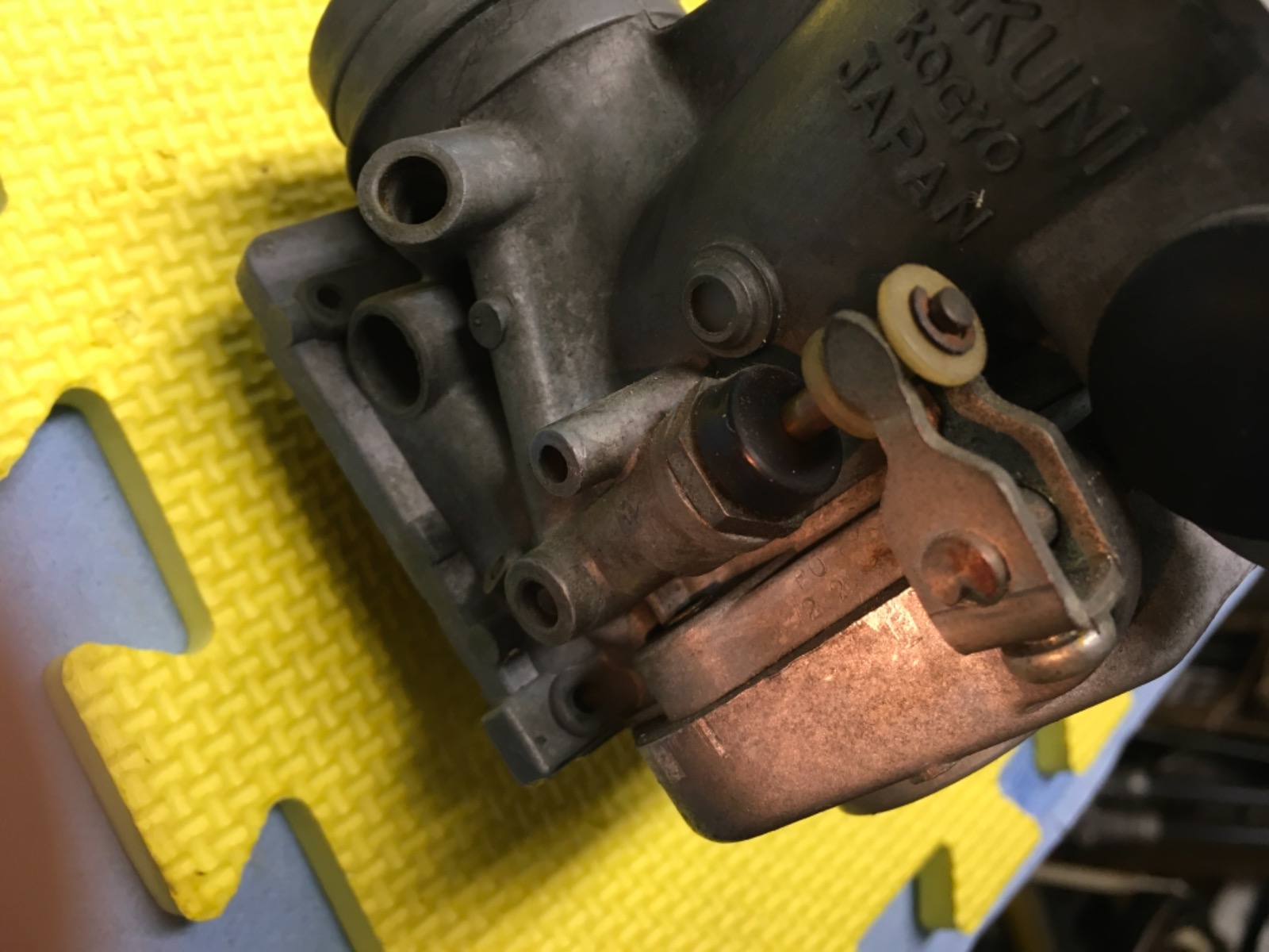

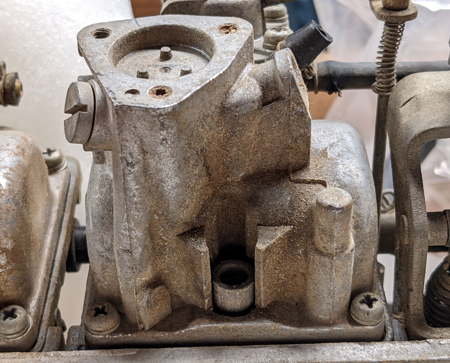

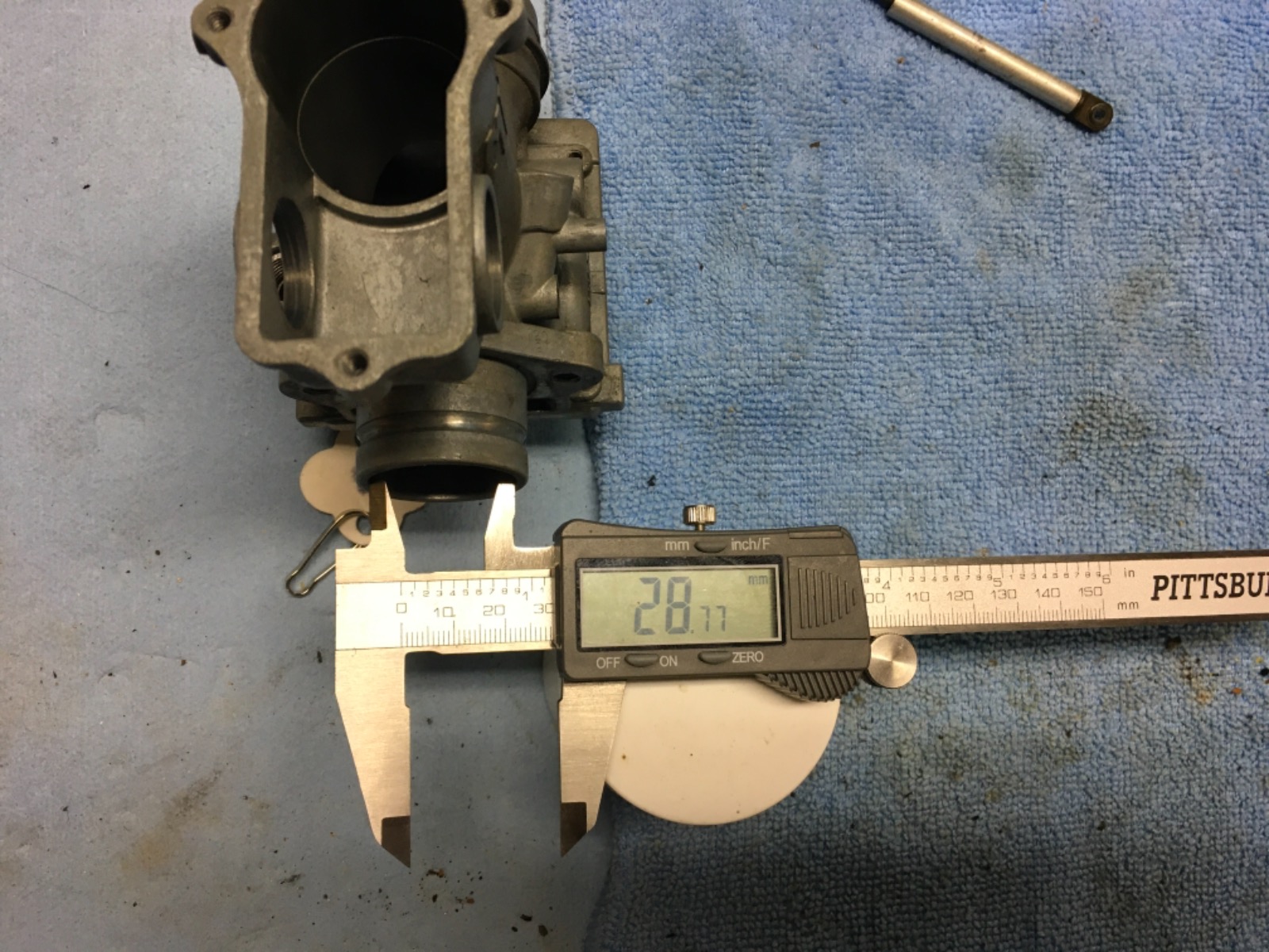

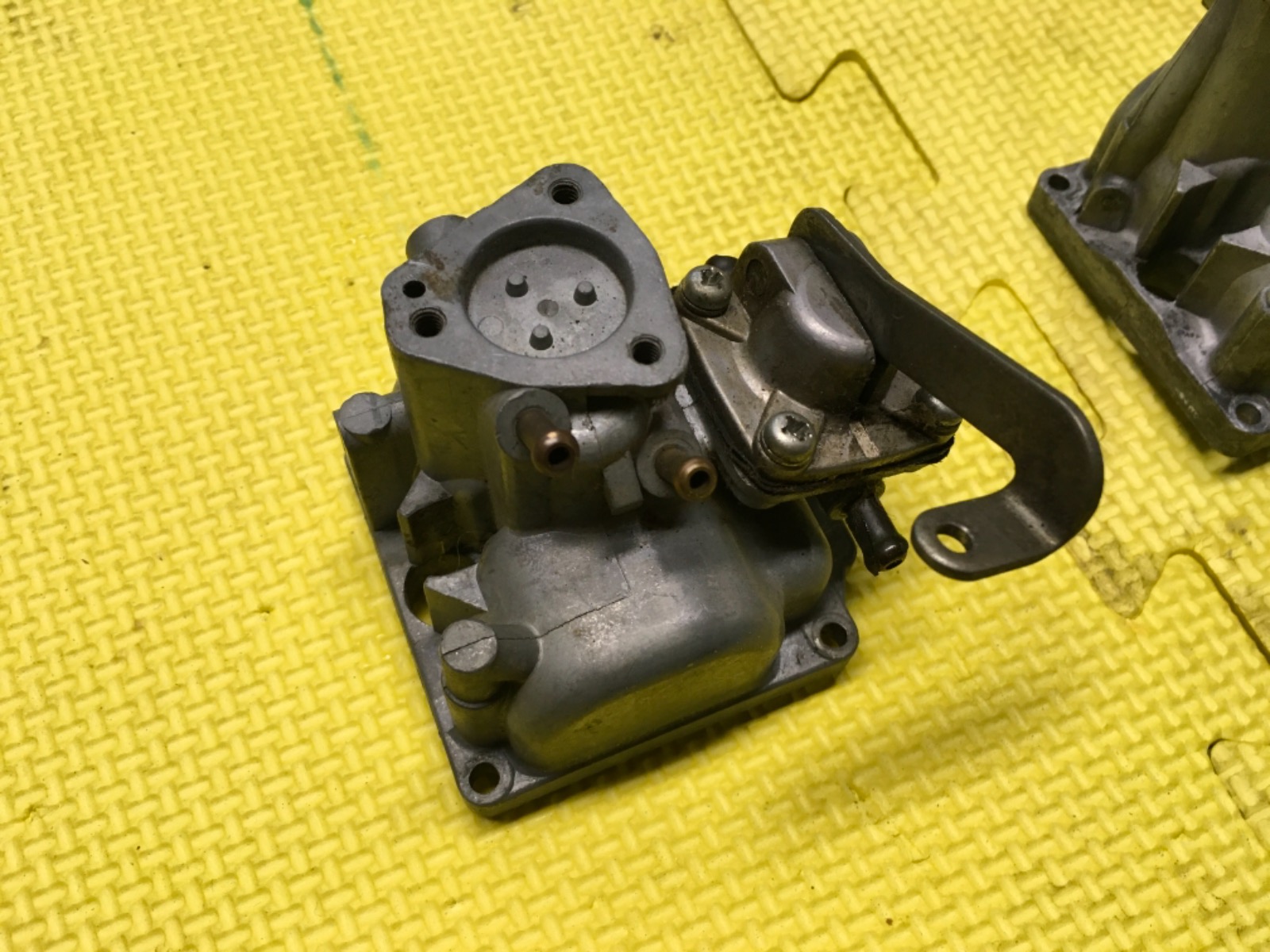

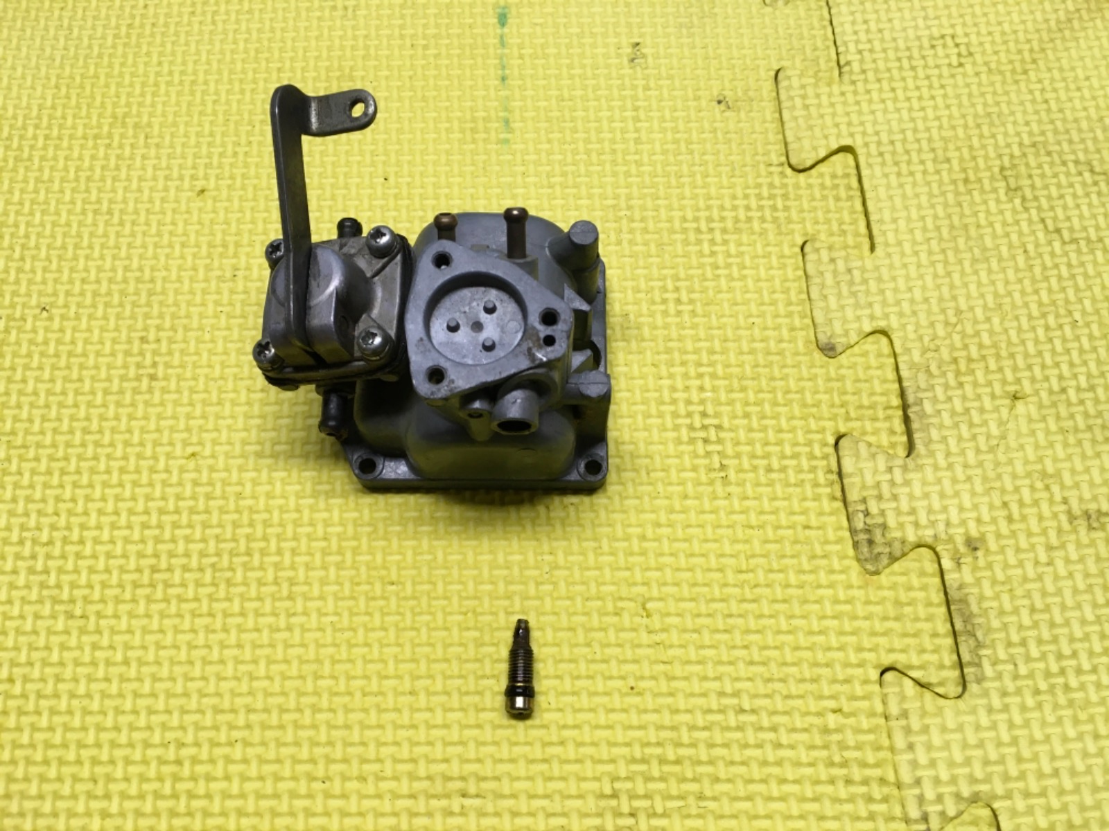

Thank you. So it’s a 28mm bowl. Does the unique drain screw lead you to Suzuki or Kaw?Only the vm26's had the sensor diaphragm so the one with the undrilled casting is correct for the vm28's.
- zed1015
- Posts: 3033
- Thank you received: 1567
The Suzuki VM's never had the pumper option so it's Kawasaki.

Going on the numbers from that other thread 1202 would be VM26.
80 KZ1000B4 LTD - kaw site list 1202 - shows used on B3 and B4
Are you sure they are VM28?
