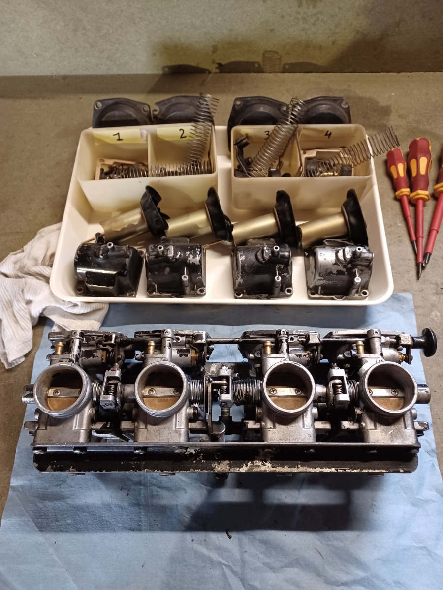

I finally started cleaning the carbs and luckily the paint came right off.
While dismantling I noticed that the rubbers on the choke plunger are worn.
Is this something I need to replace, or is it not that important?
These are gonna cost me about €100 to get here...
Maybe I should test the bike without and if all is well I can still order them.
- Posts: 7923
- Thanks: 3291
Re: Broken carbs
05 Jul 2022 10:11
Functionally speaking, those accordion boots are dust shields. It's annoying that Kawasaki went this way for those parts because the more common CAP type seal works fine and rarely fail.
