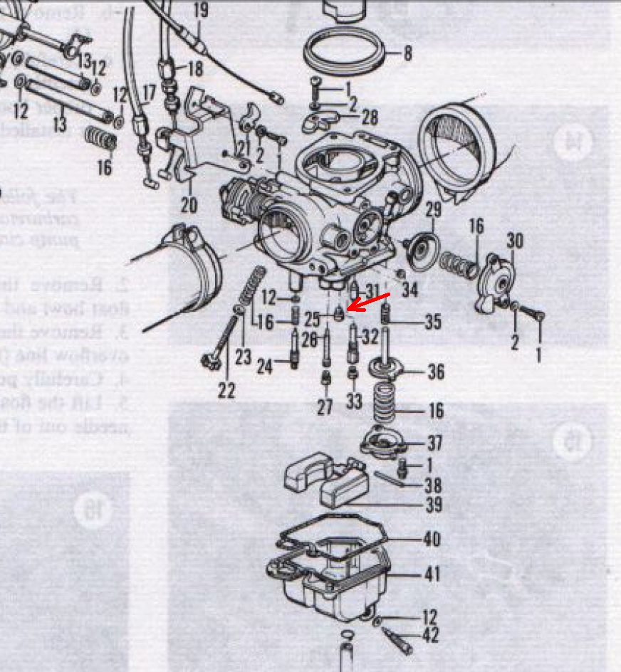

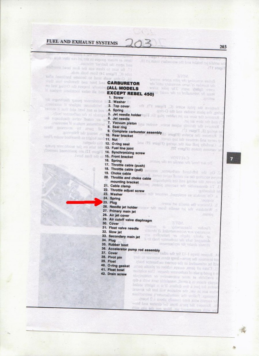

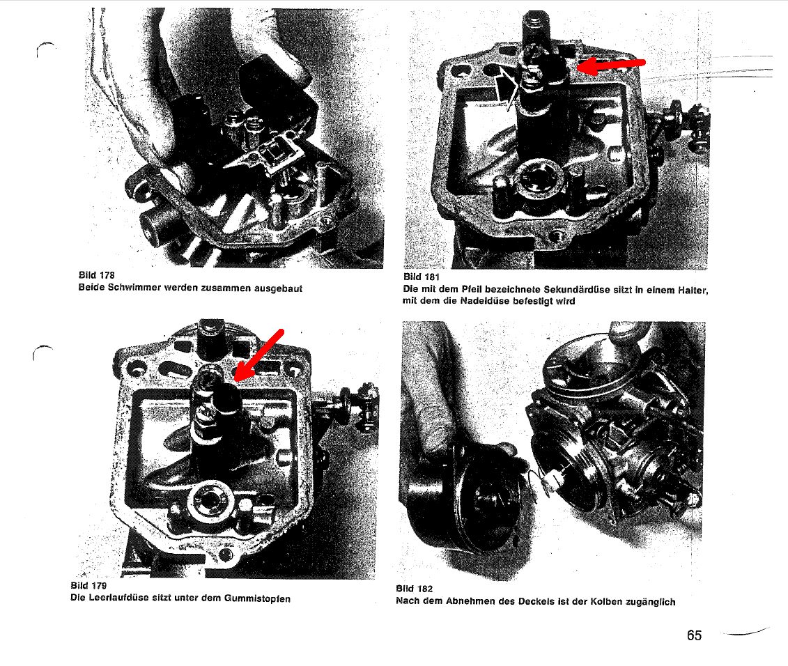

Did the Keihin carbs had the rubber plugs on the pilot jet port. If not the engine will idle/run very rich.

Scirocco, not sure if you are asking me or LenB but I do have the plugs on the pilot jet port on both carbs so no problem on that end. And my plugs at idle look pretty good (to my understanding, after reading the KZ440 service manual, the pilot jet circuit is for idle). I only have this lack of power as soon as I open the throttle more than 3/4 (again, from what I read in the manual, it looks like the main jets need to be adjusted). If I remember well, you are in Germany no ? Would you have a website in Europe to recommend where I can find genuine Keihin jets ?
