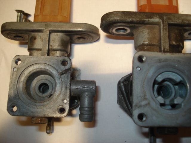

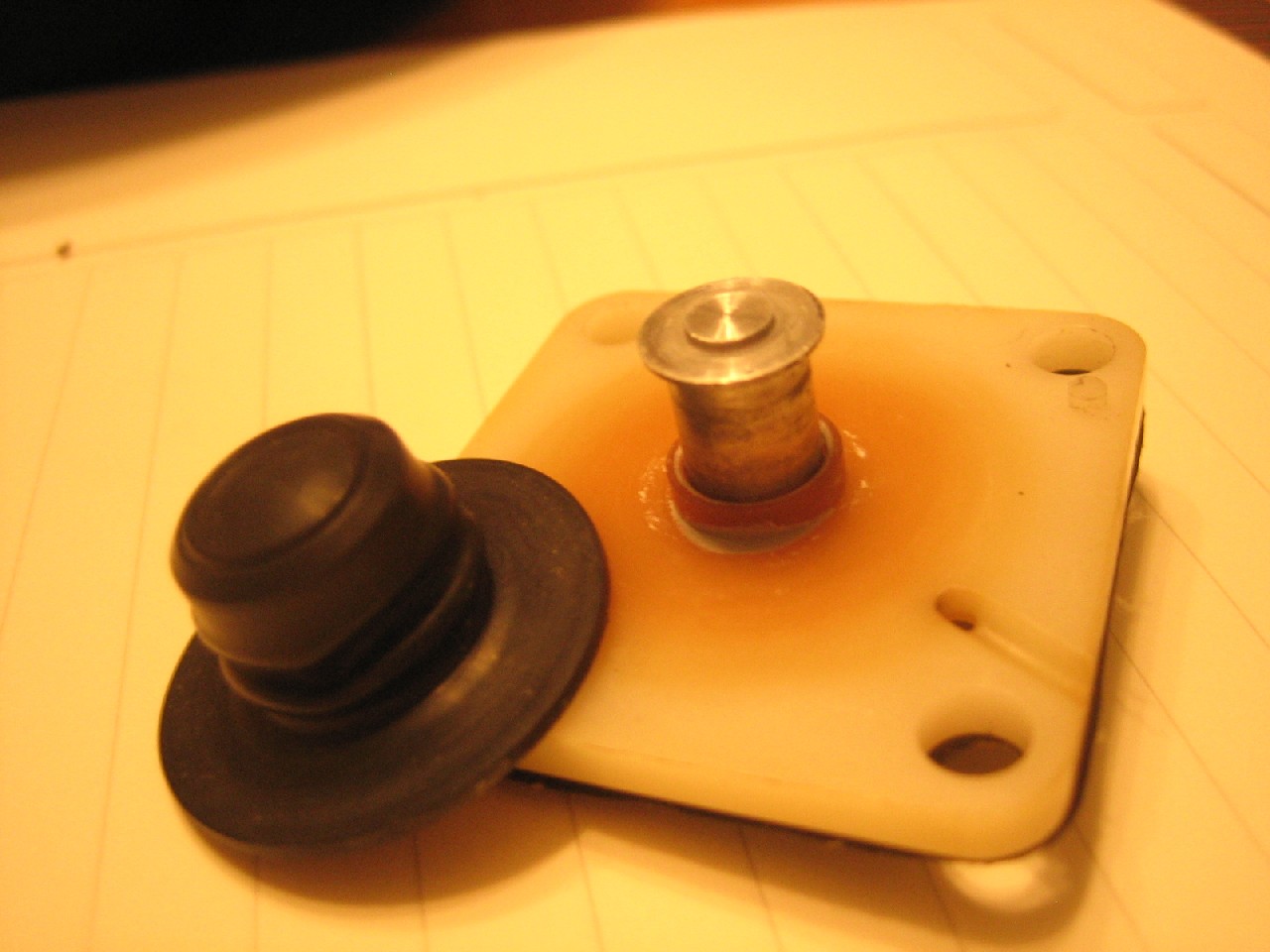

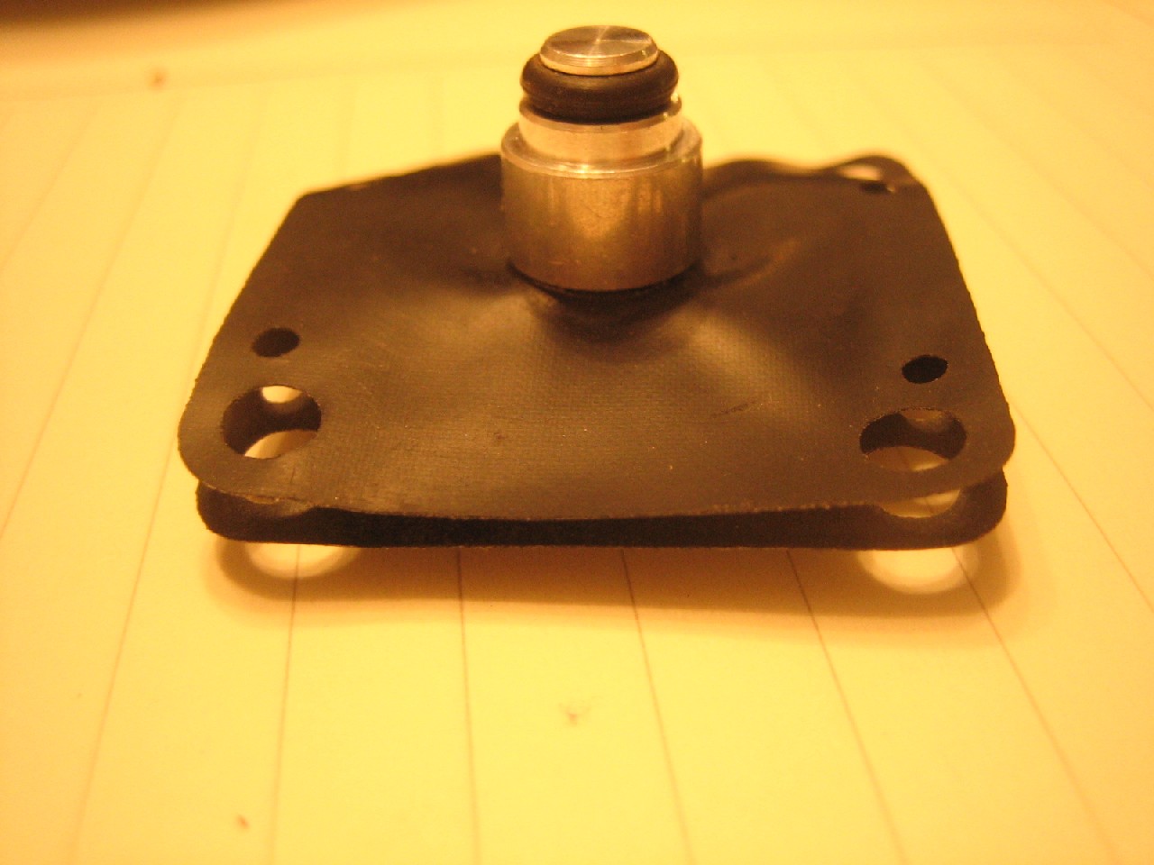

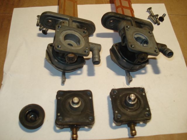

- gd4now
- Denco where did you go?
- Posts: 1686
- Thanks: 680
Re: Normal Cost To Rebuild/Clean Carbs?
27 Mar 2021 19:02
I agree that the pringle is a good item andd does appear to need an o-ring or gasket. Yes just the earlier manual petcock it does need turned off.
I want to make sure that if you are going to rebuild the vacuum one on the bike make sure you get the right parts. There are differences between some of them. See below for some pics of them. If you are going to open it up make sure you get the correct parts to rebuild it as they do not mix correctly.

- Posts: 8114
- Thanks: 3495
27 Mar 2021 19:57
There are tons of variations in OEM petcocks and many, if not post, aftermarket rebuild kits have the wrong parts. If you can get the proper parts, preferably OEM, and the petcock casting isn't corroded, then you have a good chance at success with rebuilding the original. I did just that, with OEM parts, for the petcock on my 750 and it turned out great. I got lucky though because one of the parts inside wasn't available anymore but the original in my petcock was still okay. For the most part it doesn't pay to mess around though.
