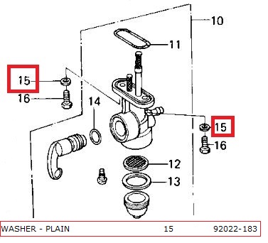

No sealant is needed. Be sure to use the CORRECT washers when installing the petcock. The correct ones are made of nylon so they do not leak. Ed

Thank you 650ed!Are those the washers that are listed in the parts diagram? The only reason I ask is that the washers that are on there now are metal. Thanks!
- Posts: 15339
- Thanks: 2833
Re: 77' KZ650B-1 fuel petcock. Can it be rebuilt?
17 Dec 2020 13:23 - 17 Dec 2020 13:23
I believe they are. The image and link below should help explain. Ed
17 Dec 2020 14:07
Thank you. Wasn't sure if those were the nylon ones. Thanks!!!

If you noticed item 11 in Ed's diagram you will see an o ring that sits between the petcock and your tank.
