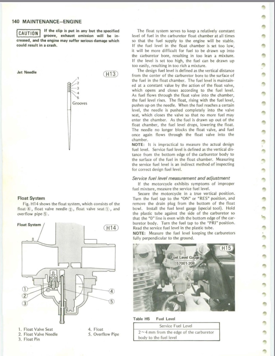

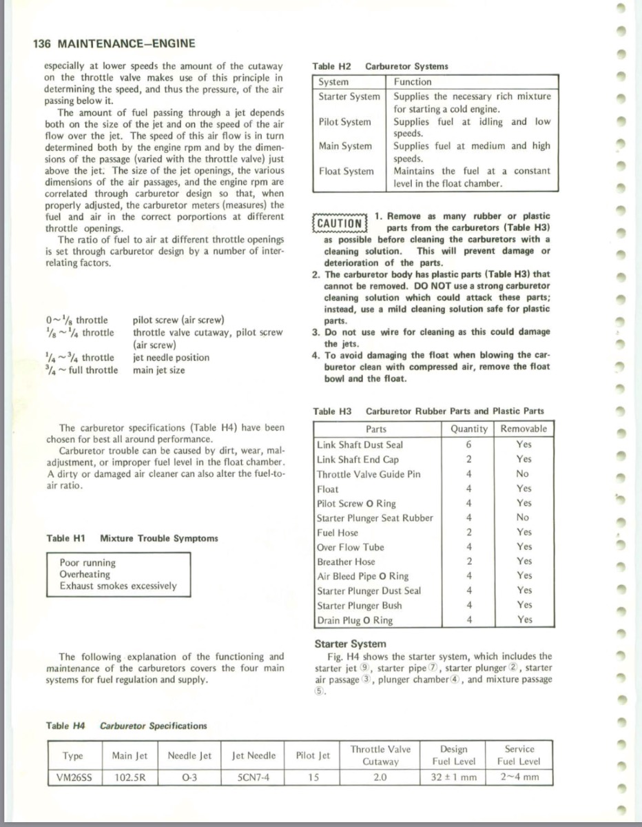

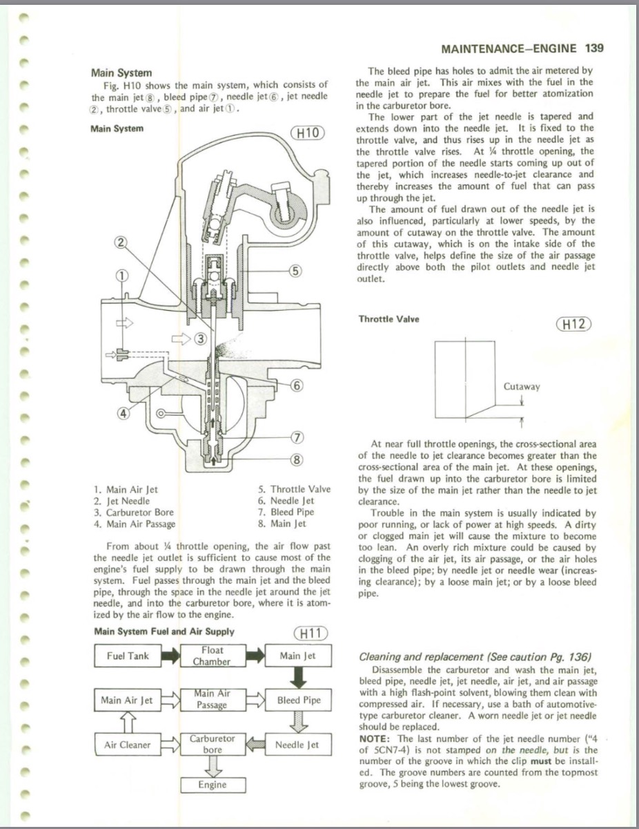

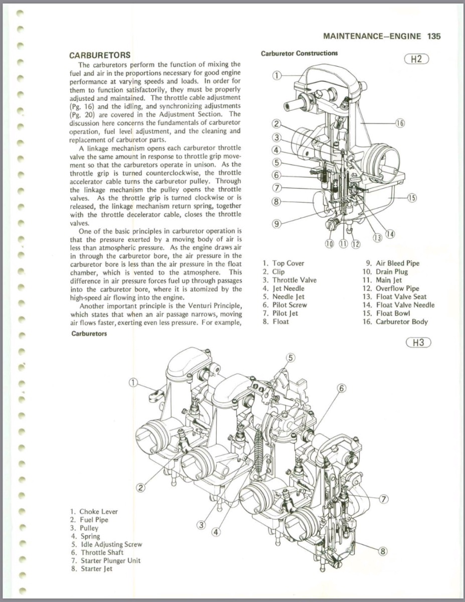

Not sure if you have a manual. Read through these pages from the manual it might help.
Also you need to check all maintenance things. Timing, valve lash, float level, coils, plug wires, make sure you don’t have air leaks at the intake boot ( carb holders) to the head.
