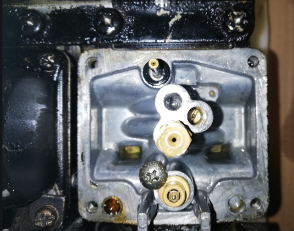

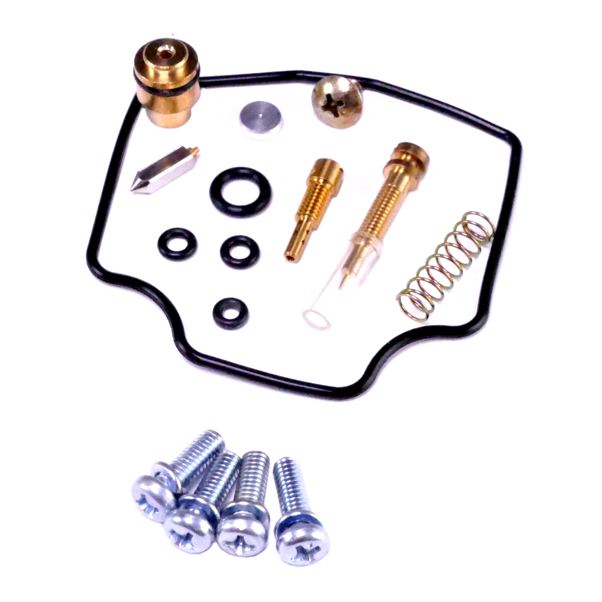

So, i've fu...d up. Not the first time
I 've orderer'd this set:
But, my carbs looks like:
They are supposed to be TK-26.
I'll survive that but the question is will the float seats and needels fit?
The joke is on me.
The joke is on me.
Last edit: 21 Dec 2020 01:08 by vabi.

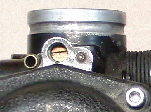

Ok. So far, so good. I have replaced all the provided jets and seals. Also, I have adjusted the float heights. The leaking is gone.
Now I have to tune it. I know how to sinc them but I have a question about the air screw (next to the vacuum chamber).
How to put it in initially. Is there a number of turns I should go back after I screw it all the way in or something like that ?
I did some research and found that 1 and 3/4 back from full would be a good starting point.
Any tips for what to do after rebuild are welcome.

On the Tk26 and Tk27 the adjustment screw is not an air screw, it is a mixture screw. When you turn it out it gets richer. When you turn it in, it gets leaner.
