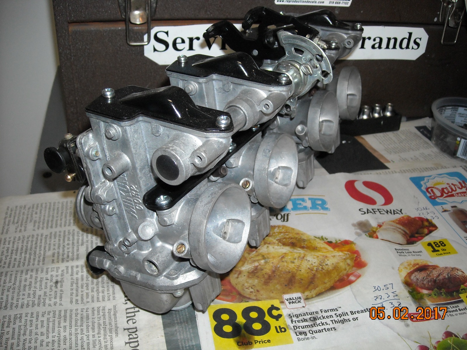

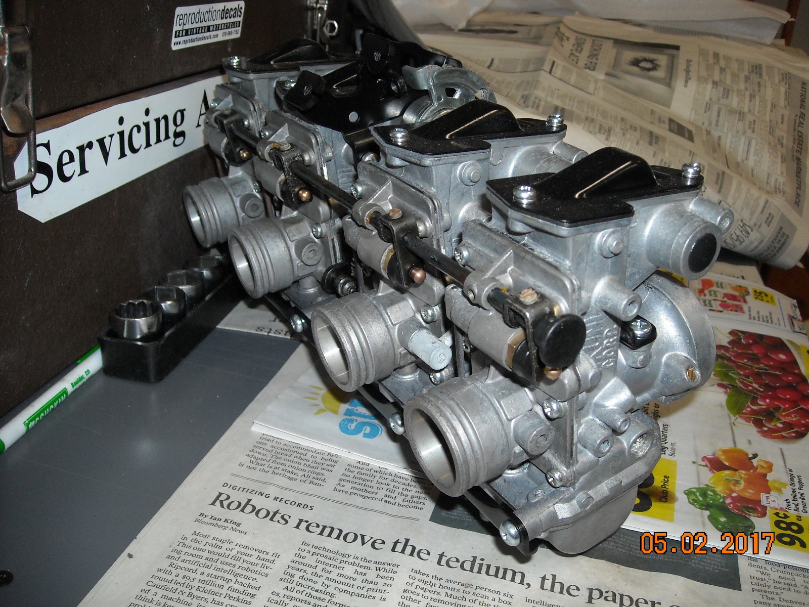

Mikuni manufactured TM Series Flatslides for Kawasaki KZ550/GPz550 models in the mid 1980s. Racer Supply in Van Nuys, CA. which is also where I bought my Suzuki GS1000S fairing from was one place which sold the Flatslides. There are not too many GPz550 running these Flatslides. My 81 GPz550 project came equipped with them, I thought they were cool so I kept them and they work just like Mikuni VM29s & RS34s once sorted and vacuum leak free. So I wanted to share what I know. According to Corey Clough who raced GPz550s, most road racing organizations like AFM, AHRMA, VRRA, do not allow flat slide carbs.
Model:
Mikuni TM27-D1 Push & Pull throttle tube
Ad states Fits 83-85 GPz550 79-82 KZ550
Air Screw Setting: 1/2 - 5/8 CCW turn from seated
Pilot Jet Type: VM28/486
Pilot Jet Size (Sample of two I own) 32.5 or 30 (Sea level); Recommend for altitude ( 5000 Ft) Size 27.5
Main Jet type: N100
Main Jet Size (Sample of Two) 107.5 & 115
Installation:
Need Push & Pull Throttle Tube
1. 1981 GPz550 throttle cables P/N 54012-1041 Open & P/N 54012-1042 Closed are one solution.
2. There are no stock carburetor holder which fit & have vacuum nipples for these Flatslides. I suspect the kit came with custom holders.
3. H1/H2 & ZX550 carburetor holders have the correct ID but have no vacuum connection to synchronize the Flatslides.
4. One Carburetor Holder Solution: Purchase a set of Z-1 Lt & Rt carburetor holder. Break out the digital caliper and your Dremmel tool. Using a circular sanding bit in the Dremmel carefully mill out the ID of the Z-1 carb boots. A slow process of milling and measuring because you cannot add material back. Here is the Dremmel set up.

Now that I got a close up look at these carbs they are very different looking from the VM/TM flat slide carbs used on the GSXR motors.
On the VM29/TM33 the bowls and top caps are slanted (because the GSXR head had downdraft runners) and the throttle rod is on the opposite side of the slide.
Your carbs have the throttle rod on the same side as the RS34 series. Your split line on the bodies is totally different from the other carbs, its on the head side of the carbs, the RS34/VM29/TM33 all have the slit line on the filter side.
Thanks for posting this.
One question, do they use a accelerator pump system?

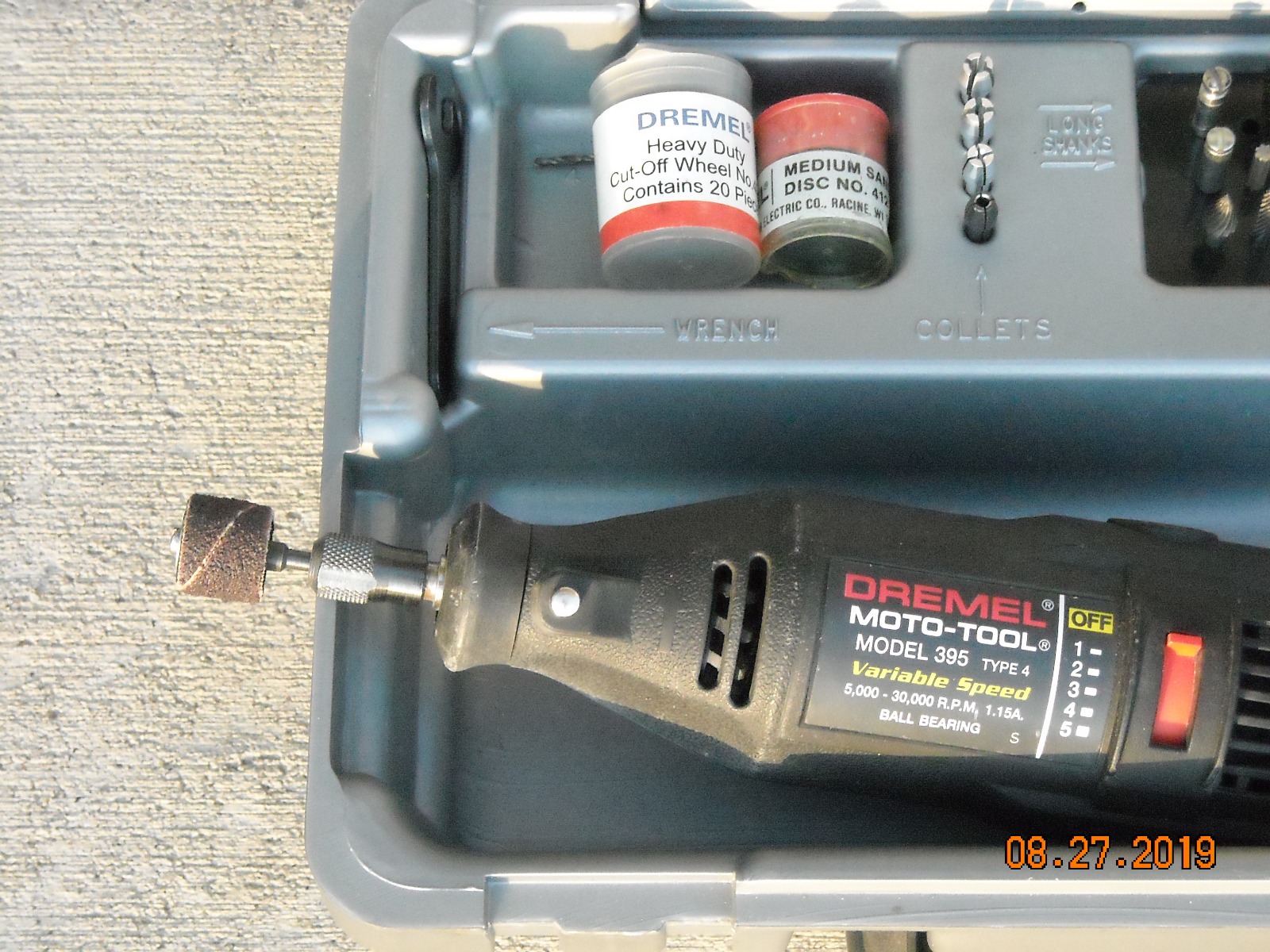

The correct profile of the Z1 carb boot is is a uniform ID which has a slightly tight interference fit with the Flatslides. The bump or ridge is the first thing to be removed. The artsy part is ensuring the ID is uniform as possible. A digital caliper is necessary and is your friend as you slowly remove rubber material. Measure the ID often till you get the hang of it. You are going to remove quite a bit of material from each carb boot before you achieve a slightly tight interference fit between Flatslides and carb boots.
The Dremel worked well set to the 2-3 speed setting.

Ok. Boots are milled out as instructed. I actually found the perfect tool to do it consistently on the drill press. Works out to a "slightly tight interference fit, just a couple hairs smaller than the carb.
Currently waiting for the RTV sealant to cure, I'll give it 24 hours and try to run it again tomorrow.
