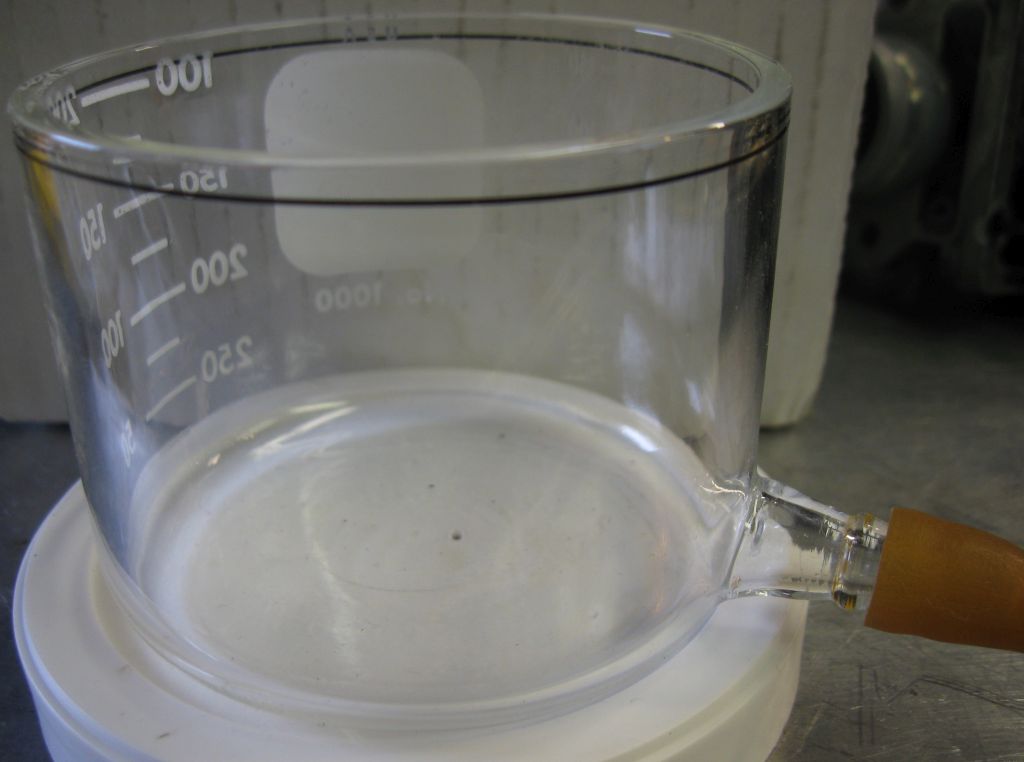

This project has not come to a standstill.
We obtained the lab hydrometer and graduated cylinder needed to test the specific gravity, sometimes also referred to as relative density, of various fuels and other fluids back in mid-2023, and have made significant progress in finding safer alternatives to gasoline when setting float levels in a climate-controlled (heated in winter) indoor / residential basement shop environment.
To date, we've been looking at liquids that match specific gravity & float levels as closely as possible to pure, 100% gasoline. Using 100% gasoline should eliminate whatever variability might occur with 10% ethanol summer & winter blends.
There is a gasoline fuel injector calibration fluid suggested earlier in this thread that is very promising so far, but at $78.00/gal. the stuff isn't cheap. Once we have a repeatable baseline for that, as well as 100% pure gasoline, we'll begin testing distilled water in an attempt to ascertain the exact difference in actual float level.
Over the last 6 months, a local custom lab equipment glassblower has produced a handful of dummy 'float bowls' (modified lab beakers) for our testing based on our ongoing specs & suggestions. Here is the first rough prototype from late last year:
The glassblower has been very interested & cooperative in this project, offering good suggestions as we try different configurations of graduation marks & beaker depths. Different configurations can be produced based on need. We're only testing for Z1 VM28SS carbs.
Every prototype incorporates a drain barb close to the bottom that a 3/8" ~ 5/16" hose can be attached to for convenience & neatness. He also applies a fuel-proof ceramic graduation line 3mm below the top edge of the vessel, prior to kiln firing, for easy visual evaluation of liquid level. We're also evaluating graduation line colors (black & green so far), as well as a solid line all the way around vs. a broken line at 3mm and, a version with staggered broken lines at 3mm and 4mm below the top edge.
We posted a request in the 'WANTED' sub-forum for a set of 4 old carb holders suitable for mounting a rack of Z1 VM28SS carbs to a board to allow for some vertical adjustability, because the prototype glassware varies in height a little. Being able to support & vertically adjust a rack of carbs will ease testing & development of this custom glassware significantly.
Been a fun & educational project so far. Not cheap, but education usually comes with costs. There will be some additional, very detailed, arcane & (maybe) borderline eyes-glaze-over stuff to come, likely in a new thread.

As noted, we engaged the expertise of a custom glassblower that specializes in laboratory glassware to make some glass vessels specifically for setting Z1 3mm float height. Other dimensions and calibrations would be possible.
We desired something more elegant and convenient than the shallow bar-glass prototype with the glass-cutter-etched 3mm line in this OP.
We tested about a half-dozen iterations, wherein they made Pyrex vessels with very thin (0.3mm ~ 0.5mm), ceramic, colored calibration lines permanently fired onto the glass, precisely 3mm from the top edge. We tested solid lines, dashed lines, red, green and black, lines spaced in 1mm increments either side of 3mm. This was not an inexpensive project.
Glass vessels are surprisingly difficult to photograph. We only very recently found some detailed info on doing so without unwanted artifacts. We'll add photos of the different iterations of line colors, spacing & solid vs dashed as we get pics worthy of posting.
As a lark, we asked the glassblower to made a few short, calibrated tubes, similar to the float height tool with calibrated lines that Mama Kaw offered as a special tool in the day. We'll post pics when we get some good ones.
We will also post the final results of our testing of the relative density/specific gravity of the many different liquids considered in our search for convenient & benign fluids for float height setting in an enclosed home basement workshop environment.
We'd also like to take this opportunity to acknowledge member Mikaw for his help with items needed to make an adjustable full-rack stand for testing float height on full racks. We've been remiss in doing so.
If anyone is interested in acquiring custom glassware from the lab glassblower, their info is below.
Custom Glassblowing of Louisville, Inc.
8812 Beulah Church Rd.
Louisville, KY 40291
502/239-2215
jimmy@customglassblowing.com
Custom Glassblowing of Louisville could likely make items of any practical design. For the Z1-specific glassware items as tested:
Ask Jimmy to see quote# Q-00022959.
Part# B-1170-001 - Custom beaker w/hose barb, two solid calibration lines @ 3mm and 4mm below top.
Part# B-1170-002 - Custom beaker w/hose barb, dashed calibration lines @ 3mm and 4mm below top.
Part# T-4400-001 - Custom carb float adjustment tube, vented, 1/4" hose barb, five calibration lines.
(NOTE: the descriptions above are simplified for brevity. The full, detailed descriptions are much longer. Jimmy will know exactly what they are.)
Disclaimer: we are in no way commercially associated, with nor do or will we realize any profit from or compensation for, referrals to Custom Glassblowing of Louisville, Inc. We offer this contact info only for the benefit & convenience of our forum membership based on our development testing & personal experience.
