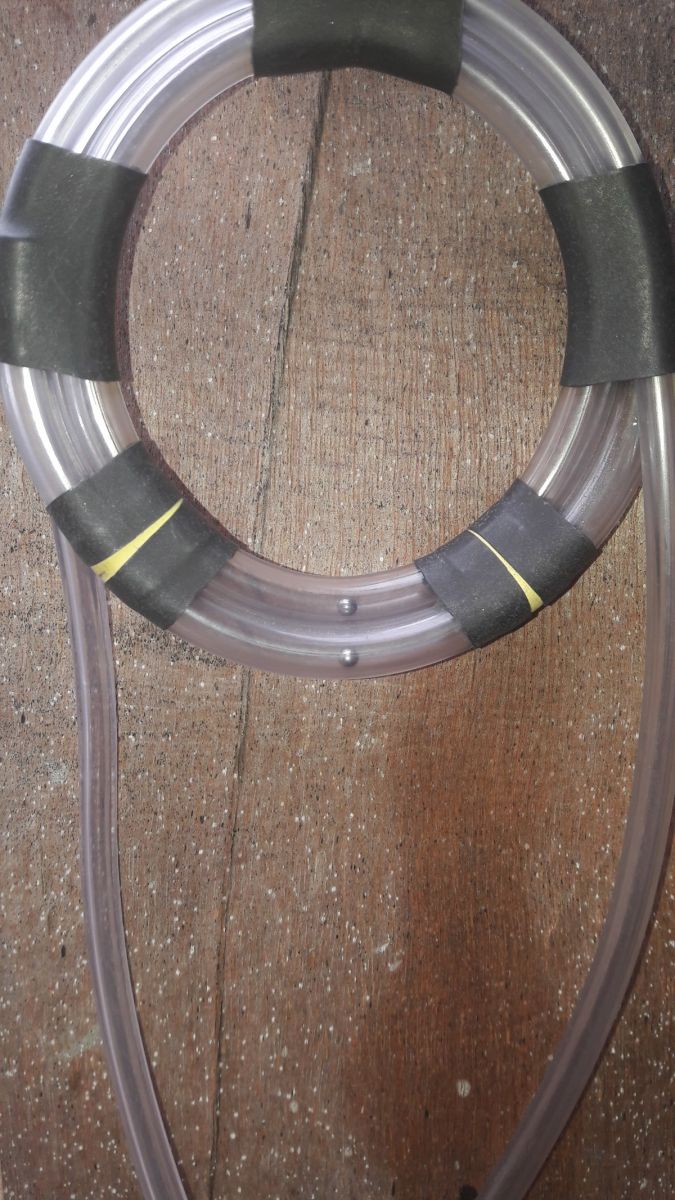

Guys, as I said I only borrowed them out of curiosity to see if they were as accurate as I remember the mercury ones being. They dont appear to be so without some trial and error set up. I moved onto the ball bearing hoop method after my original set died.
If anyone is unaware of this method I will explain with the aid of some pics.
The inner ring is sealed and the ball bearing hangs centrally under gravity and is your datum point. Pic 1
The outer ring is open at both ends. Attach one end to the base setting carb, normally number three. Attach the other end to carb one. Start the engine and adjust the idle to about 1500 /2000 rpm. If carb one is out of balance to carb 3 the outer ring ball bearing will swing to one side or the other depending on wether there is more or less vacuum. Pic 2.
Adjust your slide so that the outer ring ball bearing is back centrally directly under the ball bearing in the inner ring. As in Pic 1.
Do the same for carb 2 & 3 and 4 & 3. Your carbs are now perfectly in sync. Beautifully simple and 100%
Accurate.

Clever setup. Just guessing here but does the ball need to be the same diameter as the hose ID? Otherwise it would not seal and the ball would be bypassed.
A disadvantage is that you don't know the actual pressure.
FYI - I use gauges purchased from Z1E.
The following user(s) said Thank You: Warren3200gt

I like that Warren can you give us the spec, bearing and pipe size and how many loops in the set up,
- Warren3200gt
- Posts: 1767
- Thanks: 943
Re: Carbtune query?
08 Jun 2020 12:06 - 08 Jun 2020 12:26Hardrockminer, the ball bearing needs to be smaller than the tube inner diameter so that it moves freely with bypass otherwise it would just get sucked into the carb. Vacuum bypass doesn't matter as its a sphere the presented face of the ball bearing is always the same area and the vacuum applied to it is always equal regardless of any bypass.hardrockminer wrote: Clever setup. Just guessing here but does the ball need to be the same diameter as the hose ID? Otherwise it would not seal and the ball would be bypassed.
You just need to test as I did Rick using the same carb for each column and comparing the readings. The actual value doesn't really matter they just need to be equal.Rick H. wrote: I use a Carb Tune, but will have to run a comparison against a vacuum gauge to make sure it's accurate. Rick H.
Hi Kev, I can take it apart and measure everything if you like or seach on ebay. I bought mine from the guy that makes them probably in the late 80's but I believe they are still available. Cost about 5 quid back then.kevski wrote: I like that Warren can you give us the spec, bearing and pipe size and how many loops in the set up,
