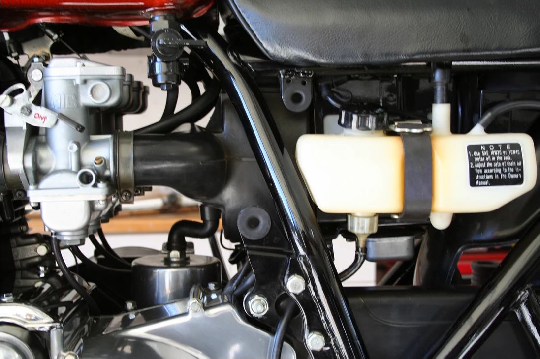

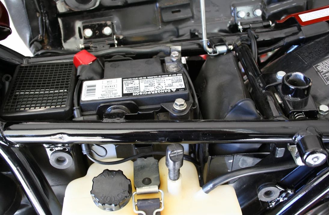

Re: Airbox Z1
11 Apr 2020 04:25
#823069
A Z1 air box will fit with no Problems.

Re: Airbox Z1
11 Apr 2020 12:30
#823108
Great! Thanks for the pix and for the quick response. That was a big help.

Re: Airbox Z1
11 Apr 2020 17:06
#823117
You shouldn't have any problem fitting a Z1 air intake onto a KZ900. I installed one on my 1980 KZ1000 with no issues. But for clarity, I think the photos Scirocco showed are of a Z1, not a KZ900. And an early Z1 at that by the look of the ribless carbs.
