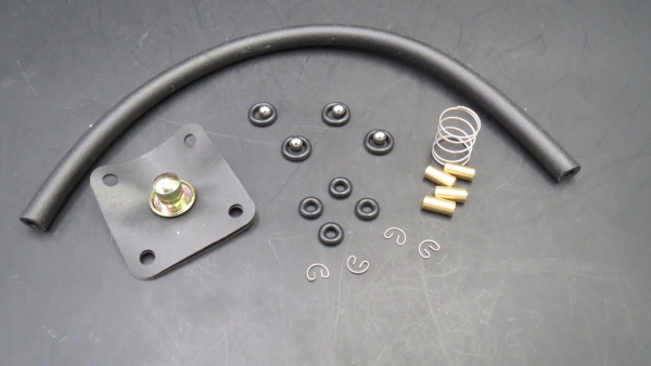

If anyone is in need for an accelerater pump repair kit.
z-fever.de/shop/en/product_info.php?info...chleunigerpumpe.html
