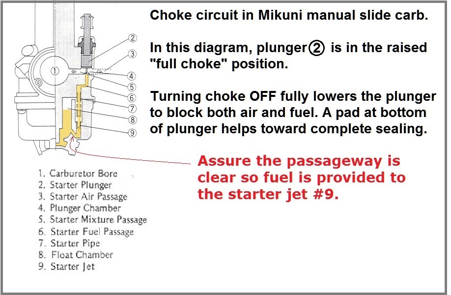

- Posts: 18568
- Thanks: 2103
Re: Hanging idle
18 May 2019 06:55 - 18 May 2019 07:00
When cleaning the carbs, be sure the #6 orifice is clear [see below].
And remember to wear eye protection, because the carb cleaner spray always backfires. ALWAYS.

18 May 2019 08:48WIZZZ wrote: Have you sprayed carb cleaner round the boots when running, see if the revs kick up.
YES. A vacuum leak or torn carb holders will cause a high idle on a carburetor engine. (A fuel injected engine can compensate automatically. ) Also a torn slide boot if so equipped, can cause sluggish throttle response.
Attachment not found
Also if you did not remove some of the jets, then clean the passages thoroughly, it's time to hit the store and pick up a nice sharp screwdriver that will fit the jets. Any plugged jet or passage will result in the engine not running properly. Some passages may be more noticeable than others.
Patton gives good advice, and he is spot on about the carb cleaner finding the correct passage to squirt directly back into your eyes, always . I even use safety glasses and it seems to know how to get past those. That really stings. lol
