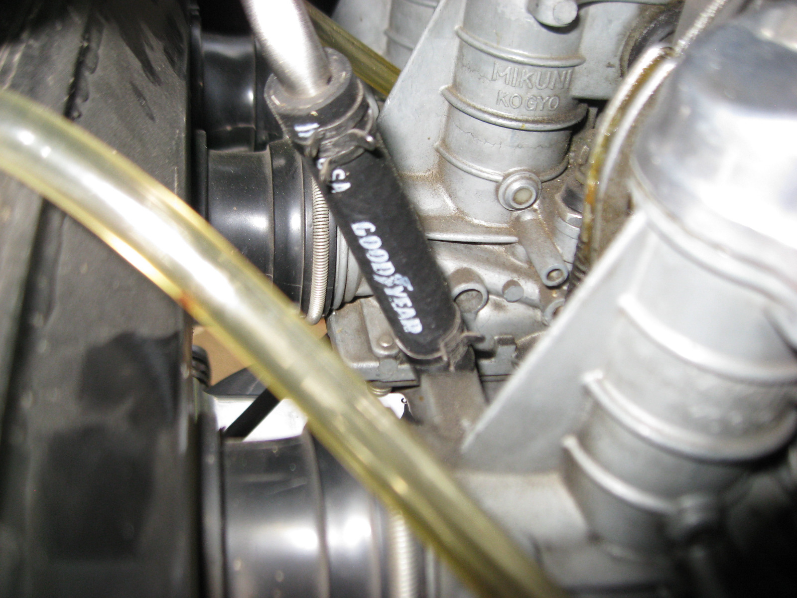

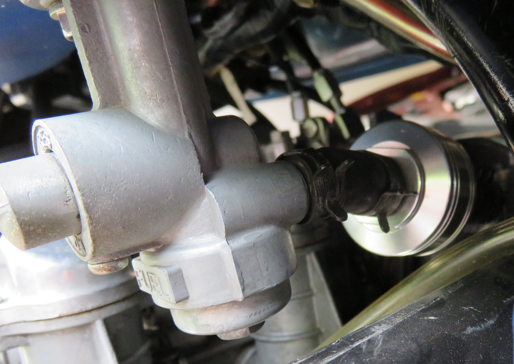

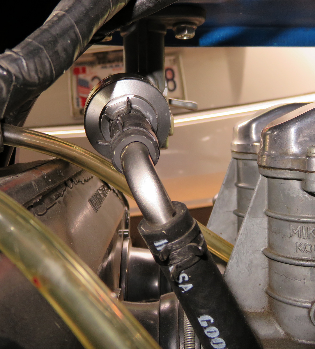

17 Sep 2018 15:42dpivas7 wrote: I will fix the kink in the fuel line, just gotta figure out a good solution because there isn't much space with the inline fuel filter and the petcock being so close to the top of the carbs. ..
Regarding the fuel line kink - see www.kzrider.com/forum/2-engine/609132-in...gine-81-kz650#789676 for details on what I used for routing, fuel filter, etc. The images below show how I routed the fuel line with filter and elbow. Ed
