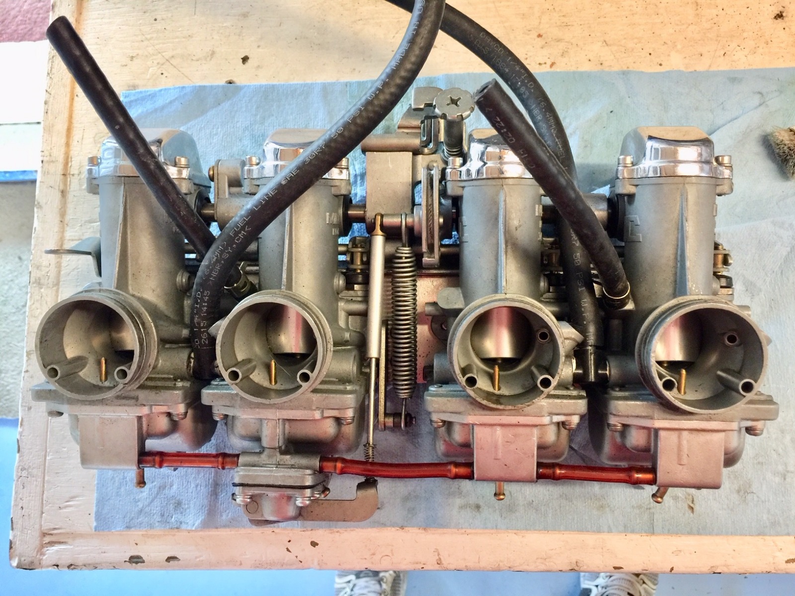

Here is a photo of my VM 28 SS carbs.  Note the bowls are different.  You can see the air equalizer hoses higher up on each side and the dual fuel intake lower down. Also note the accelerator pump on the botton of #2 carb.  Your carbs have the jets on the intake side but not the same bowls.  Perhaps someone changed out the bowls when they removed the pump.
Are those VM26 carburetors? The smooth & tall carb bodies are kind of distinctive.
You can measure them inside the carburetor bore near the throttle slides.
edited to mitigate any confusion. my mistake.

They are 28's.  Rebuilt by WG.

Thanks. My mistake then. I did some more checking & found them right there on WG's site. doh.

I have some info that indicates the ID you posted 113 over 1 are vm28ss carbs, that came stock on  KZ1000 A3 and A4

Mine are VM26 SS and are stamped 108 over 9 and B8 over Y1. I was hoping they were 28's because they look exactly like Hardrockminer's.

The code on mine is 120/2

Both the 108/9 and the 120/2 are vm26ss carbs that appear to have been stock on the 79 and 80 KZ1000 B models.

The '79 model (B3) came stock with VM26SS carbs.  Other models had 28's.  The '80 model (B4) came stock with VM28SS carbs.  All models in '80 had 28's.
I have measured mine.  I'm pretty sure they are 28's.

hardrockminer wrote: Here is a photo of my VM 28 SS carbs.
Hardrock. I just picked up a rack identical to yours. I'm assuming sense you paid WG to rebuild them they are worth it. I'm looking for something better then the stock 26mm on my '781000LTD. Bike has pods, 4 to 1 pipes, and Dyna S. Otherwise all stock
