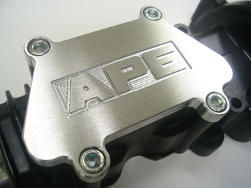

There are several methods of plugging the reed cage caps, some more redneck than others.
Many folks just hook the two together with a short rubber hose.
My KZ has threaded Allen head plugs in the passages.
The covers on my ZRX are plugged with 5/8 aluminum expansion(freeze) plugs.
Some folks run a hose from each cover to a y connector, then a single hose to the crankcase vent, thus creating a slight vacuum in the crankcase, freeing up about 0.0073 horsepower. I suppose you could run that hose to your pants instead of the crankcase vent if it has been a long dry spell for you :whistle:

I love my Pod Filters. I have to remove the carbs when I check valve clearances, in order to loosen the bolts on the cam chain tensioner. If I had the airbox on, it would be a pain. I commute 300 miles a week, so about every 3 months I check clearances. I have never had the airbox on my GPz since owning it back in 2003. The others I have had, never had the airbox either. I have heard nothing but problems from other GPz550 Owners removing and reinstalling their carbs with the stock air box. Might be easier on other bikes??? OK enough.
You can invest an air/fuel tuning set like the one I recommended on the other thread, but "plug chop" is not as accurate.
The reeds only ooperate under vacuum, so i you disconned the hose system, you can leave the reeds in there. I bought a set of Reed Covers from APE, and they look great. You can also look for a Non-California Valve Cover (Canada), and that doesn't have any of this system in it.
