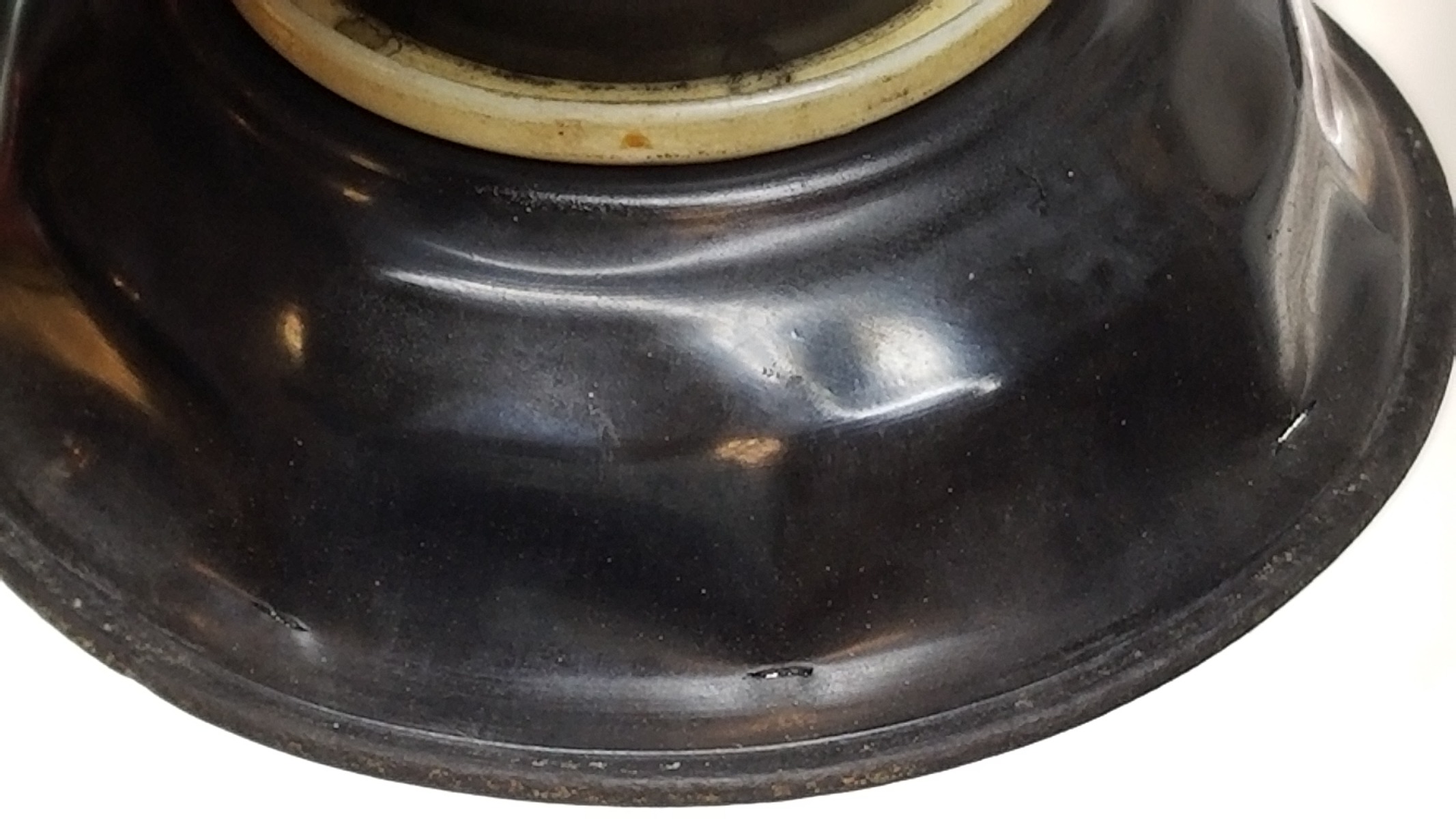

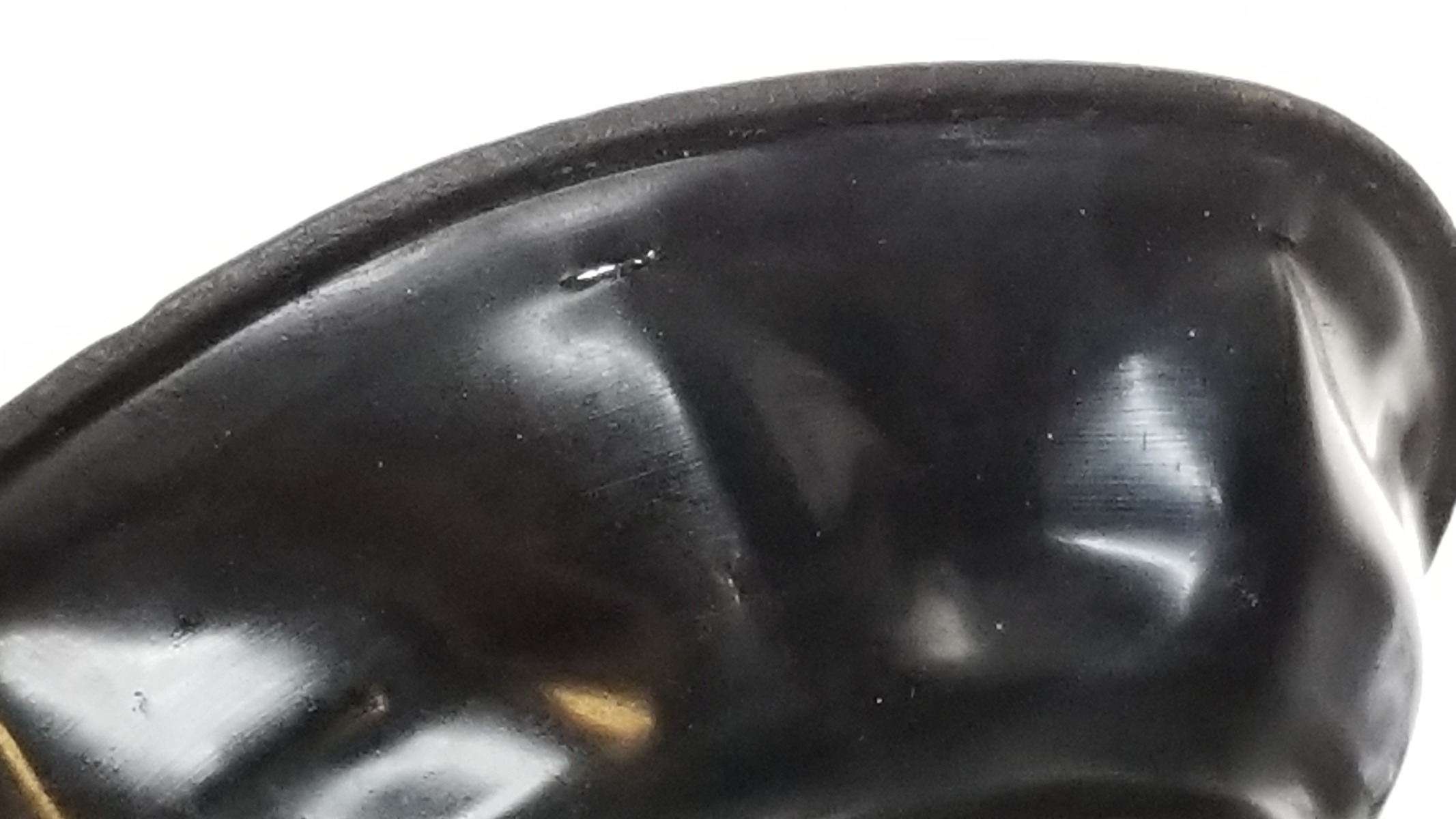

You might want to inspect your diaphragms very closely for pinholes or cracks. That can cause some erratic behavior and will cause rich condition when given throttle.
EDIT: just saw you have to run 80% choke all the time. That might mean the pilot circuits are clogged. Basically it sounds like a total carb teardown.

22 Jul 2018 20:10 - 22 Jul 2018 20:36I don't want to discount the advice by just saying i did that, but with all the issues with this bike I've been anal about being thorough and i saw every single pathway in the carbs yesterday when i did them, including patching 4 holes total in the diaphragms with a gel I've used in the past successfully. I am trying to decide if it is losing spark
