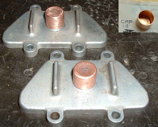

side question: if the reed valves arent capped, could it cause a pop in the exhaust as i lay off the throttle? i could only cap one at the moment, and im hoping thats the cause and not an over lean/rich condition

Yes. You can take a short length of hose and connect the two together. Do you still have the hoses you took off? I have even heard of guys gluing a marble or ball bearing in each hose barb. The cleanest solution is to buy or make block off plates. APE sells them.

On the 550's you can press on a 1/2" copper pipe cap. It's not pretty but is cheap and works ok. Be careful pressing it on. the plates can warp then won't seal. Definitely use a support on the back of the plate when pressing the cap on. Leave the reed cage in the valve cover as it has the integral seal.
Sometimes it might take a bit of heat, so if you have two people it helps.
