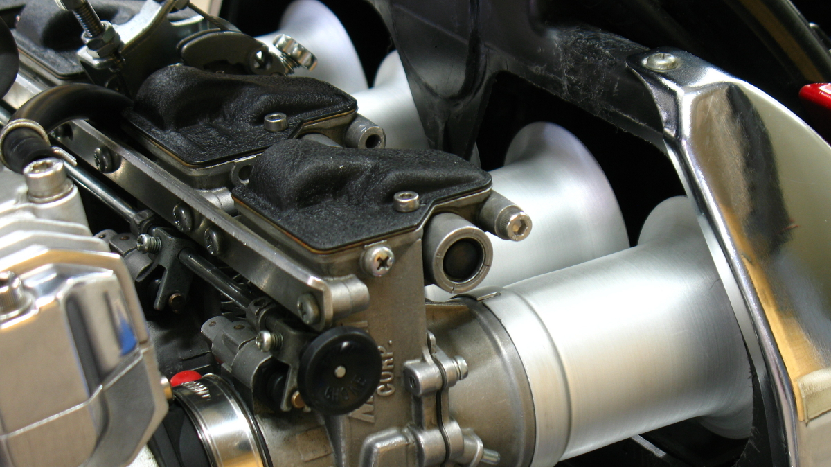

Perry, the hardest part about working on carbs in wrestling the darned things out of the airbox boots. The rest is just a clean and organized work space. Putting a hair dryer on warm in the airbox intake makes it suck a little less as it softens up the boots considerably.
With regard to air box boots, I'm extremely happy with this type:
Sorry guys, looking at old pics is getting me excited about riding!

So my stock air box if i had it looks like yours with the chrome side peices? And does this have the silencer too?

28 Mar 2018 20:54 - 28 Mar 2018 21:09perrykz1000 wrote: So my stock air box if i had it looks like yours with the chrome side peices? And does this have the silencer too?
You talk'n to me...?
Lol
To address your question, I don't think so. My old bike is a 1982 KZ1100A-2, which has the early J-model engine with shaft-drive. This bike came with Mikuni BS34 CV carburetors, similar if not the same as early 80's KZ1000J and KZ1000 Police bikes of the era. The J-engine had something like twenty years riding for police departments around the country, sharing many engine components with the others, which just happens to be great when needing replacement original parts.
Yea, this old bike has been run through several subtle mod modes since I stripped off the Vetter stuff...immediately after I brought her home in 2000. I sensed there was something worth looking at under all that awkward mass of tubes and awkward boxes.
Can't say all bad about the Vetter package though...to each his own. I wouldn't mind having the Windjammer fairing with lowers (matching red), but that's it.
Perry, your bike is an earlier and entirely different animal (beast). I know little about that vintage, but it's ok because there are lots of very smart rookies prowling this site.
