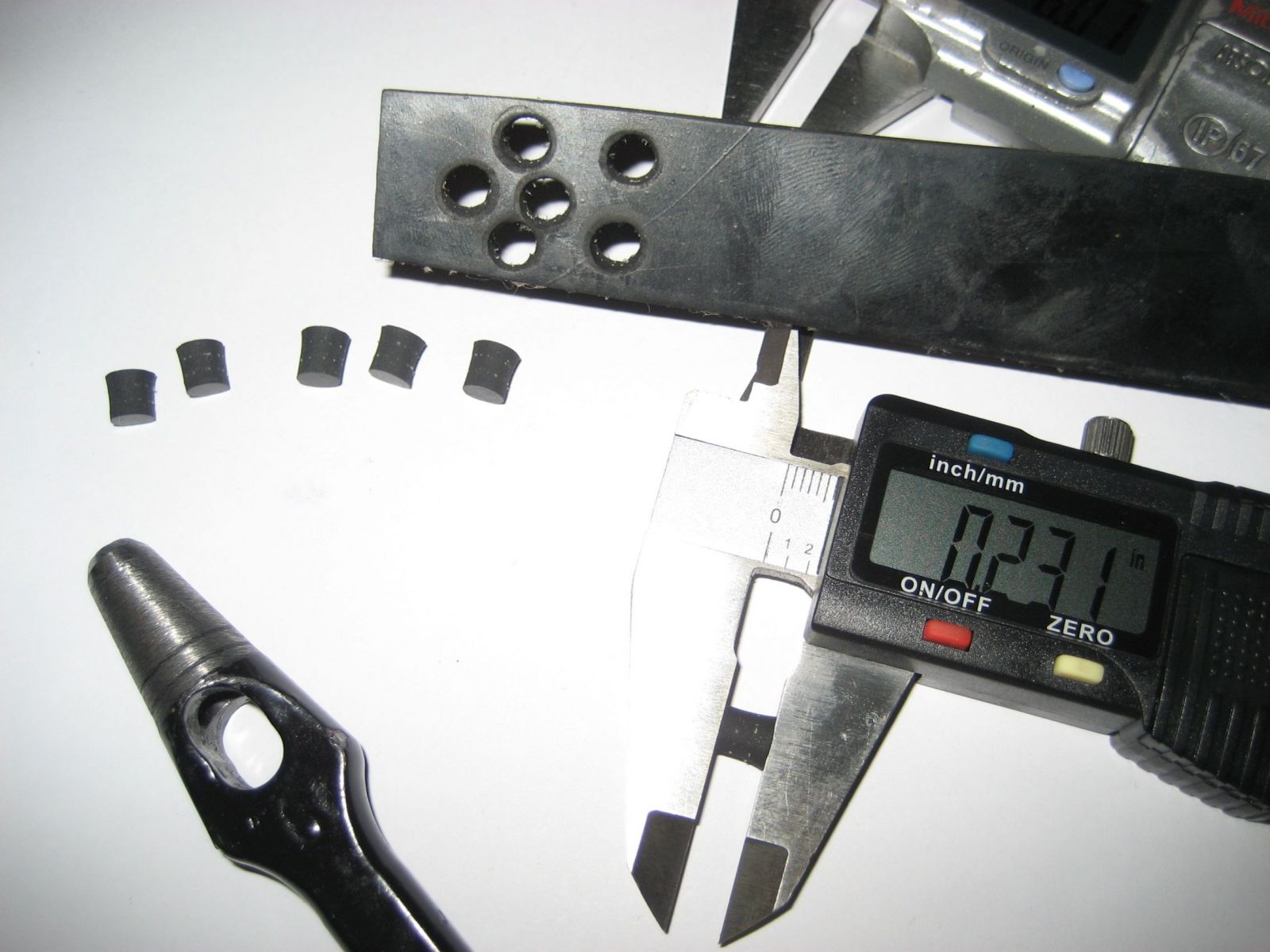

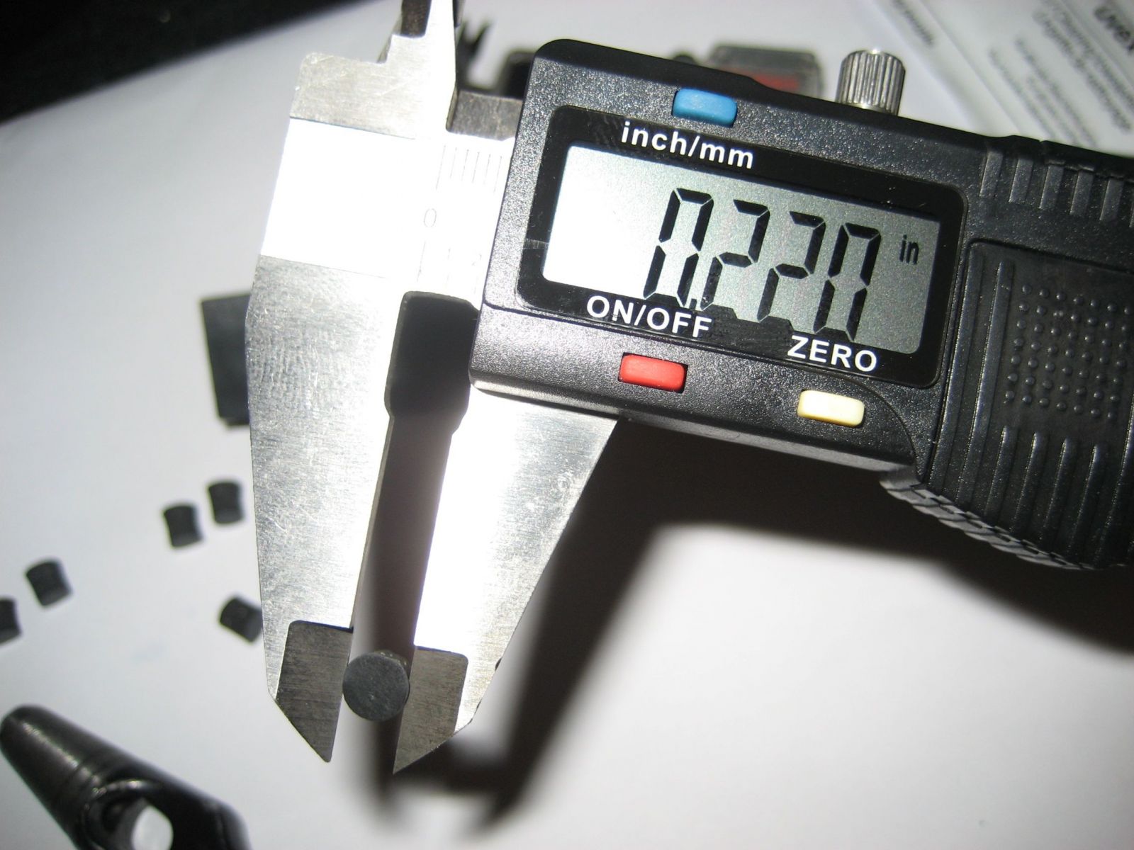

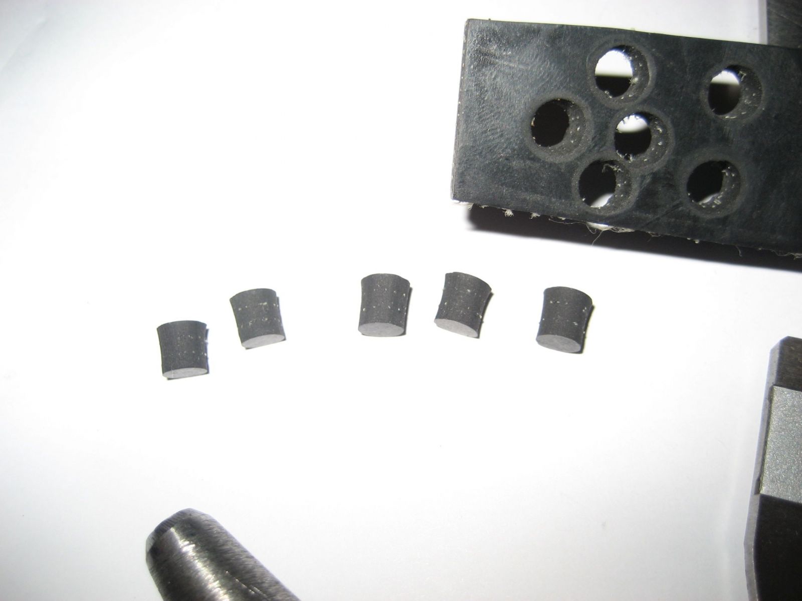

Made some plugs out of an rubber mat (thickness 6,00 mm = 0,236 inch) with an 6,00 mm hole puncher.
In my opinion it is looking good for the first try. Plugs are a little conical formed out as you need.
Need only one minute of work with the right piece of rubber.
Michael
Michael

Based on the measurements the plugs listed earlier should work.
