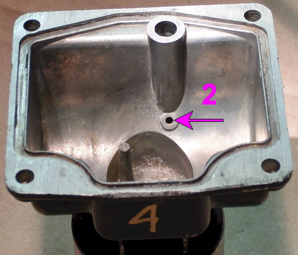

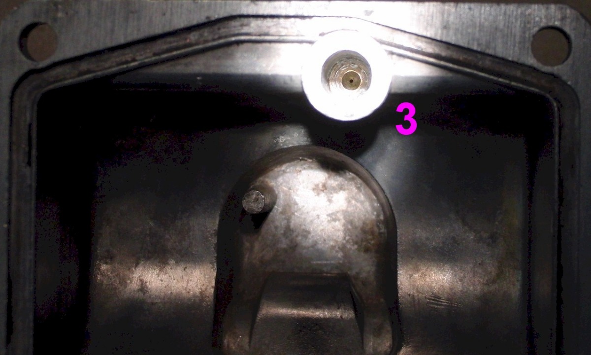

These photos are from a Tk26 carb, but I think yuor Tk27 carbs are very similar.
Since the pilots were so gunked up, it may be likely the enricher circuit is gunked up too. The jet for the enricher is in the bowl, so it tends to collect dirt. The passage marked "2" feeds fuel to the jet marked "3".

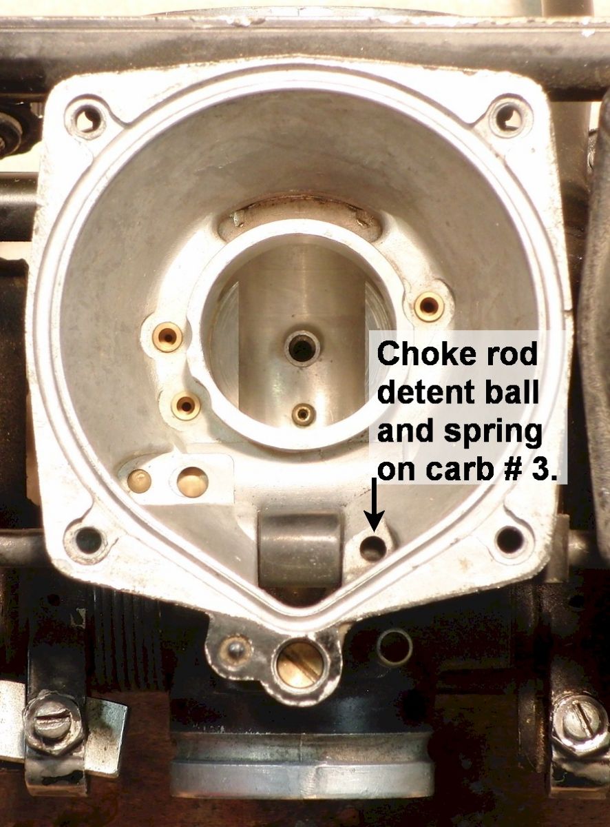

Also, if you remove the choke rod, there is a tiny ball bearing inside the top of carb #3 that will pop out. Make sure you have the top of carb #3 removed and the slide diaphragm removed so you can catch the ball.

Thank you for the extra info, I really appreciate it. I will check the enrichening circuit!

loudhvx - good call on the enrichening circuit. All 4 were completely blocked. I was able to clear them with carb cleaner, my guitar string and shop air. Thanks so much for volunteering that info, you likely saved me hours of headaches!
