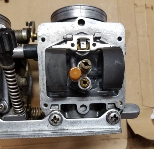

Attached are photos of plugs and the pod filters. Oil and gas are fine. Not too sure on how to check valve lash or ignition advance unit. The jets appear to be stock.

Those particular filters are junk. I recommend K&Ns or UNIs.
There is a rubber ring inside those filters. That ring blocks the air ports in the ventri of the carb.
That will throw off the air to fuel ratio, especially on a constant velocity type carb.
What do you mean by 'The jets appear to be stock'?
What are the numbers on them?
Who ever worked on that frame needs to take it easy.
Way to much metal removed.

Alright, got the carbs apart again this morning. Main Jet appears to be an 88, 2ndary a 65, and the pilot under the plug a 58. I also see now exactly what you mean about these pod filters blocking those air ports. I think these would be a good replacement?

01 Oct 2017 17:20Jpope85 wrote: Alright, got the carbs apart again this morning. Main Jet appears to be an 88, 2ndary a 65, and the pilot under the plug a 58. I also see now exactly what you mean about these pod filters blocking those air ports. I think these would be a good replacement?
shop.unifilter.com/p/pod-kit-2-pack-i-d-...-lg-3%E2%80%9D?pp=24
Also found the FSM on the web and downloaded it.
Those filters will work.
The FSM has lots of good info. Clymers and Haynes are good also.
The U.S. versions had sealed idle mixture screws. You will need to look up the European version for specs.
