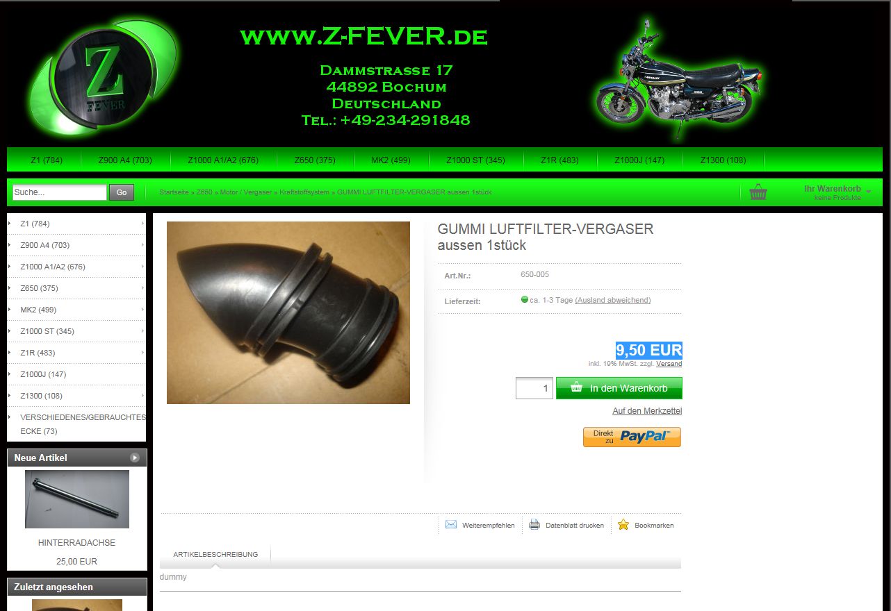

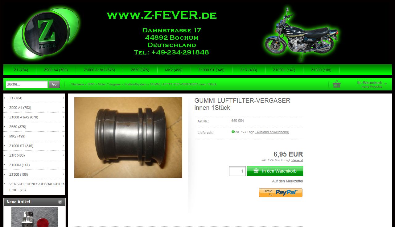

Air box to carb boots.
outer boots, 9,50 EUR
z-fever.de/shop/product_info.php?info=p8...-aussen-1stueck.html
inner boots, 6,95 EUR
z-fever.de/shop/product_info.php?info=p8...r-innen-1stueck.html

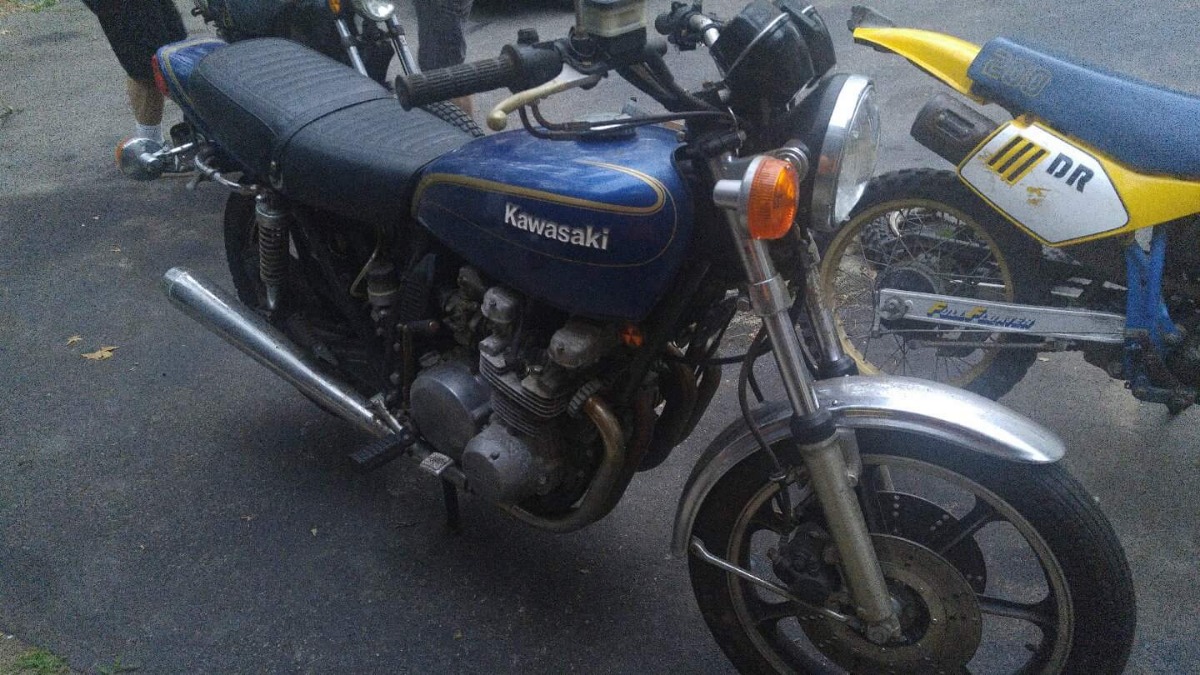

Scirocco thank you for the links, I can't believe how cheap those boots are, though the shipping will have me reeling in pain haha Thanks again to all who commented on this thread, this was the best 250 bucks I've ever spent. Here's a pic of her the day I picked her up
