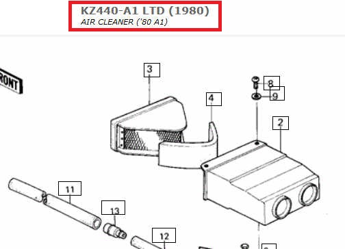

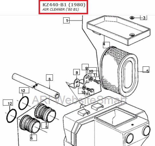

IMO you are wasting time fiddling with it any further until you install the stock air filter in the air box. Home made stuff is not the same. After the stock filter is installed you can much more easily identify the problem IF a problem still exists. Ed

Note: treat the airbox with care, especially the cap. Don't overtighten the screws or force anything. Also, on at least one of the airboxes, it's possible to install the cap wrong. If not done properly, this causes a vacuum leak. The test is to pull up gently on the back of the cap. it shouldn't move. (info from Andy-the-gringo).
