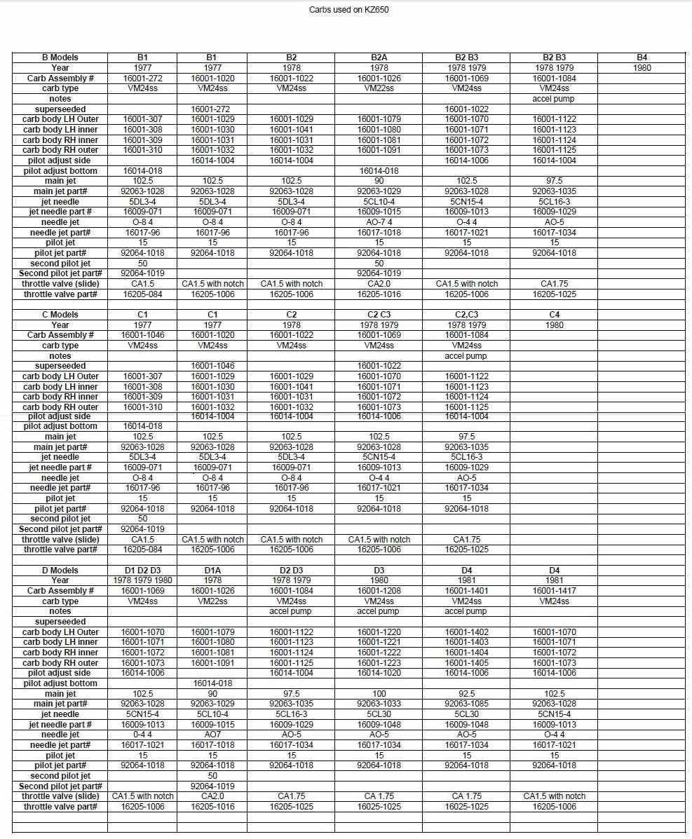

To put a nice little cap on all these events. The whole reason I originally took the carbs off before this needle issue was due to the carbs running way to rich and just having awful idle. Now with 102 and 15 it seems happy! Until I touch the throttle then it stalls due to not nearly enough fuel. So. With that I will order an airbox for it. For those who were interested the sizes I had in before were 112.5 and 15. They are all in VM22 carbs. For the first time though the bike seemed to idle right, No bad sounds from any cyclinders being flooded or what sounded like certain cylinders not having correct amounts of gas and attempting to bog down. I was actually surprised how pleasent the bike sounded when it was not trying to idle at 4k rpm then stall.

Here's a chart that shows carb specs (jetting, etc.) that you may find useful. It includes VM22 specs. Ed
