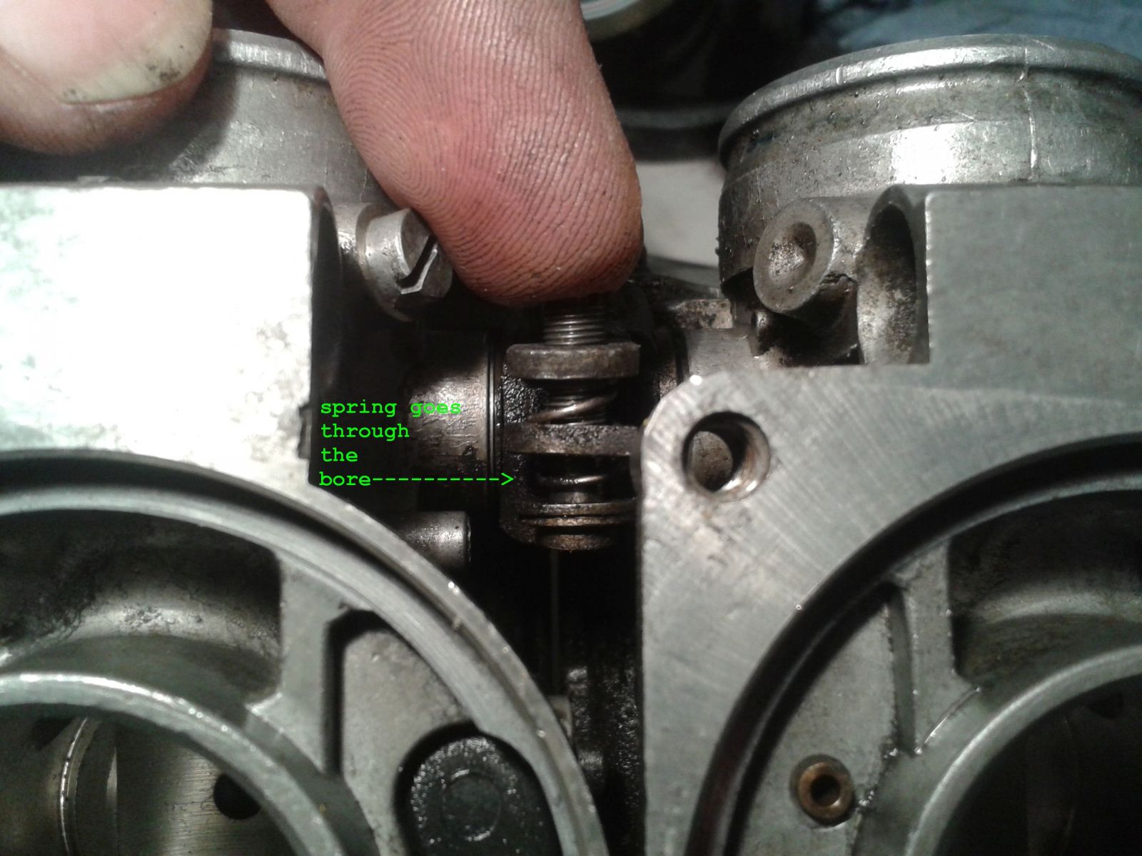

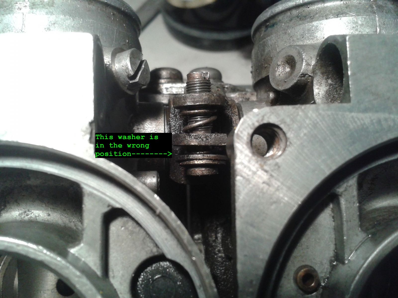

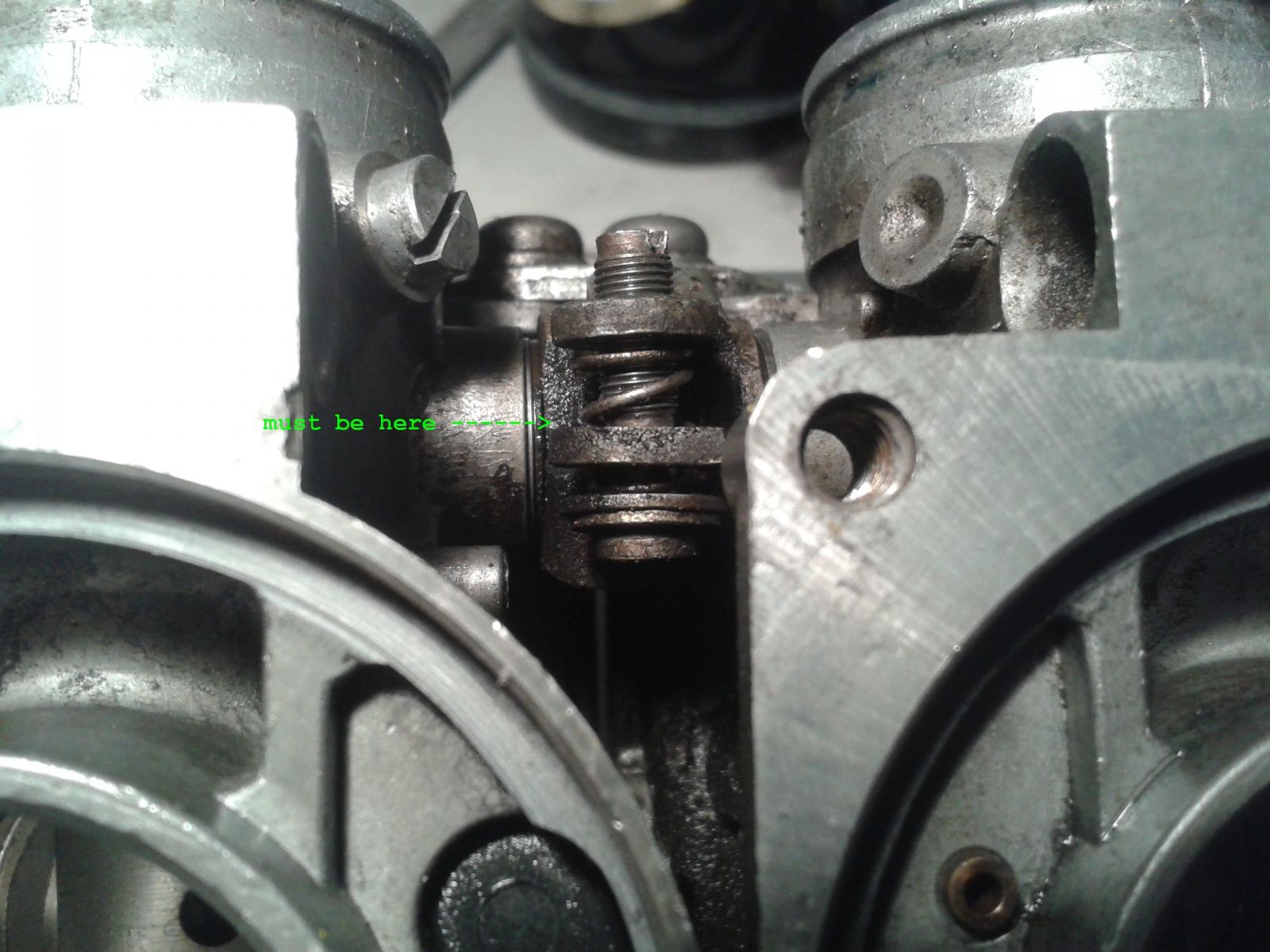

This remembers me on my last carb sync issues on a Honda RC08.
PO or someone else try to rebuild the carbs and reassemble one the sync mechanism screws wrong.
here a little video i have done
maybe it solves your sync issue
Michael

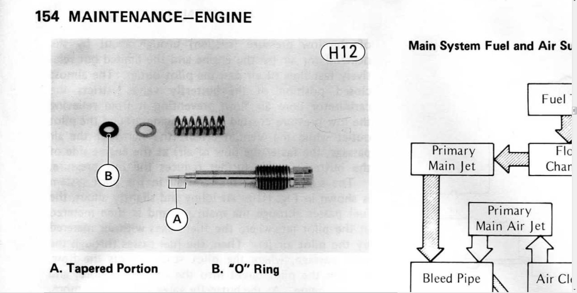

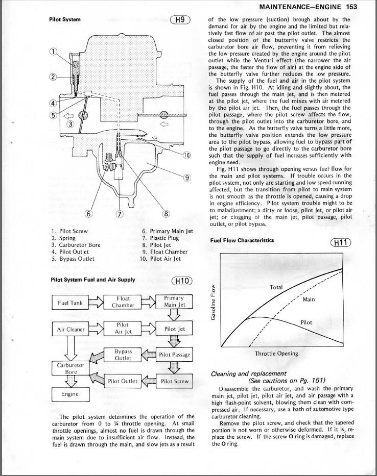

Before i can get back to balancing i HAVE to figure out something with these air screws. They are so far off the bike won't even rev past 4k. I set them all at 2.5 turns, thought that was stock settings for these? They were 3-1/4 out on a few of them before i rebuilt the carbs and that wasn't right either. After the engine got warm it would idle very high, still did after the rebuild...... but when i set the pilot screws at 2.5 it all went to hell now its not kicking the right side carbs on until at least 3k when it burbs into life and its bogged down and stalls off throttle. Uhg..... any advice for setting those screws back close to where i can begin tweaking them? I'm decent with a single carb bike, but it's intimidating me doing these carbs. The bike hasnt needed major carb service in the year plus i have owned it until now. I'm usually on my Vulcan 750, which i find tuning easy on the v-carbs.

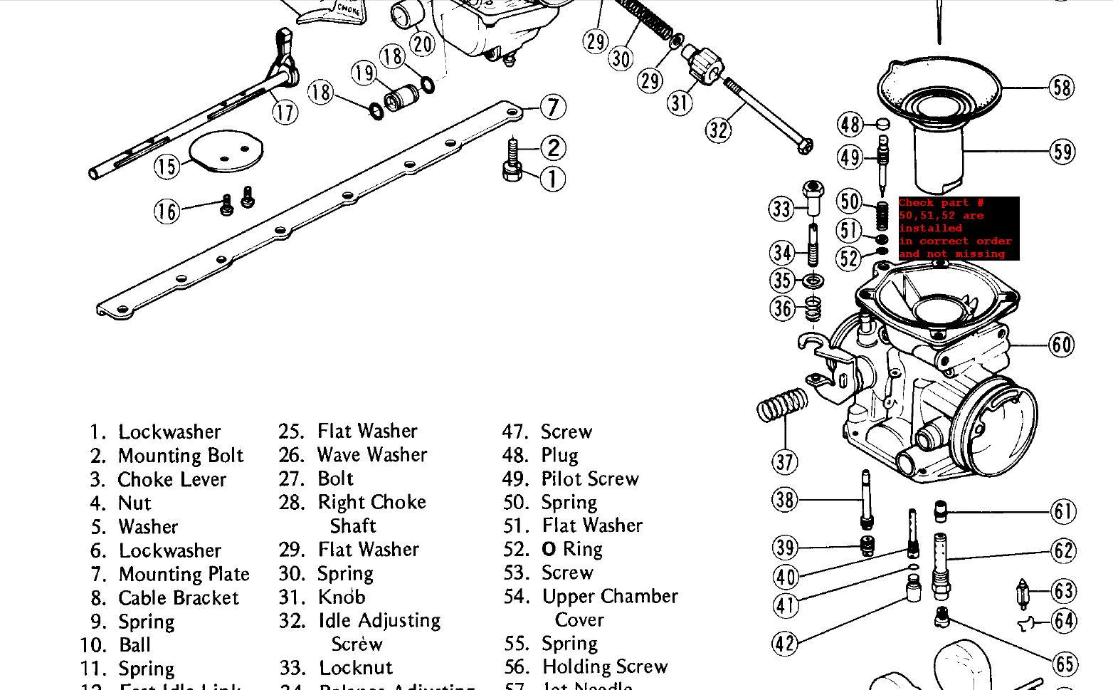

Hello One1
Before you go deeper to tune your turns of the pilot screws, check that all parts
under the pilot screws are in place and in the right order and nothing is missing.
Check all pilot screws needle tips are in good shape and not bend or one broken of.
Michael
Michael

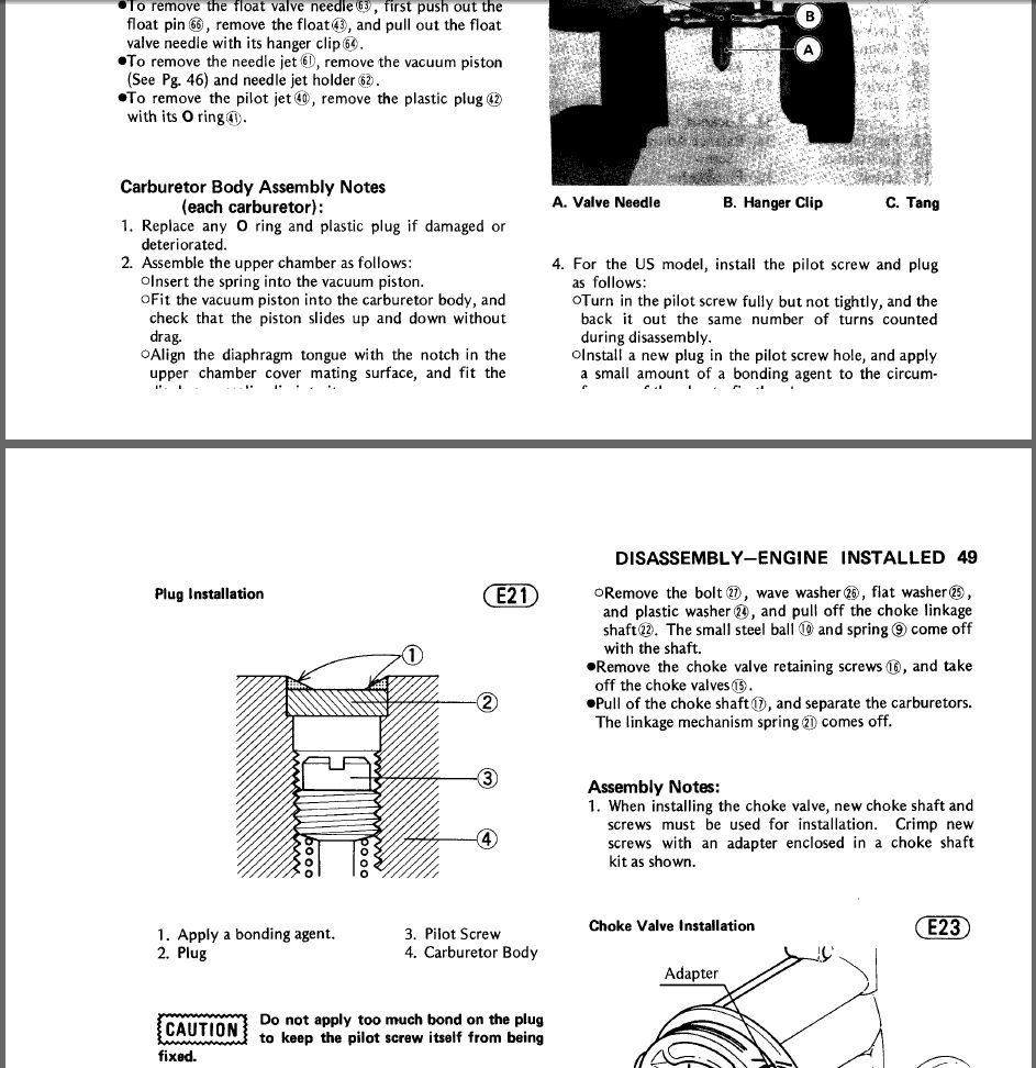

Thank you! I've been smoking it over and i think the plug has fallen out of that pilot in the float bowl. I remember one being looser than the rest and I've got a suspicion its not in place anymore. I'll find out tonight.
