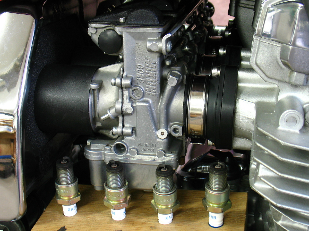

This thread discussion drove me off my butt to actually do what I had contemplated for a very-long time...thank you all!
Velocity stacks offered a permanent solution for my application.
Regarding the clamps, I really like this one:
www.normaamericasds.com/sites/default/fi...ct_pdfs/ABA_Safe.pdf

22 Mar 2017 07:19daveo wrote: This thread discussion drove me off my butt to actually do what I had contemplated for a very-long time...thank you all!
Swapped the clamps...
These SS clamps shame those that require a phillips-type head screwdriver. They easily tighten beyond the point where the others become distorted and useless :evil: ...without damaging the rubber!
1982 KZ1100-A2

22 Mar 2017 19:15undiablo wrote: Daveo,
You are running Mikunis RS34 with some modified air box?
Yep...
The stock air box was widened to accommodate Mikuni KRS velocity stacks, and the interior structures restricting air-flow were removed. These alterations were made while preserving the stock appearance, and the functional advantages of the original crankcase ventilation system.
