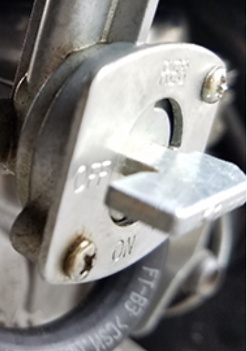

GasMoney wrote: First off, '82 KZ440 ltd, the engine dies within seconds of having the petcock on the ON position. Second, it runs just fine on RESERVE position....
If this is still an issue, can test for fuel coming from the petcock's different positions by loosening a carb drain screw and watching for drainage of any incoming fuel in each petcock position.

29 Aug 2016 07:32Seems like it would be easy enough to partially disassemble the petcock and assure that the internal gasket or whatever is correctly fitted to allow fuel flow in RES and ON and to disallow fuel flow when OFF.
